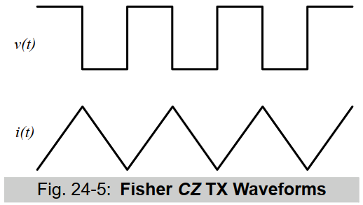

    CZ TX waveform:
    Click image for larger version  Name:	image.png Views:	0 Size:	21.2 KB ID:	434773​
    IMO, the CZ is a primitive MF design in that a basic square wave drives the coil and the RX uses the 3rd harmonic to notch out salt water. Other than that, the harmonic really isn't used so the CZ otherwise behaves like a 5kHz single frequency detector. Both Minelab BBS and White's DFX were big steps forward in that they boosted the high frequency and then used both frequencies for target & ground analysis, not just salt notching. Newer MF designs do even more analysis, often with 3 frequencies.
    BTW, CZ tech isn't dead, Minelab used it in the X-Terra Pro. The XT-pro is called a SF detector but it can notch salt, in exactly the same way as the CZ.

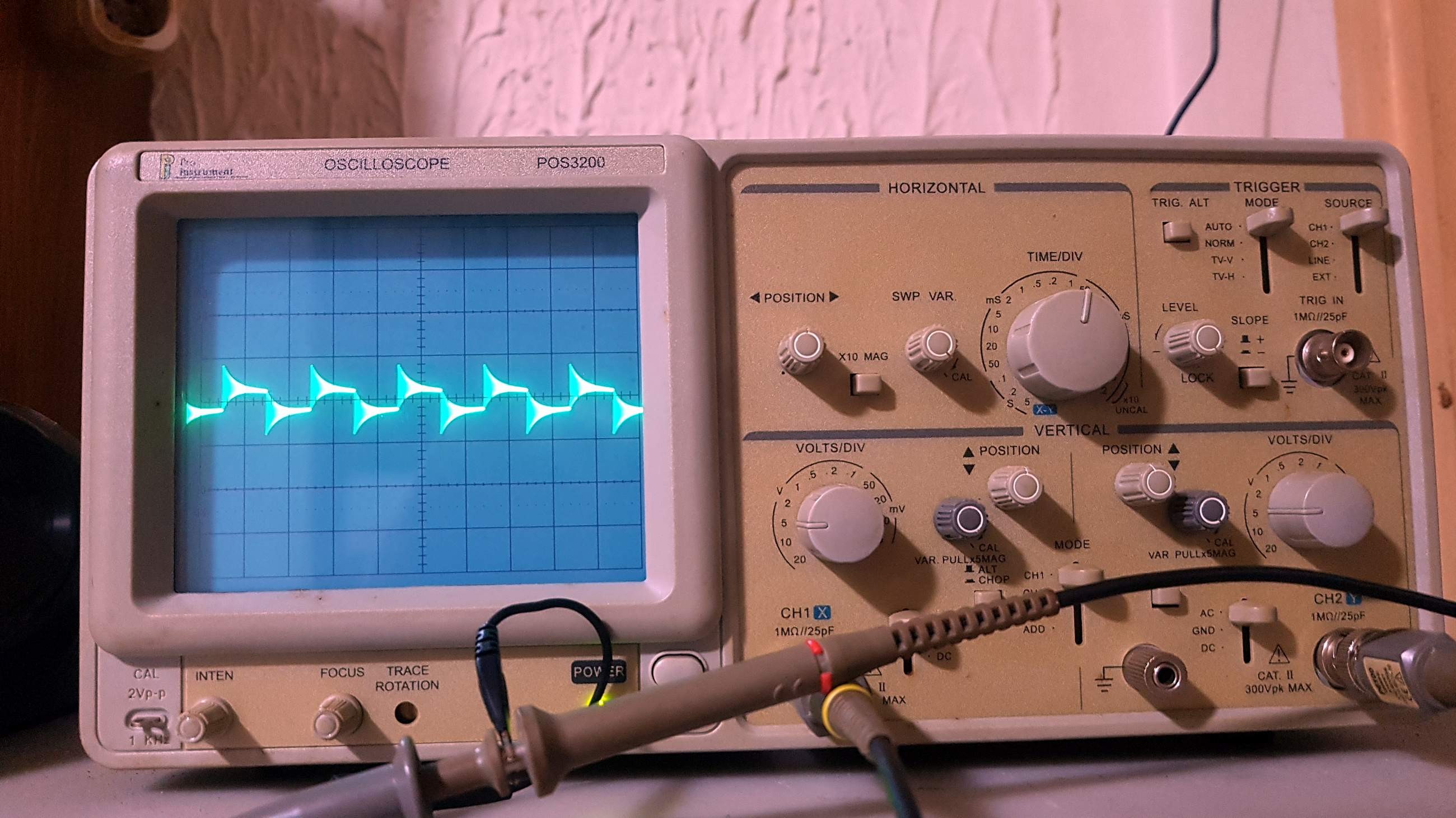

      Ok... I quickly recorded a waveform with the CZ6.
      Click image for larger version  Name:	20250304_014515.jpg Views:	0 Size:	545.6 KB ID:	434780Click image for larger version  Name:	20250304_014519.jpg Views:	0 Size:	993.6 KB ID:	434781
      Click image for larger version  Name:	20250304_014544.jpg Views:	0 Size:	391.9 KB ID:	434782Click image for larger version  Name:	20250304_014547.jpg Views:	0 Size:	829.2 KB ID:	434783
      Click image for larger version  Name:	20250304_014557.jpg Views:	0 Size:	657.3 KB ID:	434784Click image for larger version  Name:	20250304_014600.jpg Views:	0 Size:	548.4 KB ID:	434785​​​​​​
          You need to add a damping resistor.​

                    How much will the waveform change when I put a damper resistor?
                    It will get rid of all the ringing and you will see a nice clean square wave, like this:

                    • #85
                      Click image for larger version  Name:	image.png Views:	0 Size:	7.4 KB ID:	434807​
                      First case; I used damping jig with minimal resistance = 198R.
                      Second case; I used fixed resistor = 56R.
                      I guess the real damping value is somewhere between 56 and 198 ohms.
                      Click image for larger version  Name:	20250304_211947.jpg Views:	0 Size:	438.8 KB ID:	434827Click image for larger version  Name:	20250304_212545.jpg Views:	0 Size:	429.6 KB ID:	434828

                                Carl, I have an interesting question.
                                Now when I look at those two oscillograms again, I think that a perfect square will not be obtained even if I change the damping value between 56-198 ohms.
                                The tendency is clearly visible, the rising slope is always above the falling one.
                                It cannot be "ironed". I have two assumptions:
                                - The problem is with the "sensor" and the coupling,
                                - The problem is with the "lower" capacitor in the TX, the device is quite old, it is possible that the capacity has decreased, so there is no symmetry.
                                Opinion?
