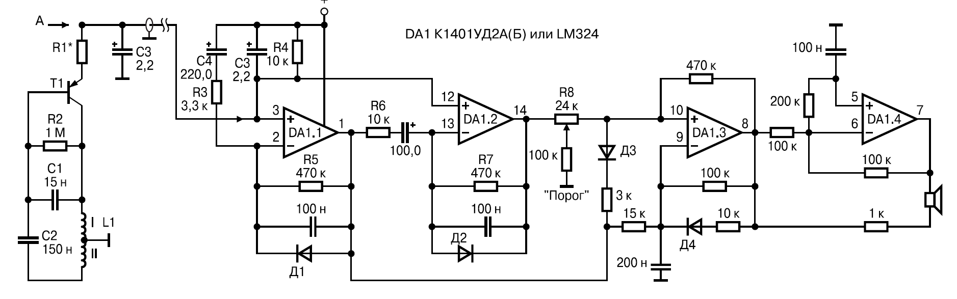

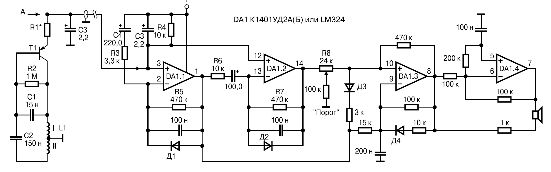

    ​Circuit design is here:
    Click image for larger version  Name:	DeepSeek QMD.png Views:	0 Size:	75.0 KB ID:	439229
    ​The core Q-sensing element is an oscillator circuit built around transistor VT1, following a classic design. The circuit operates in a unique mode, highly sensitive to the quality factor (Q) of the oscillating circuit, achieved by adjusting feedback depth via resistor R1. The Q-factor depends on the surrounding environment of the coil. The oscillator’s excitation level determines the DC voltage at point "A".

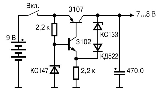

    Power Supply
    Stabilized source is mandatory. Voltage regulator design is here:

    Analysis of the Circuit and Practical Recommendations
    1. General Observations
    • IC: The circuit uses DA1 (K1401YJ2A or LM324) — a low-power quad operational amplifier (op-amp), suitable for amplifiers, comparators, and oscillators.
    • Components: The schematic includes resistors, capacitors, an inductor coil (L1), and transistors (T1, T3).
    2. Key Nodes and Possible Functions
    1. LC Tank Circuit (L1, C1–C3)
      • L1 + C1–C3: Form an oscillating circuit for signal generation/detection.
      • Tip: Verify the resonant frequency using:
    f=12πL1⋅Ceq, where Ceq=C1+C2+C3.f=2πL1⋅Ceq​
    1. [*=1]
      • ​1​, where Ceq​=C1+C2+C3.
    Example: If L1=100 μHL1=100μH, C1+C2+C3=520 pFC1+C2+C3=520pF, then f≈700 kHzf≈700kHz.
    1. Amplifier Stages (A1–A4)
      • A1, A2: Likely amplify the LC tank signal.
      • A3, A4: May serve as comparators or audio generators (if connected to a piezo buzzer).
      • Tip: Ensure the gain (set by resistors R4–R11) meets requirements. For a non-inverting amplifier:
    K-1=Rfeedback*Rground.K=1+Rground​*Rfeedback​​.
    1. Transistors (T1, T3)
      • T1: Likely the core element of the oscillator/detector.
      • T3: May act as a buffer or power amplifier.
      • Tip: Check the transistors’ operating mode (Class A/B) via base/collector voltages.
    3. Potential Issues and Improvements
    • Thermal Stability:
      • Resistors R6–R11 (0.5–100.5 Ω) may overheat. Replace with precision resistors (1% tolerance).
    • Noise:
      • Shield L1 and signal paths (use ferrite beads).
    • Power Supply:
      • The LM324 requires ≥3V. If using a 9V battery, add a regulator (e.g., L78L05).
    4. Optimization for Metal Detection
    • Sensitivity:
      • Replace C1–C3 with NPO/TEM ceramic capacitors for stability.
    • Indication:
      • Add an LED indicator with a comparator (e.g., on A4) for visual feedback.
    • Calibration:
      • Replace R1 with a trimmer potentiometer for fine-tuning sensitivity.
    5. Functionality Check
    1. Power on and measure voltages at A1–A4.
    2. Use an oscilloscope to verify oscillations at L1.
    3. Bring a metal object near the coil — the signal at A1 should shift.

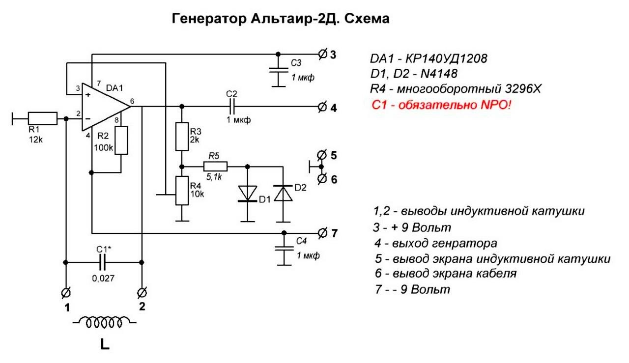

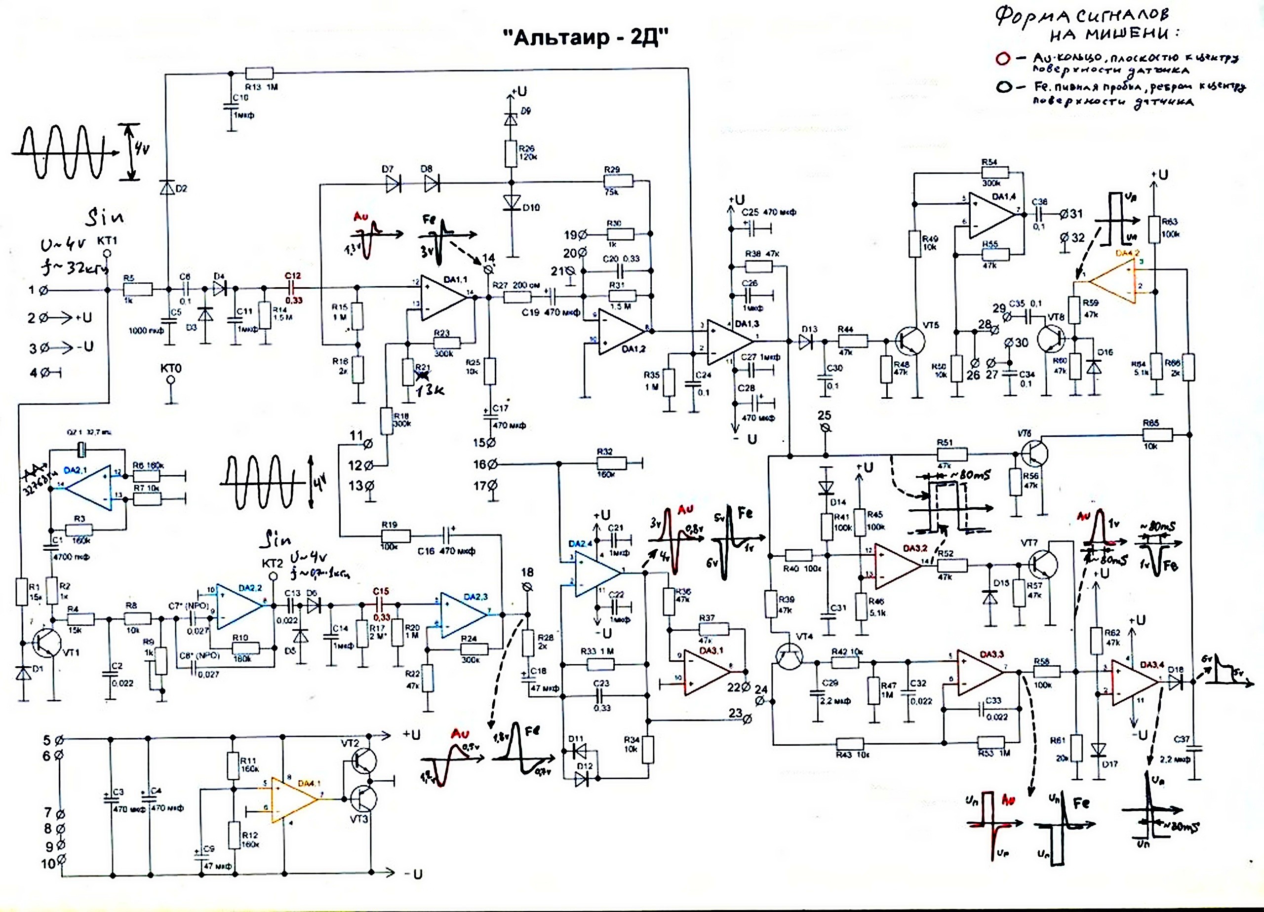

    Click image for larger version  Name:	DeepSeek2.jpg Views:	0 Size:	7.8 KB ID:	439232
      I've seen this diagram before....
      Схема данного металлодетектора простая, из активных элементов одна микросхема, транзистор и несколько диодов. Несмотря на простоту схемы металлодетектор, способен среагировать на приближение медной монеты (диаметром 2,5 см) к катушке на расстоянии около 10 см, а крупные предметы из цветных металлов, на расстоянии более 1 метра! Из за малого количества деталей у прибора очень малое потребление энергии
        DeepSeek for metals ? Yes! Sensitivity for a tin can about 1 m, for a well hatch 2 m. Maybe a little more. In the city, electrical interference doest allow to check maximum sensitivity. Coil: 60 turns 0.5mm, screened, diameter 55 cm (22 inch).​ Key words = screening and shielding. This machine is very silent MD - same like Tessoro MD.
        Lets DeepSeek analyse Альтаир 2Д!
        Click image for larger version  Name:	Альтаир-2Д. Осциллограммы.jpg Views:	0 Size:	735.2 KB ID:	439248

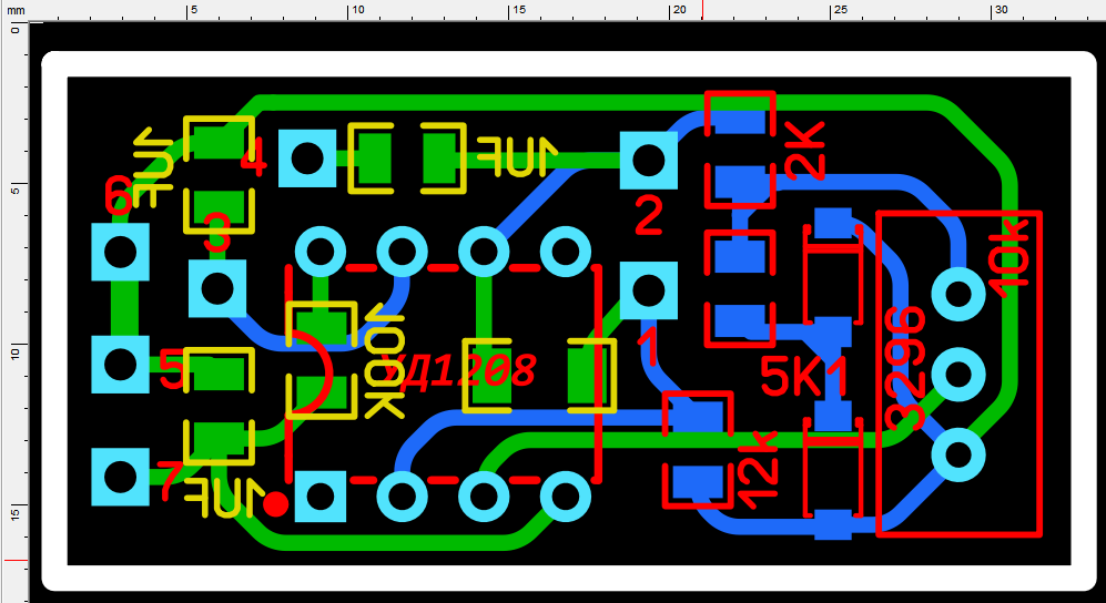

        Who will design PCB? Of course = DeepSeek!

                ​Click image for larger version  Name:	изображение.png Views:	0 Size:	387.4 KB ID:	439297​
                coil generator
                Click image for larger version  Name:	изображение.png Views:	5 Size:	72.6 KB ID:	439299
