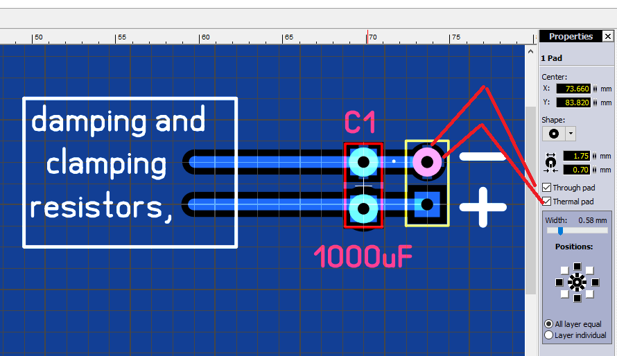

    I want to design the PCB for a PI detector, such as an Enhanced Goldscan 5, and I have a question that I'd like to hear the experts' opinion on. The PCB would be a two-layer PCB with all SMD components. The square wave signals are generated with a 555 and four 4538 ICs. The integrators are differential and I use a 5532. My question is whether it's better to use a single ground plane on the bottom layer or two ground planes, both on the bottom and top layers. I've done many SMD PCB designs, and the problem is the thermal noise generated by the damping and clamping resistors, the MOSFET, and the voltage regulators, which are components that get too hot and ruin the analog signals. Digital signals also generate some noise on the PCB, compromising the analog signals. I've noticed that all the PCB designs I've created in THT format perform better than the designs I created in SMD format, and I can't find an explanation for this. Conclusion: Which is better? Should I use one ground plane or two ground planes on a two-layer PCB?
    Thanks in advance.​
    thermal noise generated by the damping and clamping resistors, = separate tracce for that

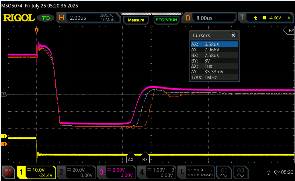

                              Sorry for the delayed response, I had to dig out an old test circuit for this. Here are the responses for clamp resistors of 1k, 2.2k, and 4.7k, looking at the output of a 100x preamp:
                              In each case the damping resistor is adjusted to create about the same amount of overshoot; that is, the same amount of overall damping. From 1k to 4.7k picks up 1us. The test circuit uses an NMOS switch (IRF740) and an inverting preamp, and the preamp gain was maintained at 100.
                              On the TekPoint pinpointer I used a 10k clamp resistor and I think I sample at 3 or 4 us. I'm curious about your pinpointer; what coil inductance do you use, and what timing and TX voltage?
