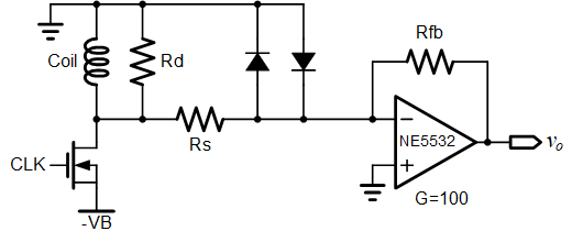

          The test circuit used an inverting amp, like this:
          For Rs = 1k, 2.2k, 4.7k Rfb = 100k, 220k, 470k. This alters the output offset due to the input bias current through Rs. Nominally, for the NE5532 it should be 235mV for Rs=4.7k. This probably explains the varied offsets, although the saturation levels are still curious. Might be due to the load effect of Rfb.
          Since Rs contributes to overall damping, as Rs was changed so was Rd. For the Rs=1k case, Rd should have been reduced a little more to get closer to critical damping. However, doing so will not affect the saturation knee to any great amount so the overall benefit would still be about the same.

            What confused me. If red trace points under-damped case (1K clamp), critical damping and over-damping cases have to be on the right of the red trace - later , not earlier! DC offset isn't matter.
              Yes, critical damping will slightly shift the saturation knee to the right but not by much.

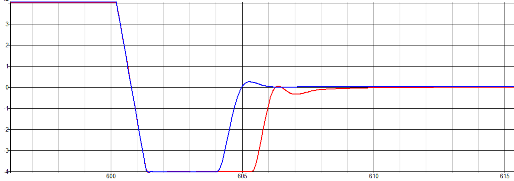

                      Maybe, but I've done this trick with several different opamps and it always helps. Reducing the diode's forward current reduces the diffusion capacitance and makes turn-off faster.
                        Yes, that's true. But please see the attachment to #9 of this thread. That confuses me.
                          I don't know what you are doing to get those measurements. I've always found it curious that Schottky diodes never seem to work as well as a plain old 1N4148 in this application despite having far less diffusion effect. But the correlation of reduced clamp current to faster settling with the 4148 is pretty consistent. Here is a Spice sim using a MAX410:

                            As usual, the processes are more complex as it seems at first look. The temperature of the diode haves serious influence on diffusion capacitance according the theory. My measures are with 2us current pulse and 2ms pause. But if the current pulse is 5us (decay time) and the pause is 50-100us, the temperature of the diode will be higher than room temperature and the diffusion capacitance will be seriously higher. This explains my measurements and your observations when you use high frequency (10-20)KHz search frequency. In this case, seriously reduced peek current via 1N4148 diodes will have significant influence . Tomorrow, I will made measurements for dependence of the diffusion capacitance of 1N4148 from the temperature.
                              My tests were at 1kHz, I think the TX pulse was 100us.
