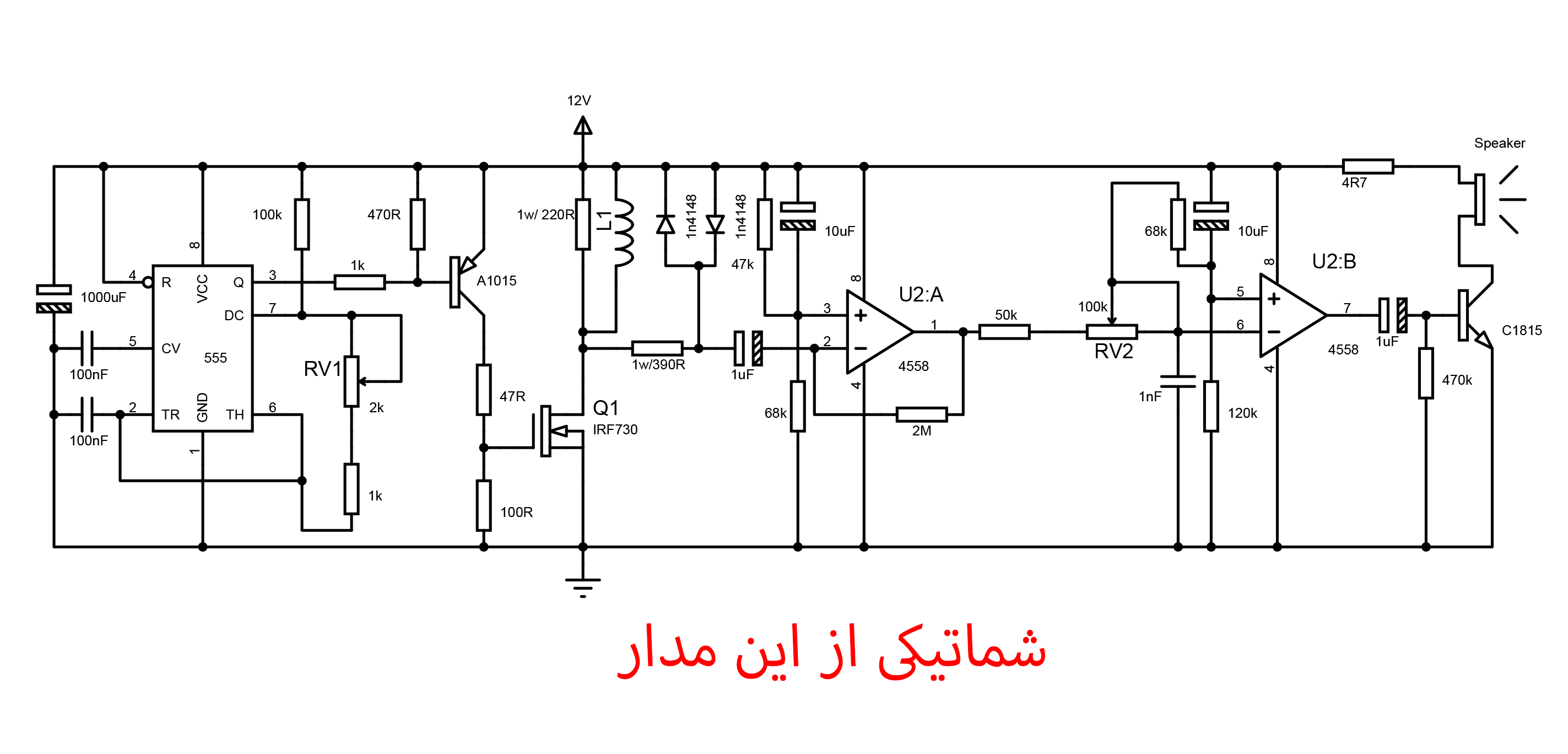

        Here I share the schematic of the detector from the video. I drew it in EasyEda. I should clarify that the video is not mine.

              Is R13 correct?
                Is R13 correct?
                Hi Carl!
                The drawing is based on the PCB shown in the video. Between pins 3 and 4 of the 4558 is R13 (68K). What I see is that the detector runs on a 16-volt power supply, and instead of the IRF730, they used 2SD380 (power transistors).​

                        better forget about chatgpt and gemini to "design" your circuit because all is nosens what they told you. Better study the subject the traditional way and read a book or visit online tutorials on electronics.​
                          better forget about chatgpt and gemini to "design" your circuit because all is nosens what they told you.​
                          Correct. For example, the IRL3705N is completely wrong for a PI design. ChatGPT isn't as smart as it thinks.
