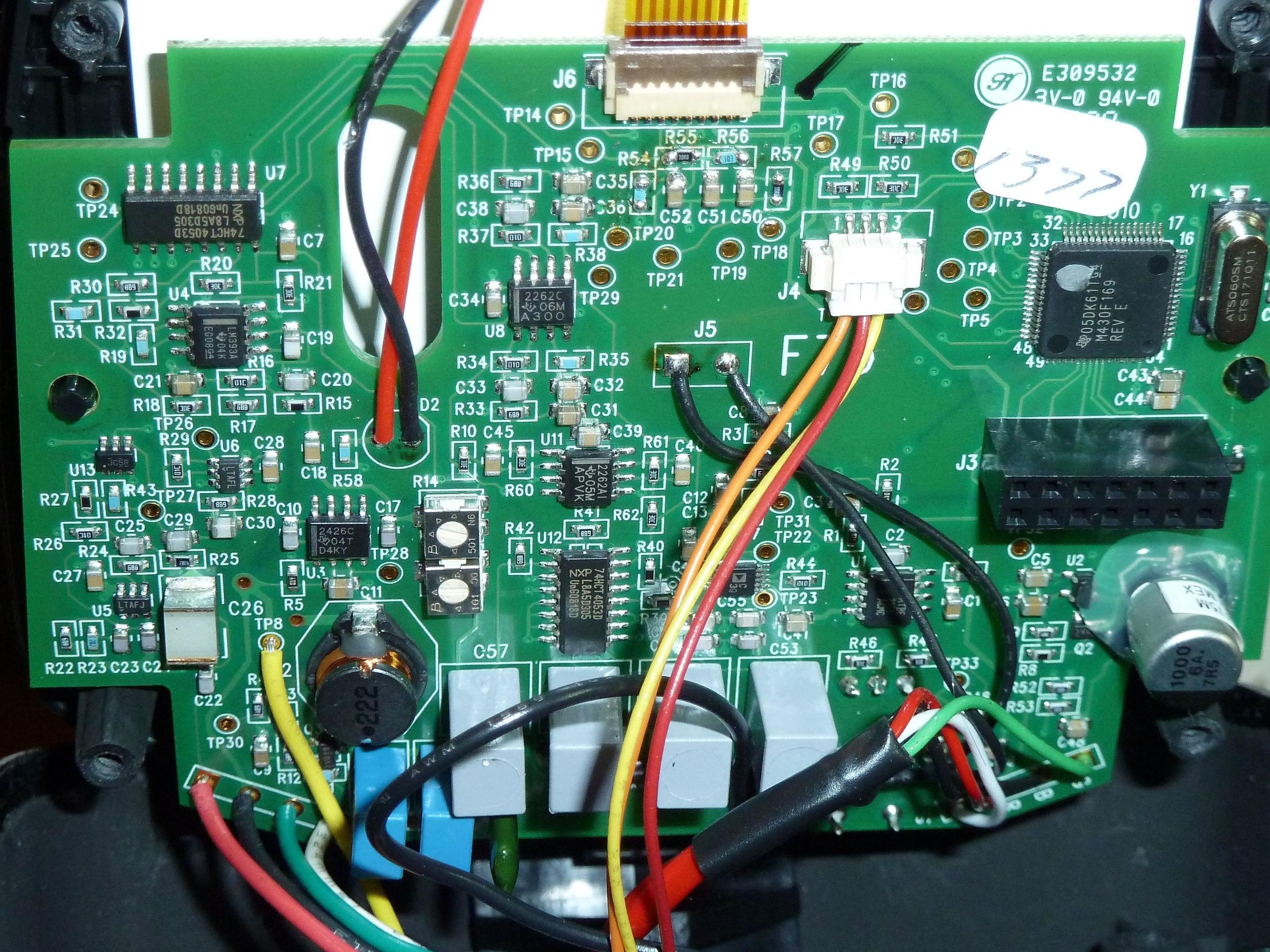

Good evening team, another problem, having dismantled my Fisher Pro Arc in France to bring it back to Algeria, I have a small problem when reassembling it, the detector starts very well, it detects very well but it is impossible for me to navigate in the menus, the left button (setting) puts the detector in discrimination to all metals when I turn it to the right and in discrimination to the left but when I then press the right button (Menu), nothing happens, I tested this push button outside the PCB and it works very well thank you.

As for the problem you describe; it all reminds of flat cable problems.
​Or, I stand corrected, an encoder failure might be to cause of the problem too.

One thing to check: The rotary encoder has a push-button built into it. This is connected - there is a pull-up resistor to the 5V power supply, and it links to a micro pin. The software DOES read it, though it's functions are minimal, "notch cancel" is one I recall, it also 'wakes up' the micro if it has timed-out when no button has been pressed.
It maybe this push-switch is faulty, or permanently jammed in. Test to see if it clicks in/out. Check the voltages on it's two pins - one is direct to Ground / 0V, the other will be +5V, and fall to 0V when the switch is pressed [ if I remember correctly ]
Good evening, thanks to ivconic for his file and thanks to the whole group, the problem is solved, I had just reversed the wires of the menu button and the two black wires which go to the LCD display, I put them back in place according to the ivconic diagram and my detector works like new. Bravo to all and thank you. Greetings.Attached Files
