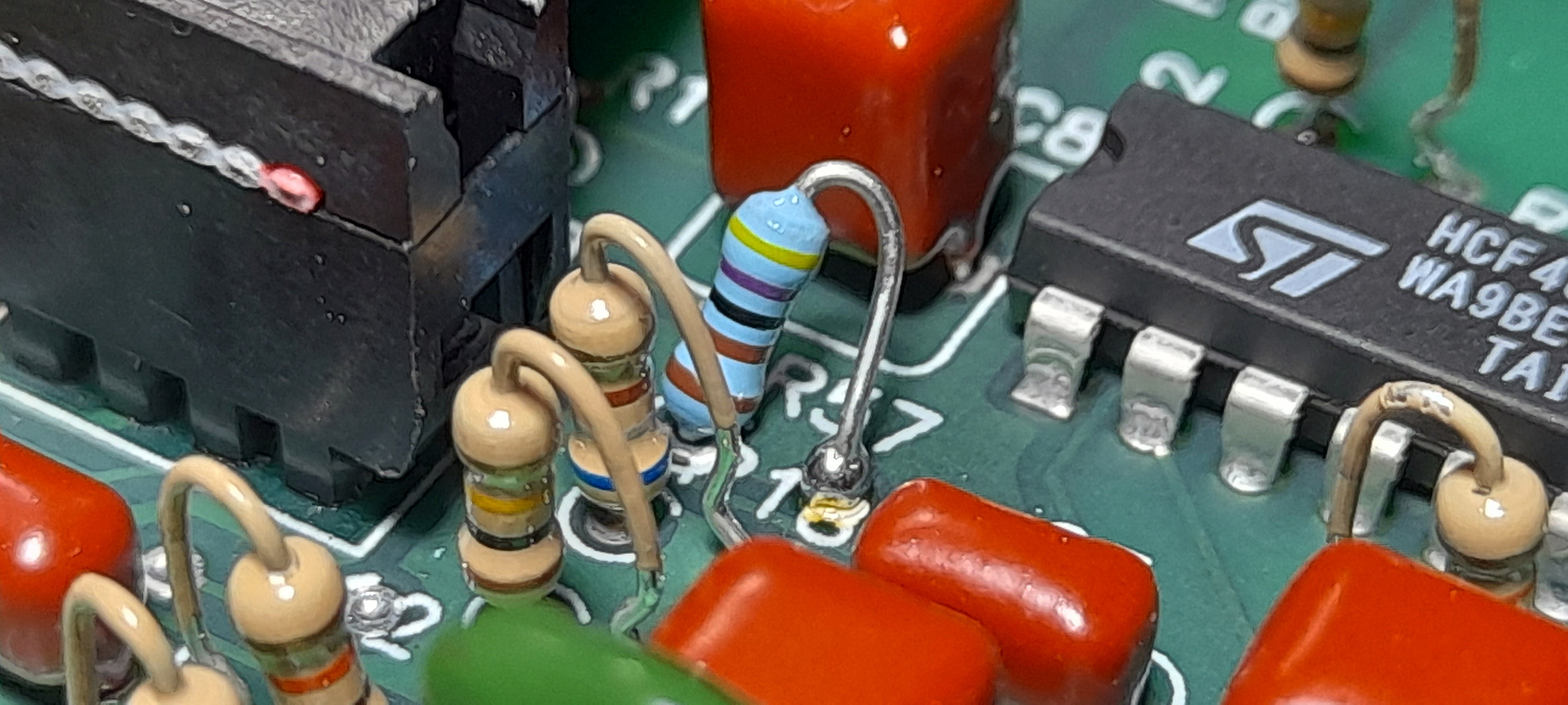

    Hi guys.

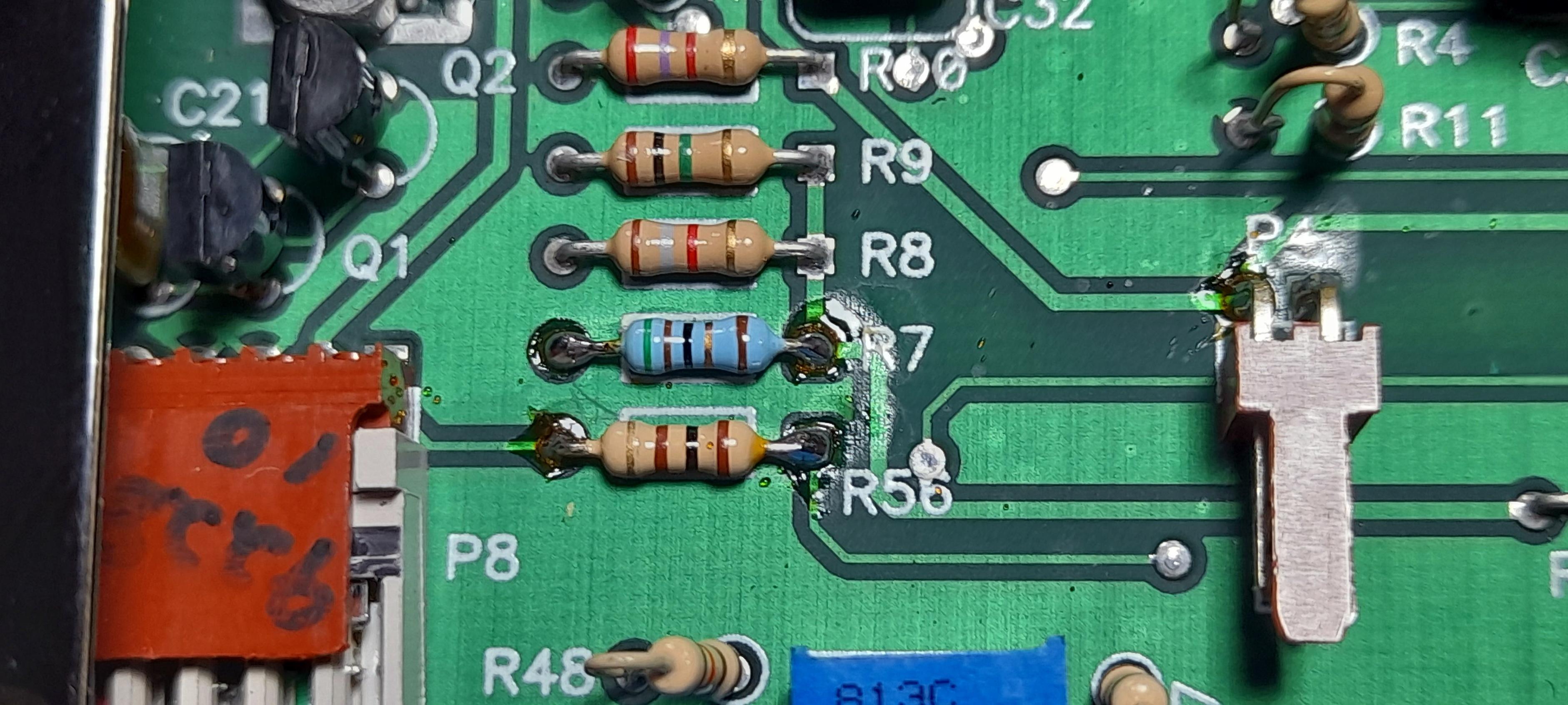

    it has been a few years since i done a MR bills Mod to a Whites Classic machine.
    anyways. i have reasonably picked up a classic SL with the ID Meter on. i am going to do the Mod on it. i opened the case today to check it's insides out. on looking at the board 3 resistors have already been replaced.
    resister R7 51 Ohms 1% tolerance.
    resister R56 100 Ohms 5% tolerance.
    resistor R18 1100M Ohms 5% tolerance. i am not sure why this resistor has been replace. or what the original resistor value was. not mentioned in the MR Bills Mod.
    thanks in advance guys....
    R57 was replaced, not R18, and it's 47 ohms, not 1100M. The original value (in the Classic 3) is 10k. It is in parallel to the 10k disc trimmer and 47 ohms seems very low to me.

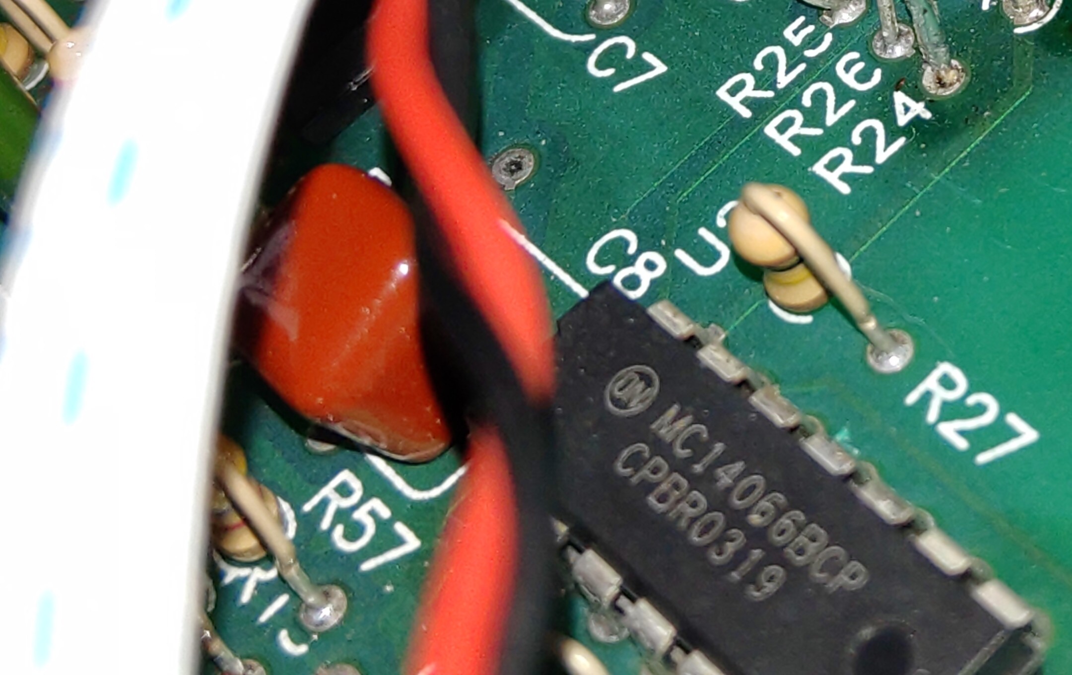

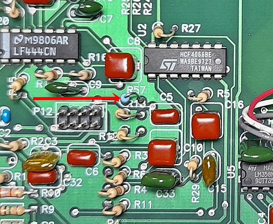

        is that resister numbered 57 on the board. have i been looking at it wrong.
          Yes.
            replacing R57 was not mentioned in the MR Bills Mods. why do you think that it has been replaced? should i replace R57 back to the original 10k resistor.
              i have found a photo of a board with the original R57 resistor still in place on the board, but i can not make out the color bands very well.

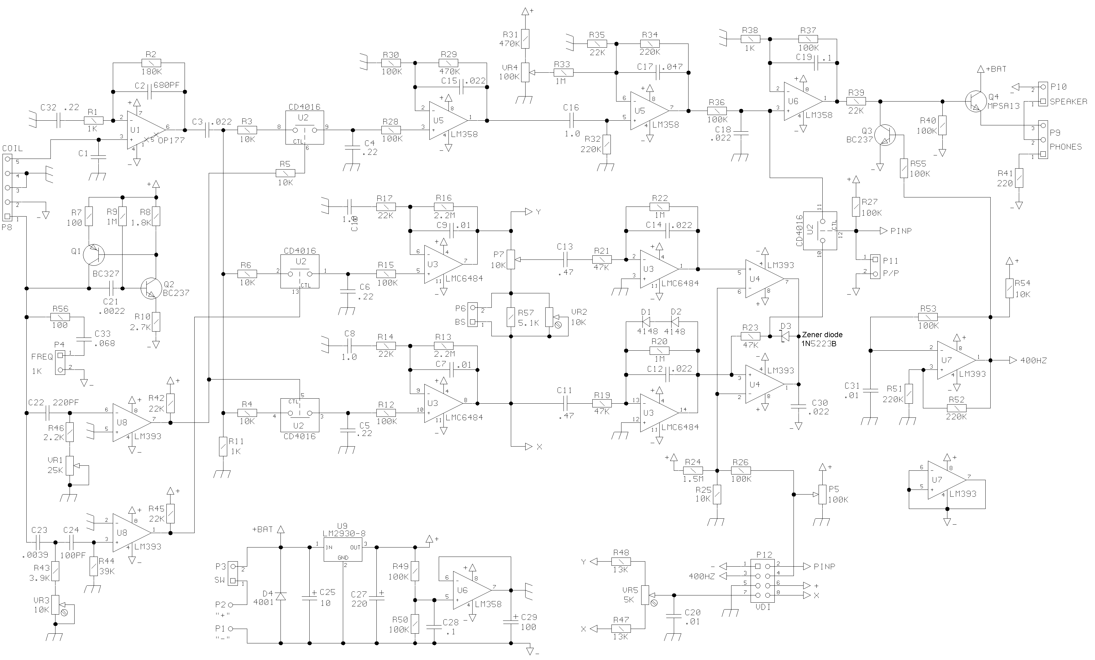

                sch of IDX
                  On the IDX it's 5.1k, on the Classic 3 it's 10k, and it's not used in the Classic 4. It's not all that important, it just determines the trim range for the disc control for setting a consistent disc point.
                    so do you think that i should just leave that replaced resistor in on the board. or swap it out for a 10k resistor?
                    thanks in advance....
                      I would first see how the disc control is behaving. If it seems correct, leave it alone.

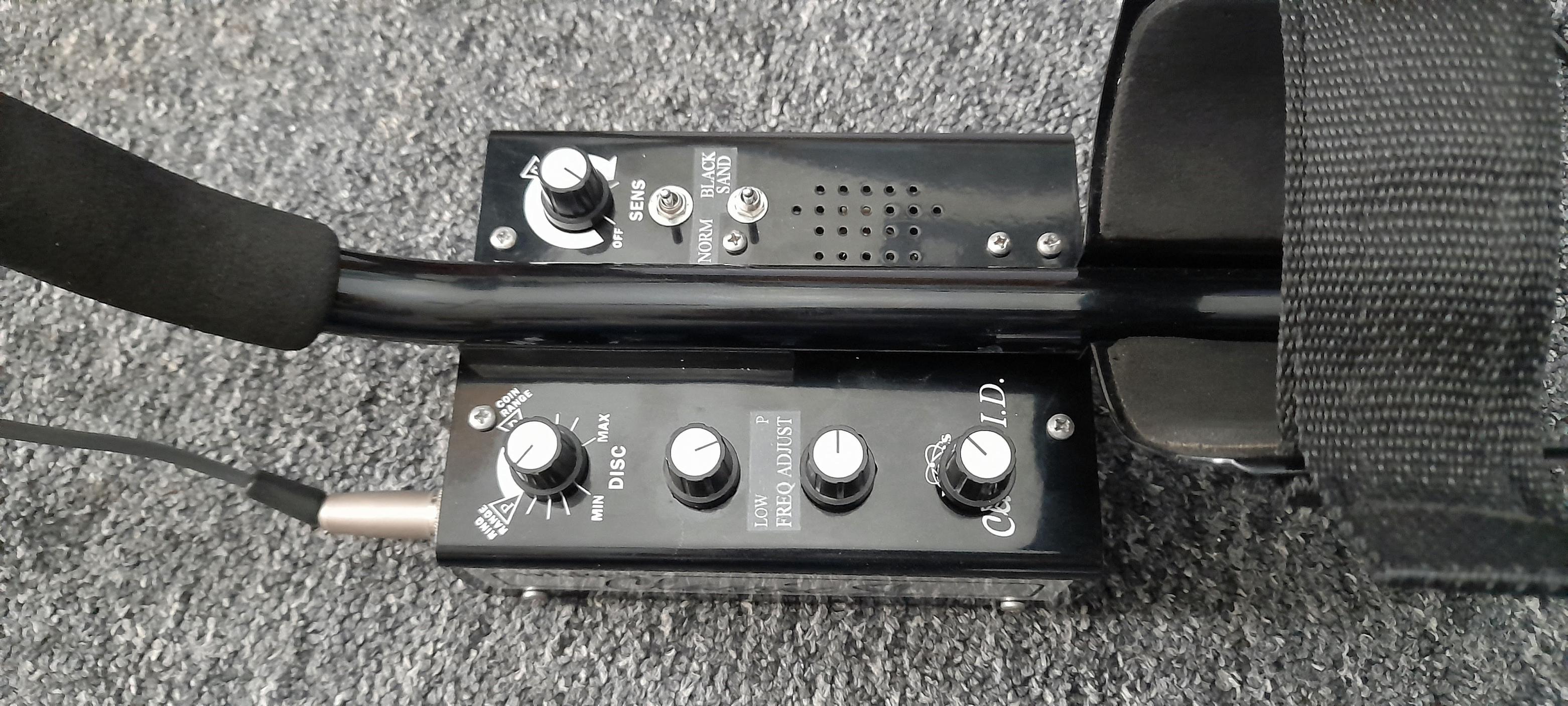

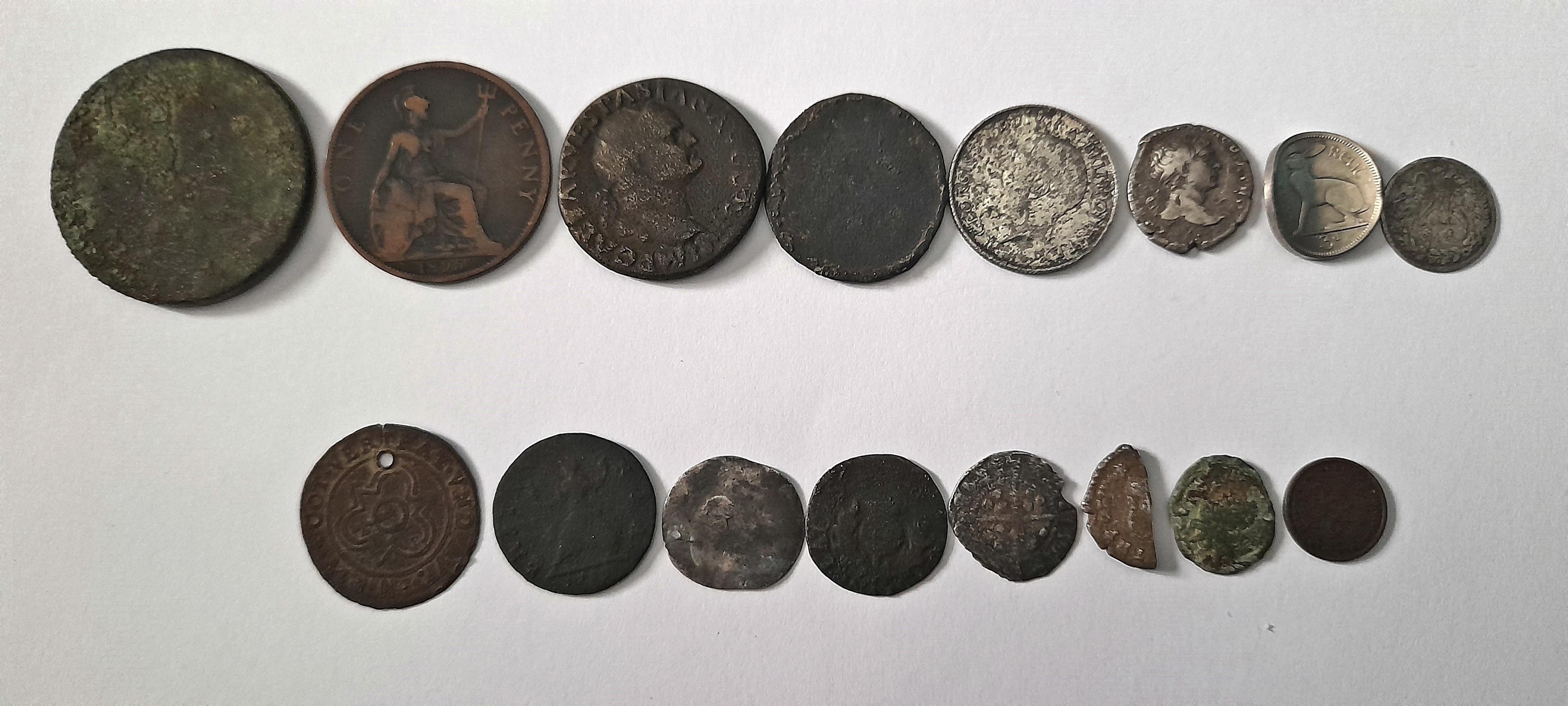

                          Hi again Carl.
                          i have done all the mods to the machine now. including the ID meter one. all seems to be working ok from what i can tell. pic below. i tested to see how the disc control was behaving like you suggested. i am not familiar how and ware coins should be reacting on this machine, but if you look at my second photo. i tested all these coins on two setting on the disc control. first on the "Ring Range Presetting" all coins were being picked up OK. then on the "Coin Range Presetting" not all the coins were being picked up. only the coins in the top row of the photo. does that seem about right do you think?
                            maybe you need direct hit but are not able to seek up??
                              Hi again Carl.
                              if you tested in air your tests are sure useless. you have to test in/at grund in real conditions and according RTM you have to tune GND BALANCE at first. in ALL-METAL mode.
                              while you do not even wish to mention that.
