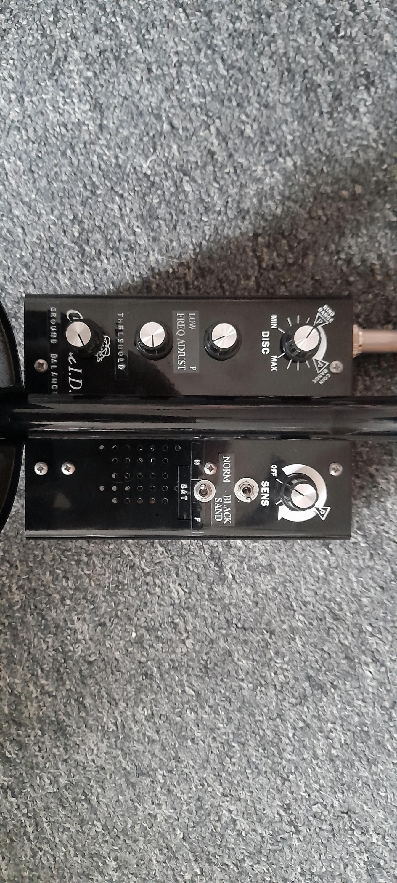

    first on the "Ring Range Presetting" all coins were being picked up OK. then on the "Coin Range Presetting" not all the coins were being picked up. only the coins in the top row of the photo. does that seem about right do you think?
    Ring range should pick up everything above foil, coin range will reject some cupro-nickel coins but should accept most copper & silver coins. I'm a little surprised it accepts the Irish 3p and rejects the farthing. As for the other rejected coins, I'm not as familiar with them, but a lot of thin hammered silver coins can ID in the cupro-nickel range.
      thanks so much for that Carl. much appreciated. i will do some in ground testing with the machine and see how i get on......

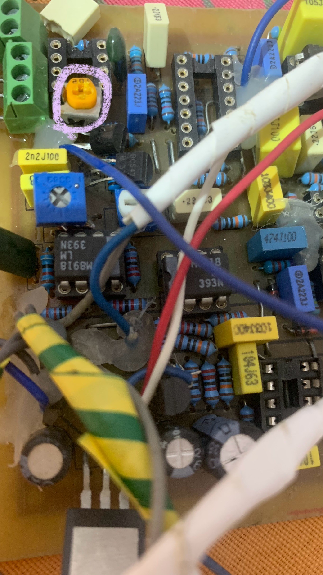

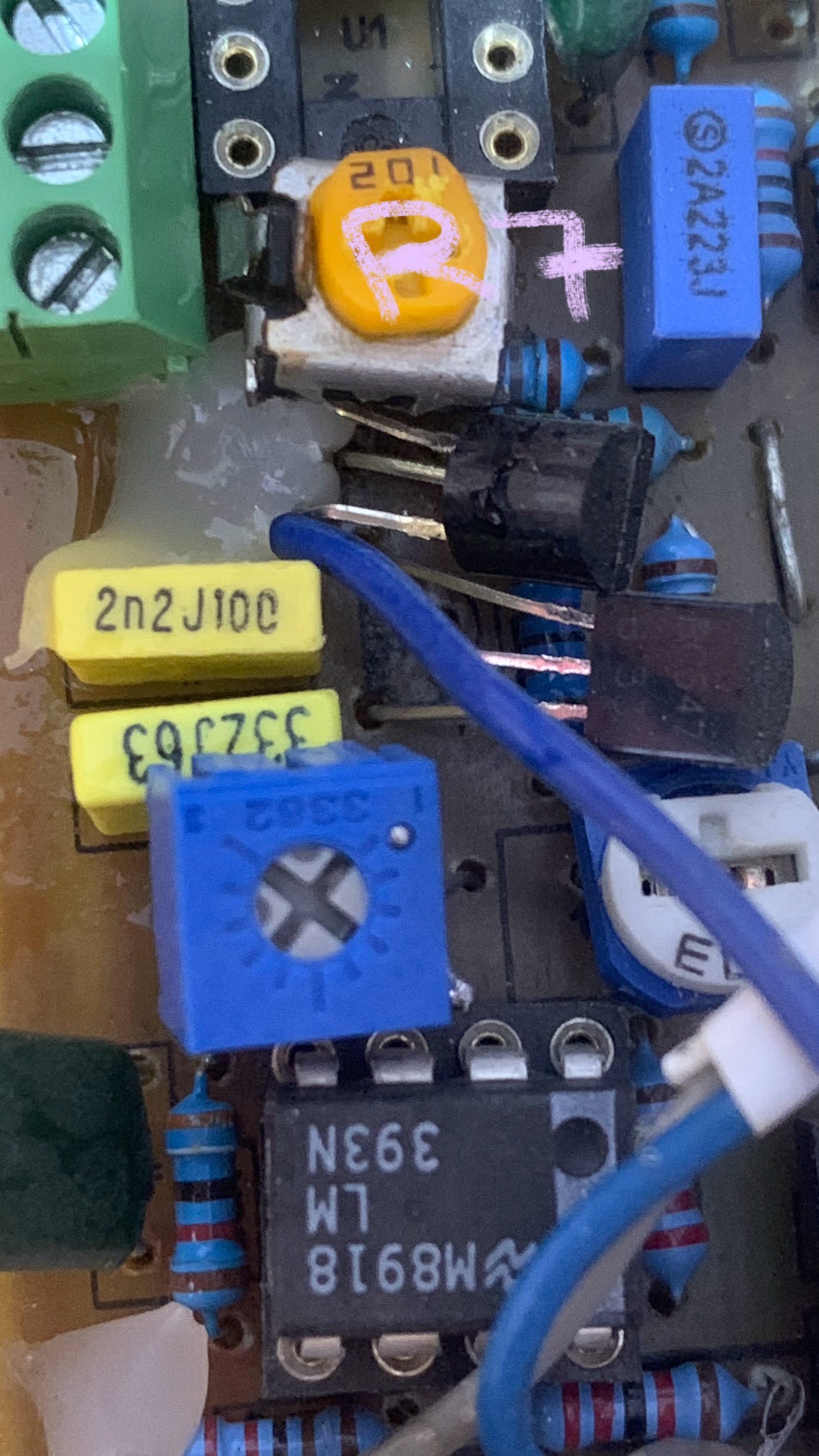

            I replaced R7 in my IDX pro with a 200 ohm trimpot, and then with my oscilloscope I managed to find the best result. You can actually do it without the o-scope by air testing it with a coin until you get the best possible depth.
              thanks Nightryder for that idea. do you have any photos of when you did that mod......

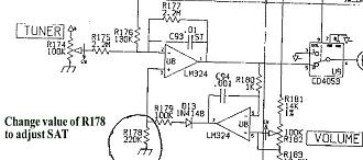

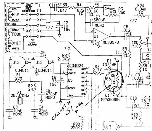

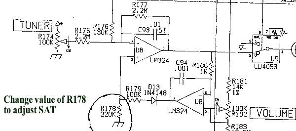

                I found the following to Mr. Bill modifications. Maybe it is usefull.
                [ATTACH]n441330[/ATTACH]
                  Click image for larger version  Name:	bill_mod_2.jpg Views:	0 Size:	43.8 KB ID:	441331 Click image for larger version  Name:	bill_mod_1.jpg Views:	0 Size:	84.7 KB ID:	441332
                    I don't but I can take a photo for you when I get home later this week. it's a little tight fit since R7 on the PCB was designed for a 1/4 watt resistor. cheers

                      yes please. i would very much appreciate that if you could...............

                        In case you are wondering, The DIY version of the IDX, which I'm using, has the same resistors numbering on the original. Also, mine is heavily Modified such that it has 2 tones and VDI and that explains the wirings
                        Click image for larger version  Name:	IMG_4780.jpg Views:	0 Size:	654.0 KB ID:	441474
                        Click image for larger version  Name:	IMG_4782.jpg Views:	0 Size:	668.5 KB ID:	441475
                          Nice.....yes, it looks like a lot of careful work has been done to the board.

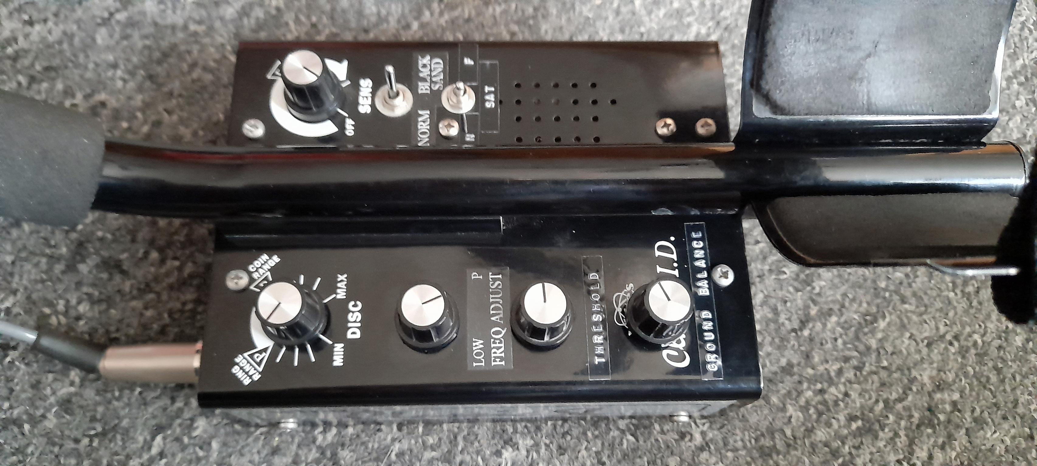

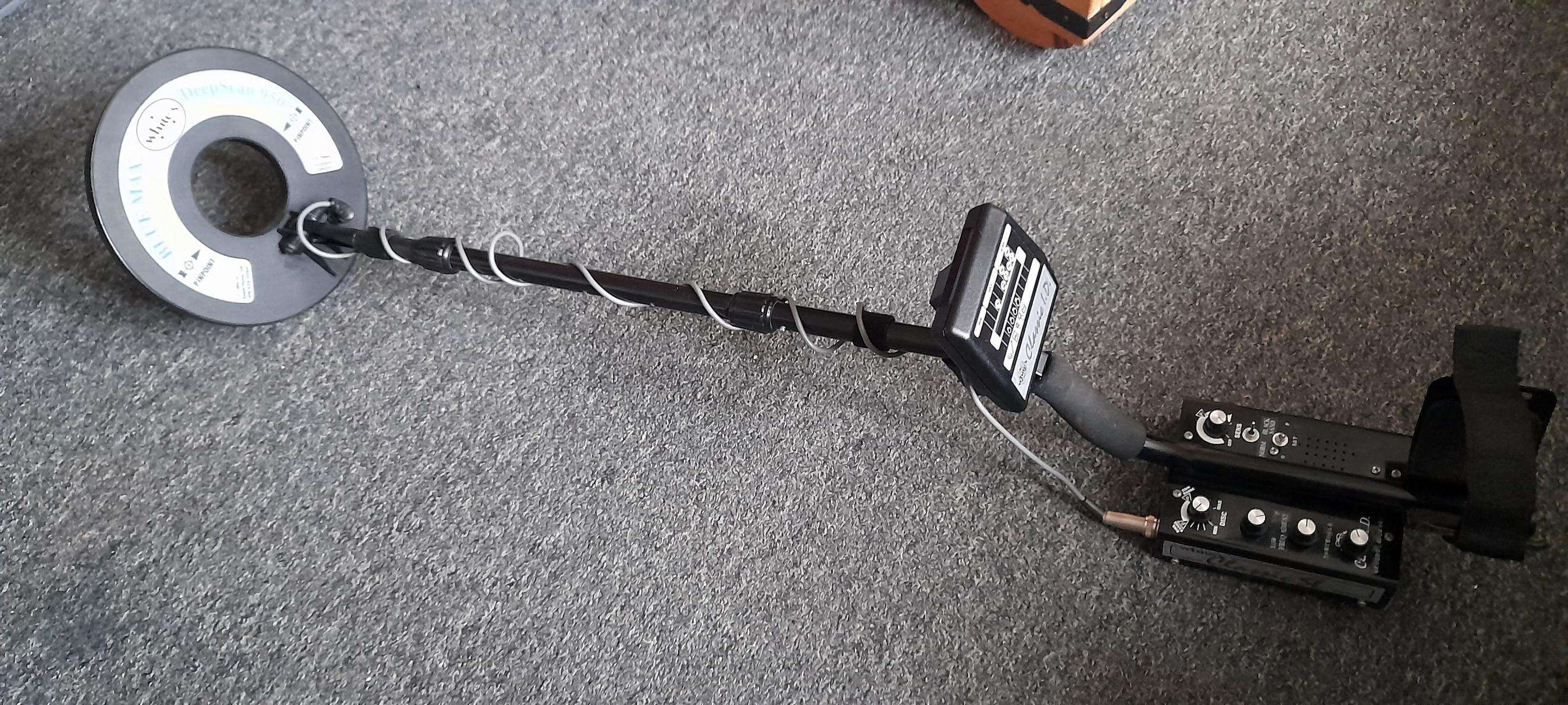

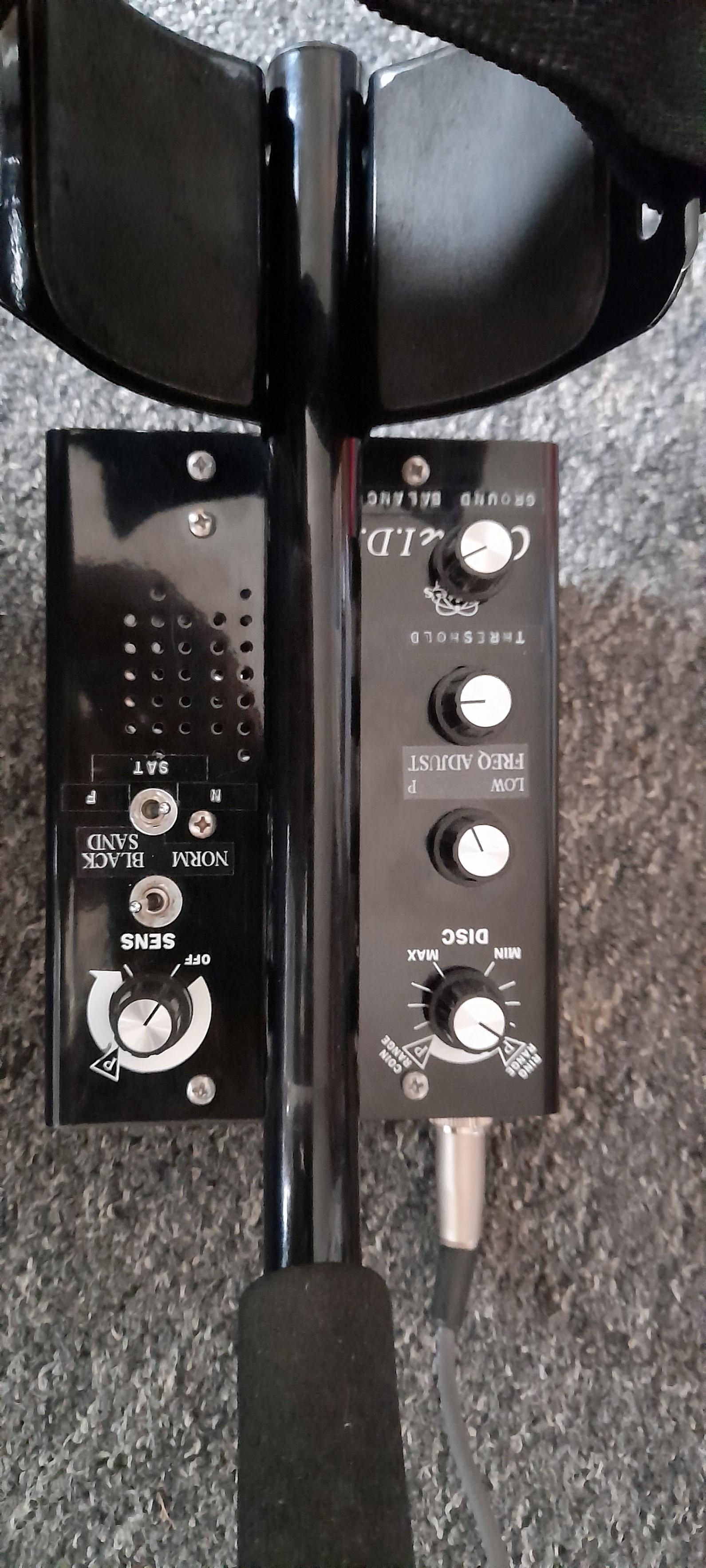

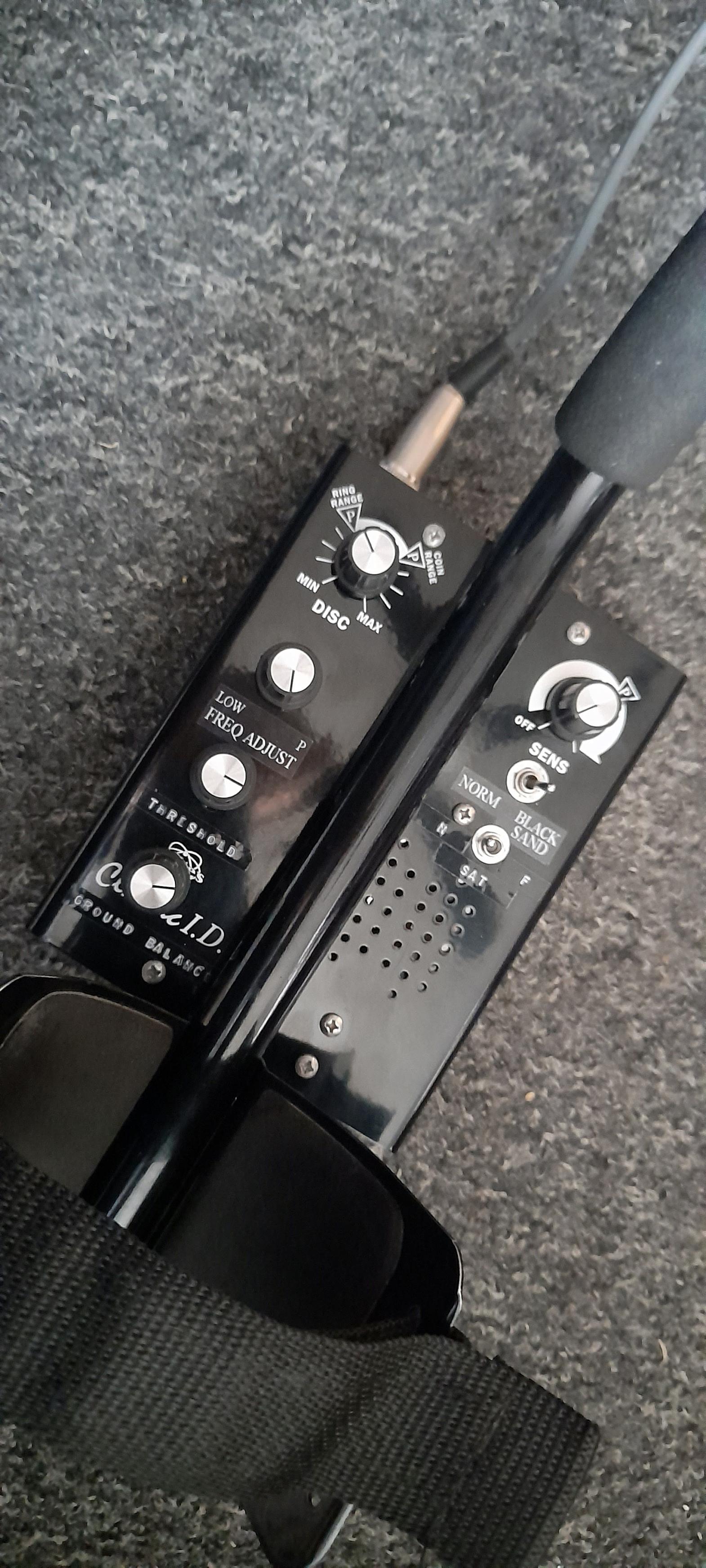

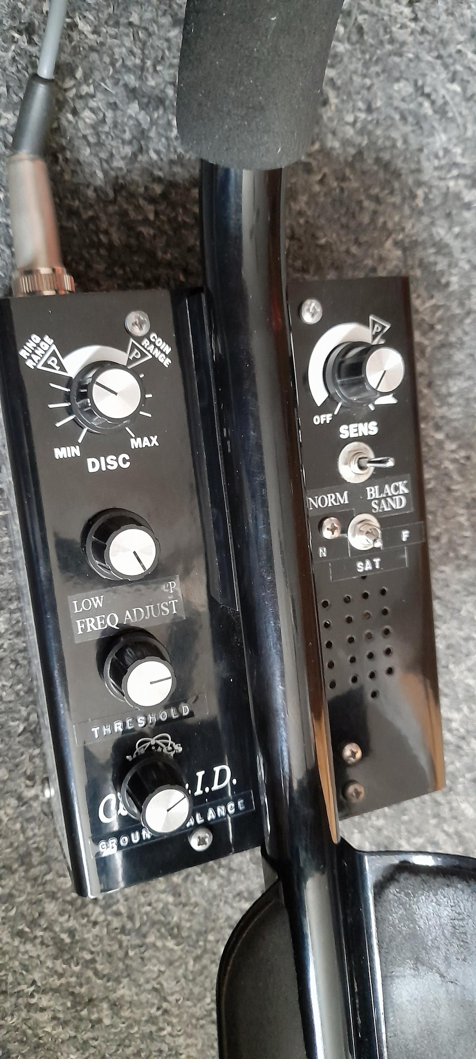

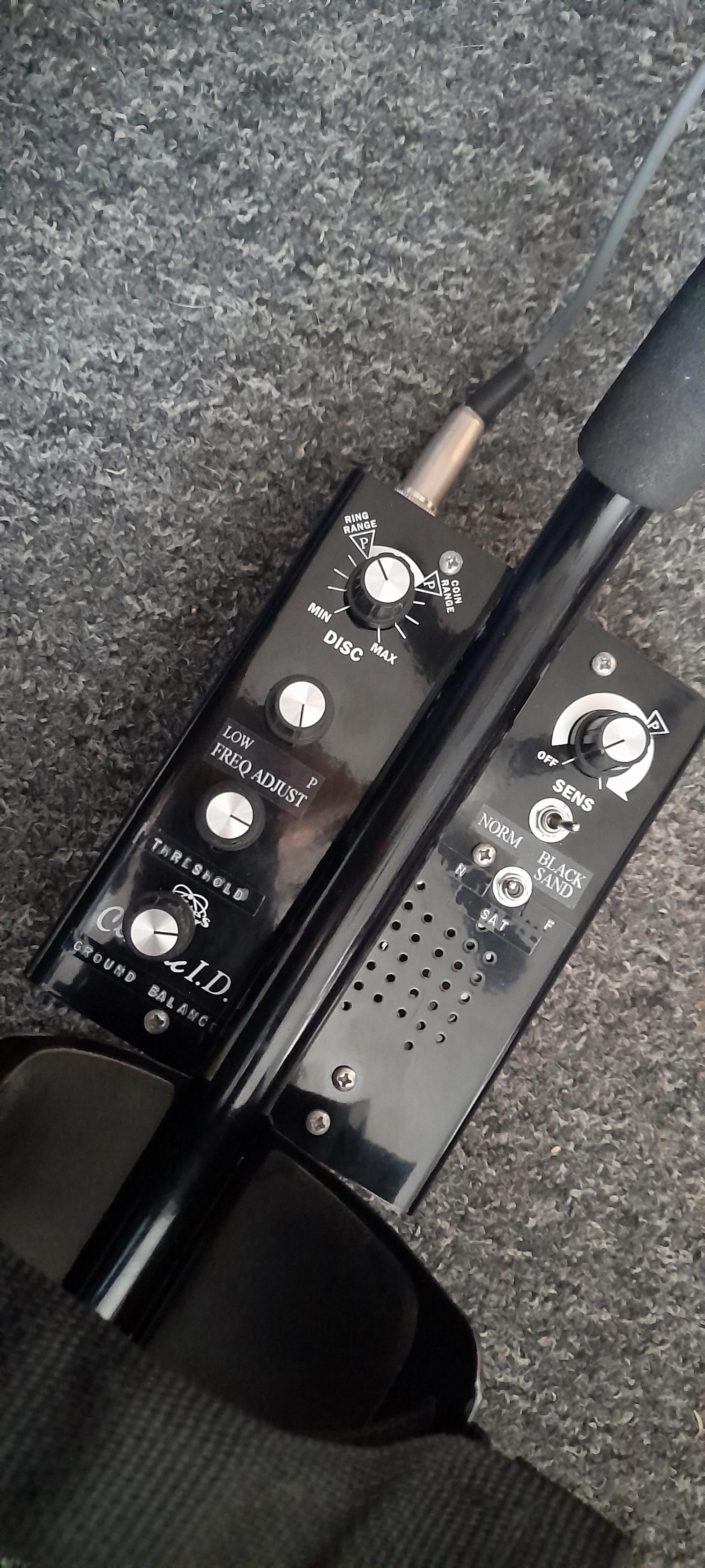

                            i forgot to show the machine fully finished with labels next to the new controls.......
