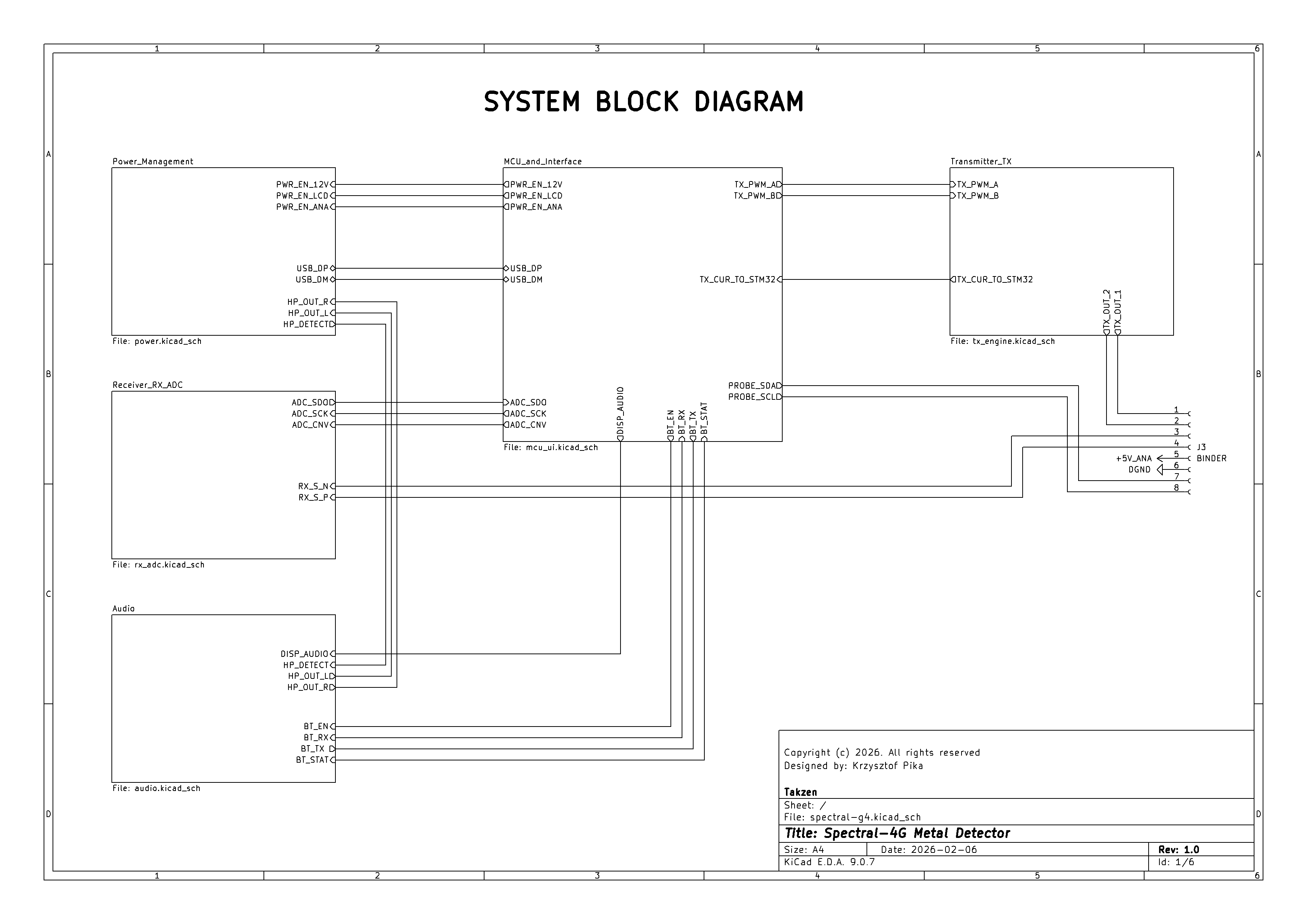

        Hi everyone,
        To give you a better "bird's-eye view" of the project, I’ve put together a high-level block diagram of the Spectral-G4 architecture. I believe that in modern VLF design, the way we handle the signal before it even reaches the MCU is what separates a standard detector from a high-performance instrument.
        Here’s a breakdown of the signal flow and the logic behind my choices:
        1. The TX Engine (The Excitation)
        I’m using a full H-Bridge driven by the STM32G4’s HRTIM (High-Resolution Timer). While many modern designs move towards Sine waves, I’m intentionally using a 7.8 kHz square wave with ultra-sharp edges. Why? To ensure a rich harmonic content (3rd and 5th harmonics) which are essential for the Neural Spectral Fingerprinting later in the chain.
        2. The Smart Probe (Distributed Intelligence)
        This is the heart of the "active" part of the project. Inside the coil, an STM32G0 acts as a co-processor.
        • Active Vector Nulling: Instead of relying solely on mechanical geometry, I’m using dual DAC channels and a precision toroid transformer to inject a compensation signal. This allows for dynamic, firmware-controlled balancing of the RX/TX offset.
        • Power: The probe is powered via a harvesting circuit from the TX lines, reducing the need for extra power wires in the cable.
        3. The Analog Front-End (AFE)
        Low noise is my obsession here.
        • Preamp: An ADA4841-2 handles the initial gain.
        • Differential Conversion: I’m using an ADA4941-1 to drive the ADC. Converting to a fully differential signal at this stage is crucial for EMI rejection and to fully utilize the SAR ADC’s range.
        • VREF: A stable 4.096V reference (REF3240) ensures that my 18-bit measurements remain consistent across temperature shifts.
        4. Data Acquisition & DSP
        The signal is digitized by the AD7690 (18-bit SAR ADC) via a high-speed SPI/DMA link.
        • Dithering & Oversampling: By adding controlled analog noise (dithering) and oversampling in the G4, I’m aiming for a 20-bit effective resolution.
        • Hardware Acceleration: The CORDIC unit in the STM32G4 handles the I/Q demodulation in real-time, leaving the CPU cycles free for the AI layer.
        5. The Neural Layer (The Decision Maker)
        The demodulated vectors (1st, 3rd, and 5th harmonics) are fed into a TinyML model (TensorFlow Lite for Microcontrollers). Instead of a simple VDI number, the system outputs a classification probability based on the target’s spectral "fingerprint."
        I’m particularly curious about your thoughts on the Active Vector Nulling via the toroid. Has anyone here experimented with active digital compensation in the coil assembly?

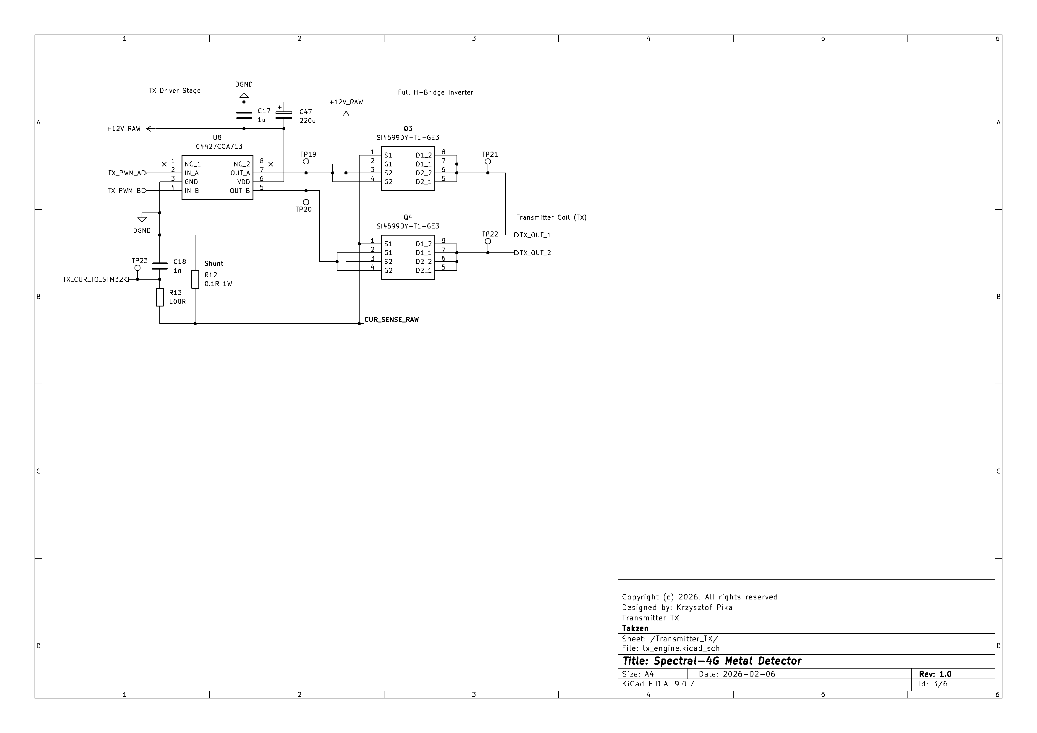

          Following my introductory post, I’m diving straight into the first module of the Spectral-G4: the Transmitter (TX) Driver Stage.
          In most VLF designs, the TX stage is often overlooked, but for a project relying on Neural Spectral Fingerprinting, the quality and "sharpness" of the excitation signal are everything. If we want to analyze the 3rd and 5th harmonics, we need a TX bridge that can switch fast and clean.
          The Schematic Breakdown:
          1. Full H-Bridge Architecture: I’ve opted for a full-bridge topology using two Si4599DY complementary N+P channel MOSFET pairs. This allows for a 24V peak-to-peak swing from a single 12V rail, maximizing the magnetic moment without complex power rails.
          2. High-Speed Gate Driving: To minimize switching losses and, more importantly, to achieve ultra-sharp square-wave edges, I’m using the TC4427COA dual MOSFET driver. It provides up to 1.5A of peak current to quickly charge/discharge the gate capacitances.
          3. Current Monitoring (The Feedback Loop): You’ll notice a 0.1R 1W shunt resistor (R12) at the bottom of the bridge. The signal TX_CUR_TO_STM32 (after a simple RC filter) is fed back to the STM32G4. This allows the system to:
            • Monitor real-time power consumption.
            • Detect over-current conditions (shorted coils).
            • Potentially implement a software-based resonance tuning check.
          4. Bulk Decoupling: I’ve placed a 220uF low-ESR electrolytic capacitor (C47) in parallel with a 1uF ceramic (C17) right at the bridge entry. Switching several hundred milliamps at 7.8 kHz can create significant ripples; keeping the TX noise isolated from the future RX stage is priority one.
          Why Square Wave?
          While sine waves are "cleaner" for traditional phase-ID, they are energetically expensive to produce and lack the harmonic richness I need. By using a precisely timed square wave (via the G4’s HRTIM with nanosecond dead-time control), I’m effectively "illuminating" the target with multiple frequencies simultaneously.
          Technical Question for the experts:
          I am currently debating the optimal value for the shunt filter (R13/C18). I want to capture the current envelope without introducing too much phase lag for the protection logic. What are your thoughts on current sensing in high-speed TX bridges for VLF?
          I've attached the KiCad schematic of the TX section. Looking forward to your thoughts!
          Cheers,
            What's the purpose of R13/C18?
            At White's I did some work on dynamic coil nulling but not with a transformer. I could make it work decently for a sine wave but wideband was far more difficult.
              Hi Carl. Do you have a more detailed explanation about dynamic coil reset?
              I'd like to try it. Thanks.​
                Hi Carl,
                You’re right to point that out. To be specific: R13 and C18 are strictly for TX coil current monitoring in the main unit.

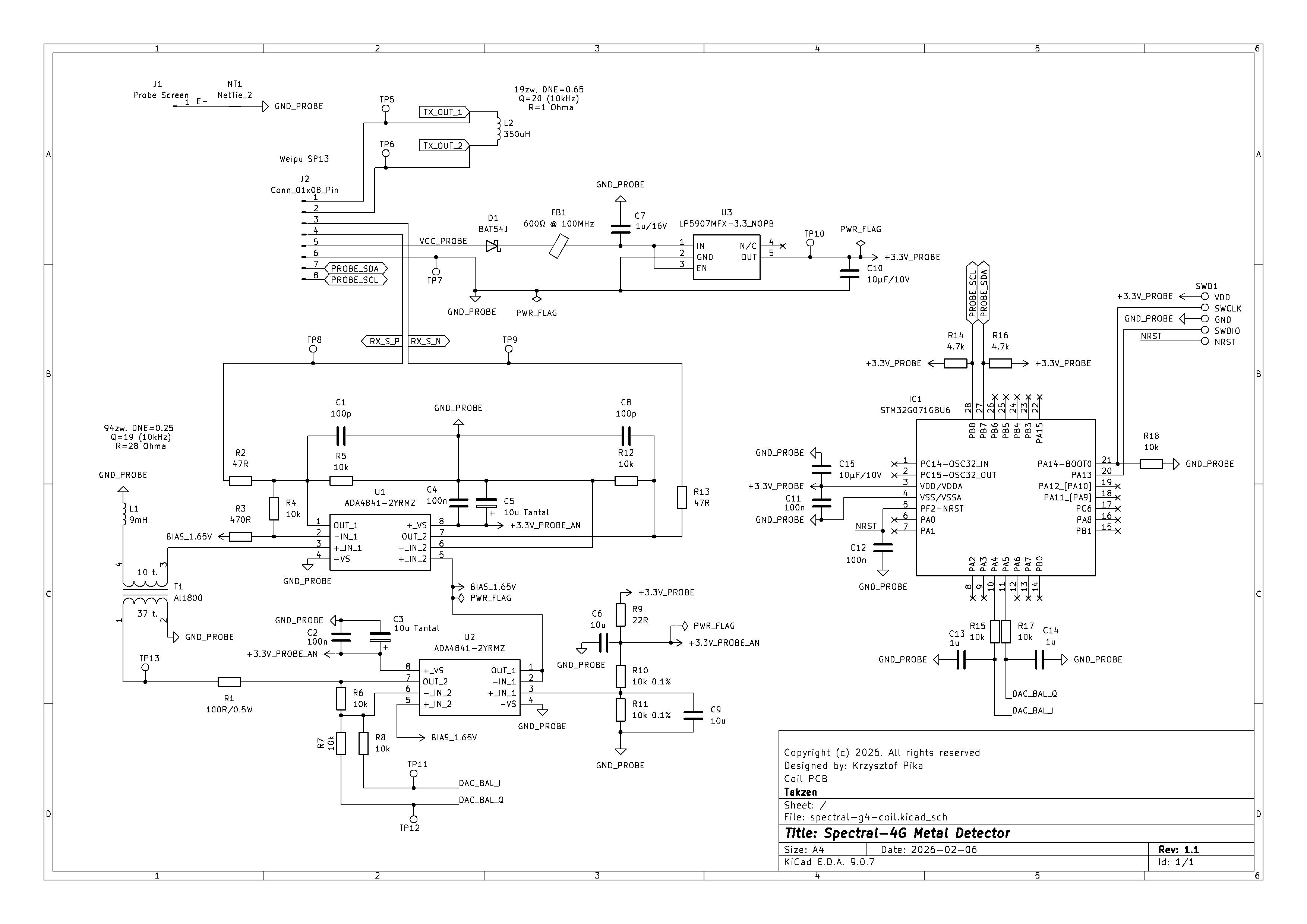

                The transformer-based nulling you’re referring to is actually located inside the coil assembly (what I call the "Smart Probe"). It’s a separate subsystem where an STM32G0 MCU manages the active vector compensation using a small toroid for signal injection.
                To provide a bit more technical context on how this works:
                1. Toroid Summation: I am using a high-permeability toroid (secondary winding in series with the RX coil) as a summing transformer. The compensation signal is injected directly into the RX path at the source, before it enters the cable.
                2. Local Vector Generation: The STM32G0 generates a precise compensation vector. By having the "brain" inside the coil, I can minimize the phase shifts and EMI pickup that usually occur when sending low-level analog compensation signals through a long cable.
                3. 8-Core Connectivity: To ensure maximum stability, I am using an 8-core shielded cable. This allows for dedicated power lines (VCC/GND) for the probe electronics and a separate digital bus for communication between the G4 and G0, keeping the RX signal as clean as possible.
                4. The "Saturation Prevention" Strategy: Addressing your point about wideband difficulty. I am not aiming for a perfect wideband zero. The primary goal is to null the 7.8 kHz fundamental. By removing the "carrier" physically at the source, I prevent the RX preamp (ADA4841) from saturating. This leaves the full dynamic range of the 18-bit SAR ADC available to capture the 3rd and 5th harmonics, which the AI then uses for classification.
                In essence, I'm using the hardware to handle the "brute force" (the fundamental) and the AI to handle the "nuance" (the harmonic residuals).
                I've attached the schematic of the Smart Probe below. I’d love to hear your thoughts on this approach, especially regarding the stability of the toroid injection over temperature.
                  I noticed a small error in the schematic I just shared regarding the transformer (T1). On the secondary side (injection), there are actually 10x fewer turns compared to the primary. This step-down ratio is crucial for better resolution of the compensation signal and lower output impedance.

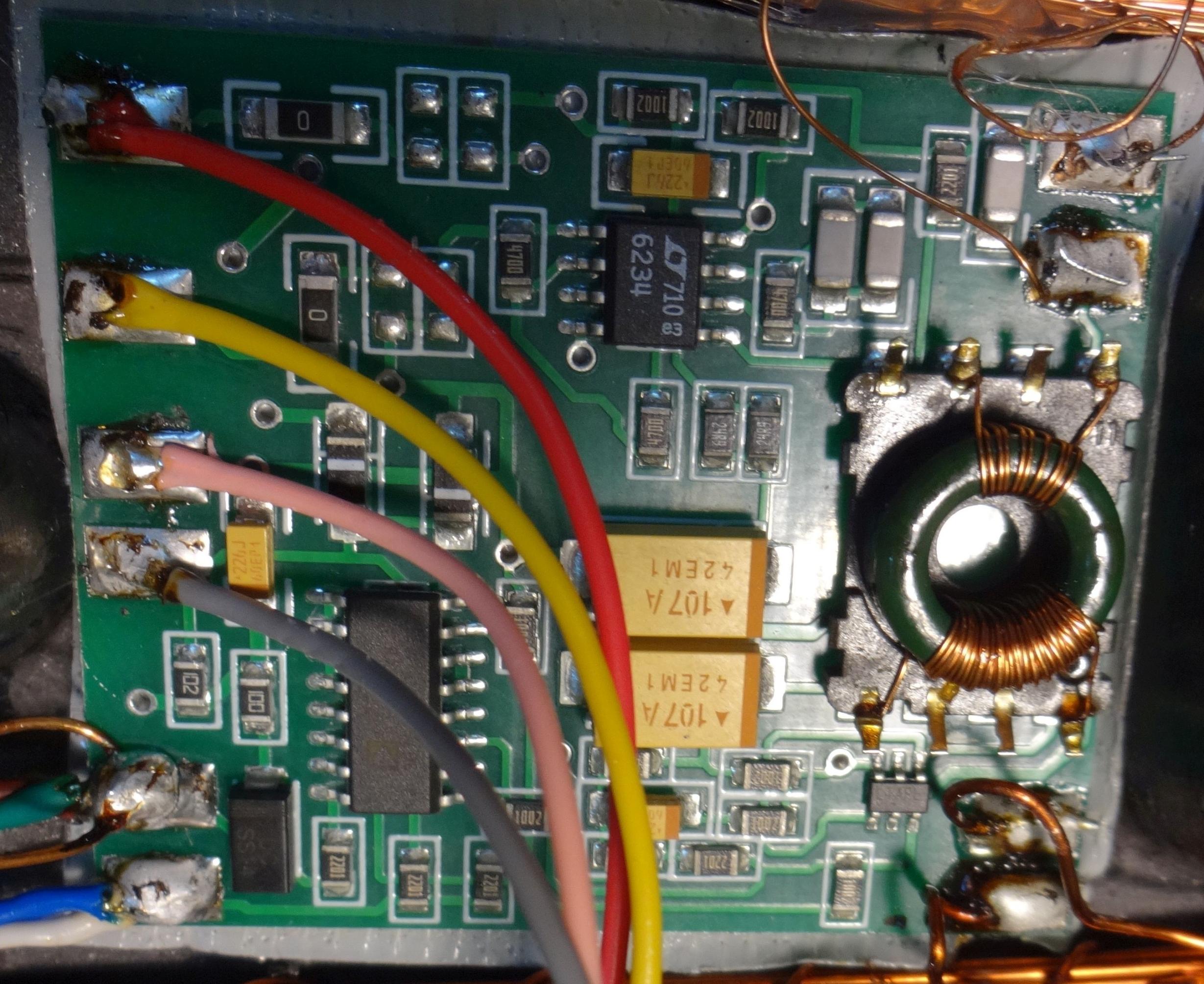

                  I should also mention that this specific part of the architecture is inspired by commercial coils from the Polish manufacturer Rutus. In their designs, they implement phase and amplitude balancing using an AD5242 digital potentiometer.
                  For the Spectral-G4, I’ve decided to evolve this concept:
                  • Instead of a digital pot, I am using the MCU’s DAC channels.
                  • This allows for much finer granularity and faster dynamic adjustments during the nulling loop, which is essential when trying to maintain a stable null in varying soil conditions.
                  I’ve attached the corrected Schematic v1.1 and a photo of the original Rutus coil internal board for reference, showing their implementation of the digital pot balancing.

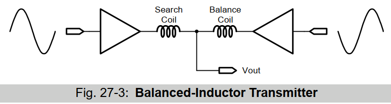

                    I tried several approaches. I'll roughly describe them but without much detail because I may consider one for a future product.
                    One way is to use a small series resistor to get the TX current waveform, dynamically scale this signal, and then apply it either to the preamp or to the RX coil directly. A limitation of this method is that it works for a sinusoidal TX but not for a square wave TX.
                    Another way is to use differential bucking coils and dynamically drive them based on an error signal. This works with any TX waveform.
                    Another yet is to use a differential coil system like this
                    and dynamically adjust the balance drive to minimize Vout.

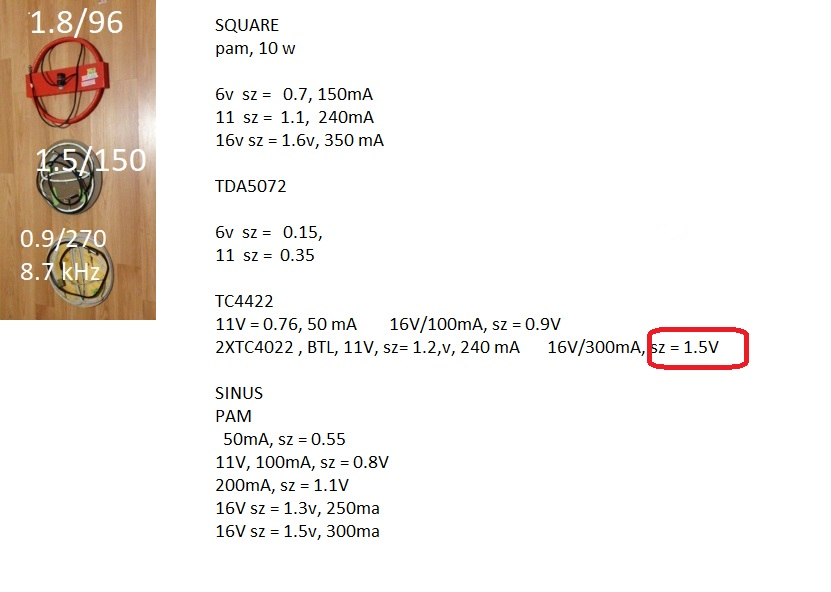

                      How is it progressing?
                        You can use BTL amp, however from my experience BTL is giving double coil voltage but draws 5 times more current compared to a single amplifier.
                        some of my testings

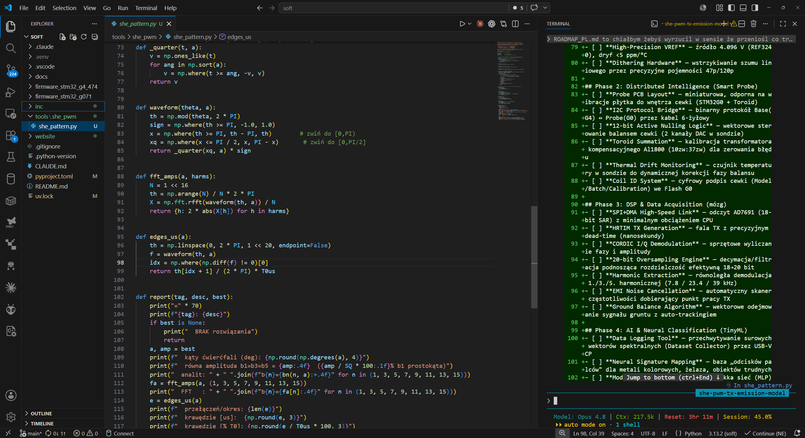

                            Hi all,
                            Quick progress update - I'm officially starting on the software side of the Spectral-G4 (my multi-frequency VLF project with an AI "spectral fingerprint" discriminator). Hardware decisions are locked, so now it's time to write code.
                            --- The toolchain ---
                            I'm keeping it simple and modern. VS Code + the official STM32 VS Code extension is my whole IDE/debug setup for the STM32G474 (base) and STM32G071 (smart probe in the coil). The build system is CMake/Make driven by the extension (gcc-arm-none-eabi), flashing straight from the editor - no heavyweight IDE needed. For the number-crunching and signal design I use Python with numpy (and scipy for the solver), which lets me design and verify the DSP and the TX waveform on the PC *before* a single line goes onto the MCU. Nice separation: Python decides the math, the MCU just executes it.
                            --- Starting from the transmitter ---
                            Like any TX-first build, the first real question is: what exactly do we push into the coil? I don't want a plain 50% square wave - its harmonics are locked at 1, 1/3, 1/5, so the higher frequencies come out weak and you can't control them. I want THREE usable frequencies at the same time, all at comparable power, so the fingerprint has good dynamic range across the band.
                            The frequencies are odd harmonics of a base f0:
                            f0 = 7812.5 Hz (chosen as 250 kSPS / 32, so it grid-locks to the ADC)
                            -> 7.8125 kHz (1st), 23.4375 kHz (3rd), 39.0625 kHz (5th)
                            To make those three come out at EQUAL power from an H-bridge, I shape the switching pattern (SHE-PWM - selective harmonic shaping). I let numpy/scipy solve for the switching angles that force |b1| = |b3| = |b5| and kill the nearest contaminant (the 7th). The result I settled on (quarter-wave symmetric, so odd harmonics only):
                            switching angles: 51.47 deg / 64.62 deg / 85.33 deg
                            b1 = b3 = b5 = 0.5714 (equal - exactly what we want)
                            7th harmonic = 0 (nulled)
                            I cross-checked the analytic Fourier amplitudes against a brute-force FFT of the synthesized waveform - they agree to 4 decimals, so I trust it. This pattern becomes the HRTIM compare table on the G4; the timer just replays the edges (plus dead-time for the bridge).
                            One thing the math made obvious: hard-nulling MORE harmonics (7/9/11) is actually counterproductive - the energy just relocates into even higher harmonics, some right up near Nyquist. So killing only the 7th and letting the RX coil's bandwidth roll off the rest is the sweet spot. Lovely when the numbers tell you where to stop.

                            More soon - next up is getting the HRTIM pattern out on real pins and scoping the spectrum to confirm the three harmonics land at equal power.
