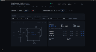

              On the software side, today I added a new feature to MDS - TX Bench - shipped in v0.12.0-beta. It's a calculator / sandbox that lets you enter the real coil parameters (inductance and DC resistance), the bridge supply voltage and an optional series capacitor. It then draws the full complementary H-bridge and computes the coil current peak-to-peak, peak and RMS directly from the actual switched Vbus waveform, with a per-harmonic breakdown for multi-frequency drive. In practice it lets me size the transmitter, compare single vs multi-frequency operation, try different frequency ratios (e.g. the Equinox 1:3:15), and check the current and thermal headroom before ever touching the hardware.

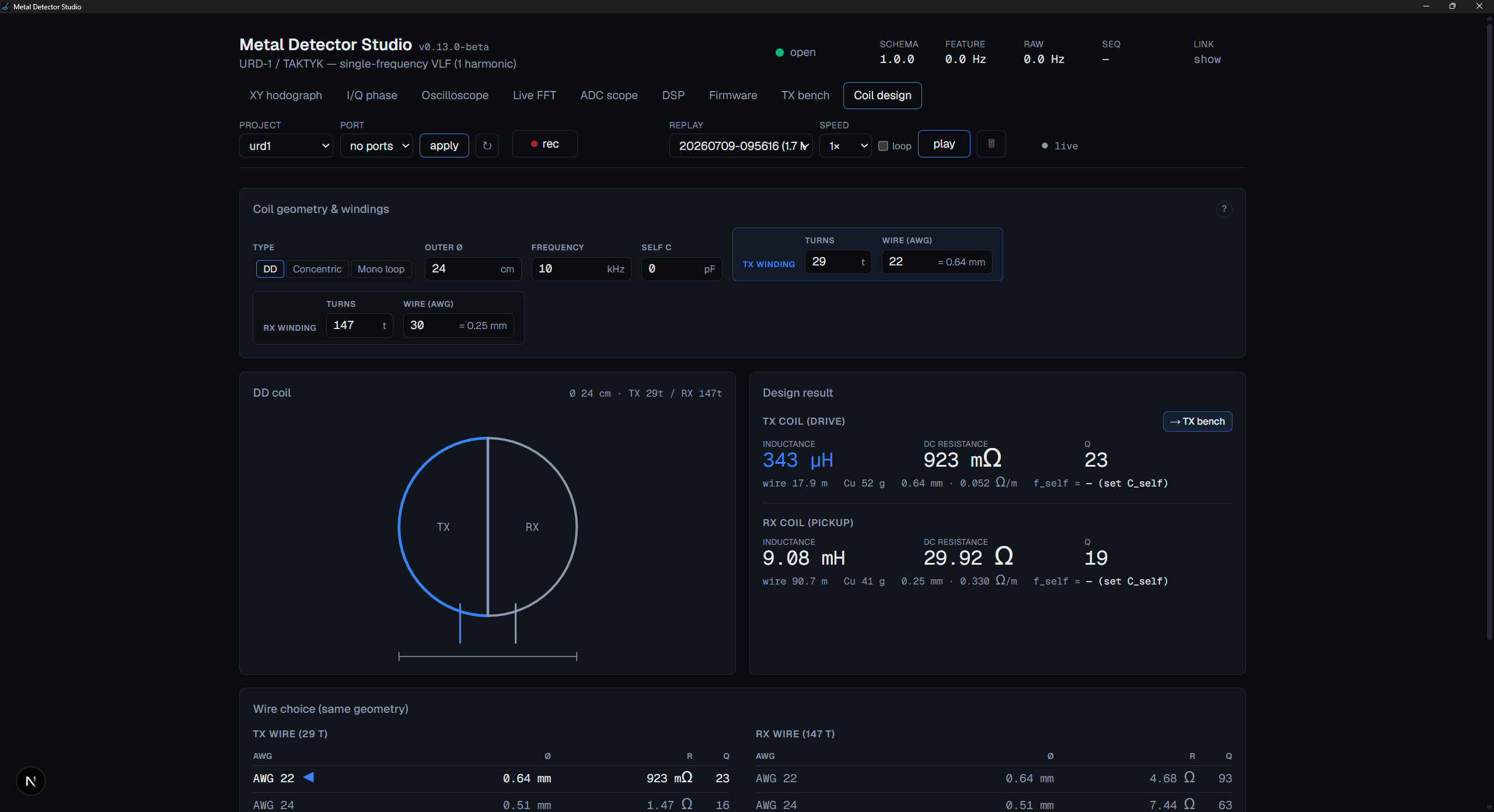

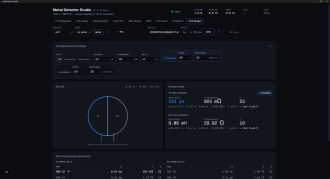

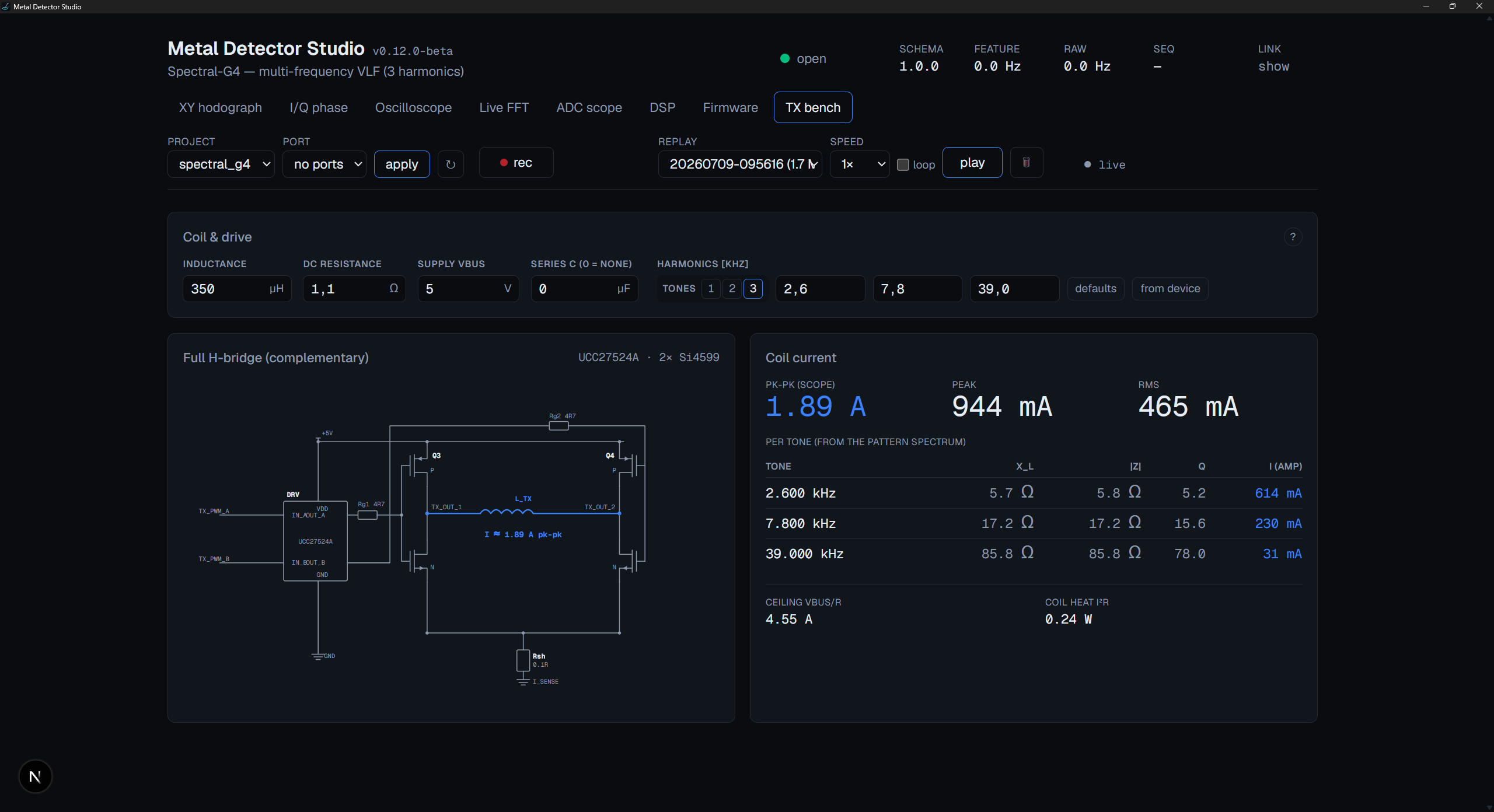

                Metal Detector Studio - v0.13.0-beta out.
                A quick update on my bench/lab suite for developing VLF detectors. What's new in this beta:
                - Coil design tab - design a search coil before you wind it: DD / concentric / mono, both TX and RX windings (each with its own turns and wire gauge), and it gives you inductance, DC resistance, Q, wire length and self-resonance, plus a per-winding wire-gauge trade-off table. A D-shaped leg has no closed-form inductance, so it uses an equal-enclosed-area circle approximate (~ 20 %), the wound coil still gets measured. It hands the coil's L/R straight to the TX bench.
                - TX bench - enter the coil L/R/supply and it draws the full complementary H-bridge and computes the coil current (pk-pk / peak / RMS, per-harmonic) from the actual switched waveform. New: a measured-vs-model overlay punch in the tone currents from a scope FFT of the shunt and it back-solves your real per-tone drive weighting.
                - Filter Lab - synced to my firmware's current DSP (multi-freq motion band-pass with the REACT alpha table, the reworked fast channel, etc.); impulse + frequency response with the actual coefficients.
                Still a work-in-progress beta, but the design side is coming together nicely. Cheers.

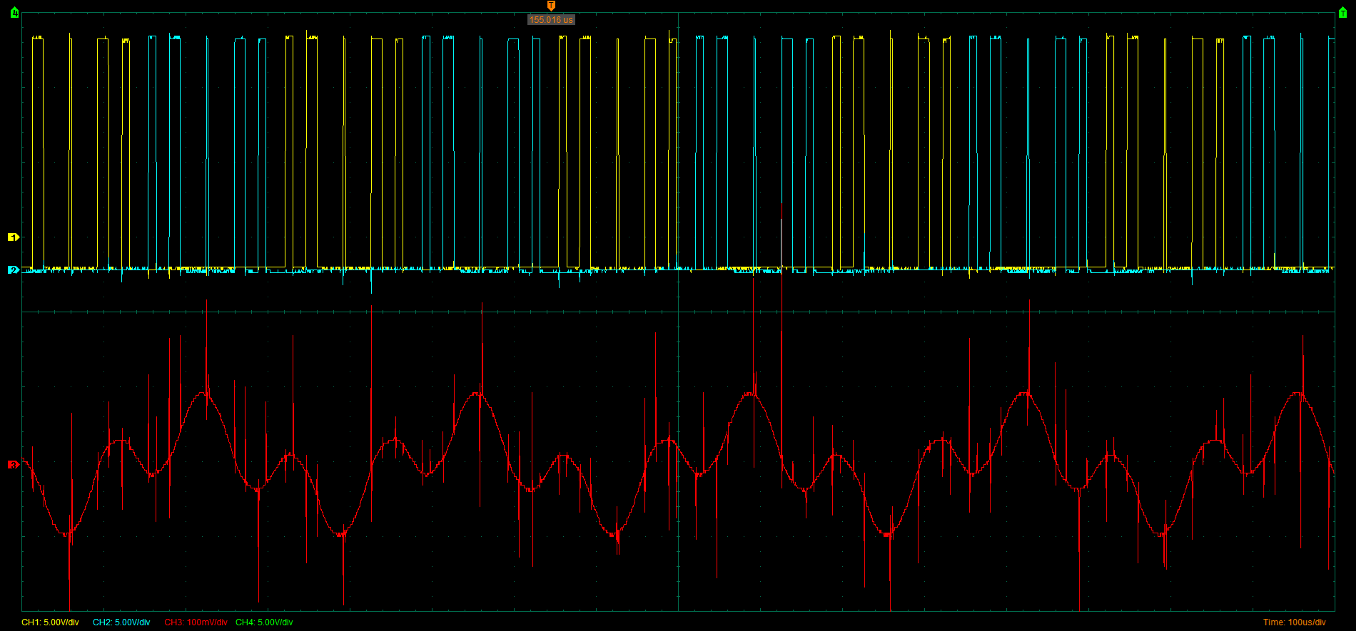

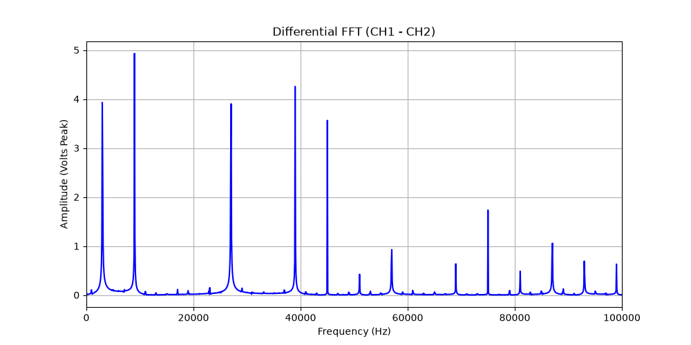

                    I'm working on a MF design with a similar tx to yours. I've chosen different frequencies to start off with - I've gone for 3 kHz, 9 kHz and 27 kHz - using SHE PWM to generate them, ie 3 kHz fundamental and 3rd and 9th harmonics. 5th, 7th and 11th harmonics are nulled. I'm using a full H-bridge to drive the Tx coil. The FFT is from the left and right ends of the bridge (ie across the Tx coil):
                    Click image for larger version  Name:	Differential FFT.png Views:	0 Size:	31.6 KB ID:	450757
                    I'm also using a STM32G474 mcu, but I haven't use the HRTIM. I would be interested in how you have configured the HRTIM to get high resolution with such a low fundamental frequency (because I couldn't figure out how to do it :-( ).
                    The problem I'm currently trying to overcome is the large noise on the Rx. It looks like switching noise because it coincides pretty much exactly with the Tx signal:
                    Click image for larger version  Name:	Rx noise.png Views:	0 Size:	39.2 KB ID:	450758
                    CH1 and CH2 (yellow and teal) traces are left and right sides of the bridge and CH3 (red) is off the Rx coil.

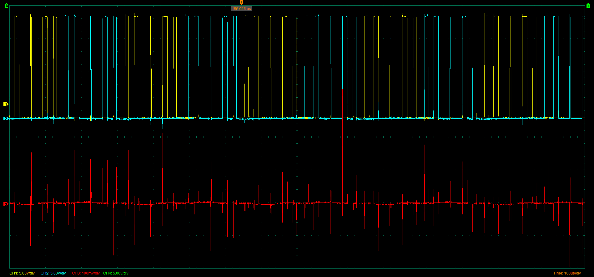

                    And if I present a target to the coil:
                    Click image for larger version  Name:	Rx noise with target.png Views:	0 Size:	45.0 KB ID:	450759
                    So if I can get rid of the switching noise I think it looks pretty good. If anyone has any ideas how to do that I'd be grateful for them.

                      Have you tried changing the Dead Time in the timer settings ? maybe that would help.
                      • #41
                        Hi Repwoc and Marchel,
                        Marchel is spot on with the dead-time suggestion. If the dead time is too short, you get shoot-through currents in the H-bridge, causing large current spikes from the supply. These spikes easily couple into the RX path as broadband noise.
                        Besides optimizing the dead time, I would also try:
                        - Slowing down the MOSFET edges with the gate resistors, and doing it asymmetrically: a larger resistor (e.g. 22 Ω) for turn-ON, with an anti-parallel diode so turn-OFF stays fast. This reduces dV/dt (less coupled noise) without increasing the shoot-through risk.
                        - An RC snubber across the bridge or the TX coil to damp high-frequency ringing.
                        - Reviewing the PCB layout and current return paths. Common impedance coupling between the H-bridge and the analog front-end is very often the real culprit with this type of noise.
                        One more thought that may reframe the problem: since your noise is exactly synchronous with the TX, after synchronous demodulation it does not look like noise at all. It becomes a constant offset vector in I/Q. If it is stable, your nulling / baseline subtraction removes it entirely. What actually hurts you is its jitter (another reason why clean dead-time and stable switching instants matter) and its thermal drift. It also helps to sync the ADC sampling to the TX grid, so the sampling instants never land on the switching edges.
                        Regarding HRTIM at a 3 kHz fundamental:
                        The period register is 16-bit, so you cannot keep the full DLL high-resolution mode (184 ps, x32) over a 333 µs period; that would need about 1.8 M counts. But you do not need it. At CKPSC = div1 the counter tick is 1/170 MHz = 5.88 ns, and your 3 kHz period is 56,667 counts, which fits in 16 bits with a timing granularity of about 1/57,000 of the period. For SHE-PWM that is overkill in the good direction. The dead-time generator has its own prescaler, so dead-time granularity stays fine independently.
                        For the pulse pattern itself:
                        - If your SHE pattern has only a few switching angles (up to 4 edges per output per period), you can do it with no DMA at all: each timer haseset crossbar.
                        - For more edges, use the feature the reference manual calls Burst DMA (RM0440, HRTIM chapter). You pre-calculate the switching instants pare registers from that table onevery Repetition/Update event. With preload enabled, the new values are taken over glitch-free at the period boundary.
                        In pseudocode:
                        Code:
                        /* fHRTIM = 170 MHz, CKPSC = div1 -> 1 tick = 5.88 ns */
                        #define PERIOD_TICKS (170000000 / 3000) /* 56667 ticks = 333.3 us */
                        /* SHE switching instants precomputed offline (in ticks),
                        * grouped per period; each group reloads CMP1..CMP4 */
                        static const uint16_t she_table[N_GROUPS][4] = {
                            { 4200, 11300, 17800, 24100 }, /* edge set for segment 1 */
                            { 32500, 39100, 45600, 52200 }, /* edge set for segment 2 */
                        void tx_init(void)
                            /* Timer A: period, preload, update on repetition event */
                            hrtim_set_period(TIMER_A, PERIOD_TICKS);
                            hrtim_enable_preload(TIMER_A, UPDATE_ON_REPETITION);
                            hrtim_set_deadtime(TIMER_A, rising_ns(120), falling_ns(120));
                            /* output waveform = crossbar events:
                            * TA1: SET on CMP1, RESET on CMP2
                            * TA2: complementary with dead-time inserted by hardware */
                            hrtim_output_set_source(TA1, SET_ON_CMP1, RST_ON_CMP2);
                            /* Burst DMA: register list = {CMP1, CMP2, CMP3, CMP4};
                            * circular DMA feeds the list from she_table[] on every
                            * update event, so the pattern plays with zero CPU load */
                            hrtim_burst_dma_config(TIMER_A, REGS(CMP1, CMP2, CMP3, CMP4));
                            dma_start_circular(she_table, HRTIM_BDMADR,
                            N_GROUPS * 4, TRIGGER_TIMA_UPDATE);
                            hrtim_outputs_enable(TA1 | TA2);
                            hrtim_start(TIMER_A);
                        From the timer's point of view it just executes a sequence of SET/CLEAR events at precisely defined moments. If the whole pattern repeats every period, the table stays small and DMA runs in circular mode, so the CPU does nothing during transmission.
                        That is exactly the route I am taking on the Spectral-G4: right now I have the baseline HRTIM config running (complementary pair with dead-time at f0 = 7.8125 kHz), the SHE switching angles are computed offline (equal power in the 1st/3rd/5th harmonic comes from the pulse pattern, not from exotic frequency choices), and Burst DMA playback of that pattern is the next step once the power stage is on the bench.
                        Hope this helps!​

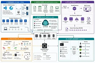

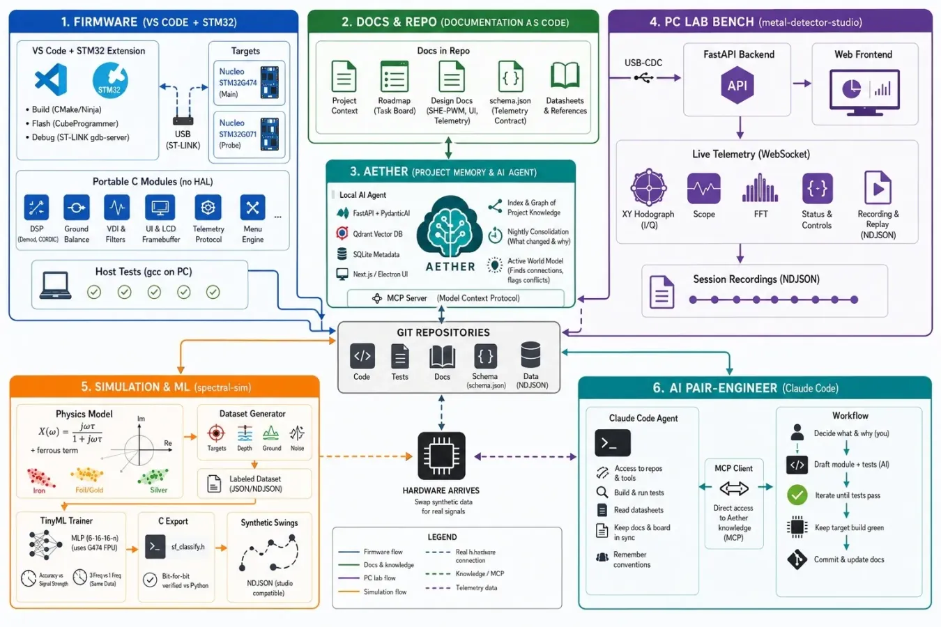

                          I wanted to show how I actually work on this project day to day, because the workflow itself might be more interesting to some of you than the schematics.
                          1. Firmware in VS Code with the STM32 extension
                          The entire firmware (STM32G474 main board + STM32G071 probe) lives in a single Git repository as CubeMX/CMake projects. I work in VS Code with the STM32 extension and STM32CubeCLT (arm-gcc, CMake/Ninja, CubeProgrammer, ST-LINK gdb-server). One shortcut builds, another flashes the Nucleo. No proprietary IDE.
                          The most important habit: every DSP/UI module is written as portable C with no HAL dependency (demodulation, CORDIC, ground balance, VDI, mode filters, menu engine, LCD framebuffer, telemetry protocol). Every module has a small host test compiled with plain GCC on the PC. This allowed the entire digital pipeline (synthetic samples -> demod -> ground balance -> VDI -> display/audio/telemetry) to be written and verified before the analog board even existed. When the hardware arrives, bring-up is simply connecting proven modules to the pins.
                          2. Documentation as part of the repository
                          Decisions live next to the code: a project context file, a single task board with the roadmap, and design documents (SHE-PWM switching pattern with calculated switching angles, telemetry schema, UI concept, datasheets). The telemetry contract is a schema.json file in the repository. The PC side builds its parser from it, so firmware protocol changes never get out of sync with the tooling.
                          3. Aether, the project memory
                          A separate project of my own: a local, private AI agent (FastAPI + PydanticAI, Qdrant vector memory + SQLite, Next.js/Electron frontend) that serves as the brain of the project's documentation. All project documents are stored in its knowledge base and indexed not as flat RAG vectors but as a graph of connected concepts. It also has two capabilities that a typical chatbot does not: a nightly cycle that consolidates the day's logs and files after work and greets me in the morning with a brief saying "what was decided yesterday and what follows from it", and an active world model that connects facts in the background and proactively suggests observations ("this ADC decision conflicts with what you assumed for the sampling strategy"). Nothing ever leaves my local machine.
                          The best part is the integration: Aether exposes an MCP (Model Context Protocol) server, so the coding agent in VS Code has direct access to the same long-term knowledge. A question like "why did we reject delta-sigma in favor of SAR six months ago?" gets an answer immediately.
                          4. Metal-detector-studio (MDS), the PC lab bench
                          A separate open project: a FastAPI backend that communicates with the detector over USB-CDC, streams telemetry over WebSockets, and provides an XY hodograph (I/Q vector per harmonic), a virtual oscilloscope, live FFT, and session recording with replay. Every recording can later be replayed exactly as if the device were connected live. This is where ground balance and discrimination are tuned while looking at the actual vectors.
                          5. Spectral-sim, physics before hardware
                          The newest component. A physics-based simulator where every target is represented by a single time constant responder X(w) = jwt/(1+jwt), with a magnetic term for iron. This simple grey-box model already reproduces the classic VLF picture (iron on the opposite phase side, gold overlapping foil, pull tabs overlapping mid-value coins) across my three harmonics: 7.8, 23.4, and 39 kHz.
                          The point of all this is that when the analog board finally reaches the bench, I simply replace synthetic data with measured signatures, while the entire pipeline (dataset -> training -> C export -> validation in Studio) has already been exercised end to end.
                          6. Working with an AI pair engineer
                          I do all of this together with Claude Code (Anthropic's coding agent) running in the terminal and VS Code. It has direct access to the repositories, builds and runs tests on its own, reads datasheets from the repository, keeps the task board and documentation synchronized with the code, and through MCP accesses Aether's memory, so it knows the project's decision history, not just the current code. A typical session starts with me deciding the topology, frequencies, and engineering trade-offs. It drafts the module together with its host test, we iterate until the test passes and the target build stays green, and then it writes the commit. It catches my mistakes in DSP corner cases, and I catch its occasional overconfidence, which makes for a fair partnership. The multi-frequency demodulator, menu engine, telemetry protocol, and the entire simulator were built this way, each verified by tests rather than trust.
                          None of this replaces bench work. A metal detector is ultimately won or lost in the analog front end and the coil. But it does mean that by the time I pick up the soldering iron, the software is no longer a pile of TODOs, but a tested pipeline waiting for real signals.
                          Happy to answer questions about any part of this workflow.
