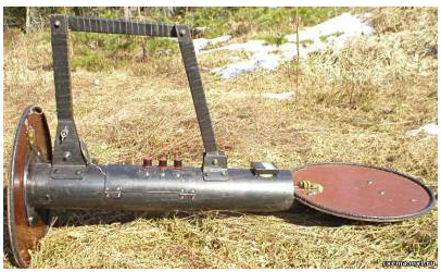

          My large 8m coil setup: A 60cm iron target can be detected at 1.5 meters depth.
          TR locator can do better

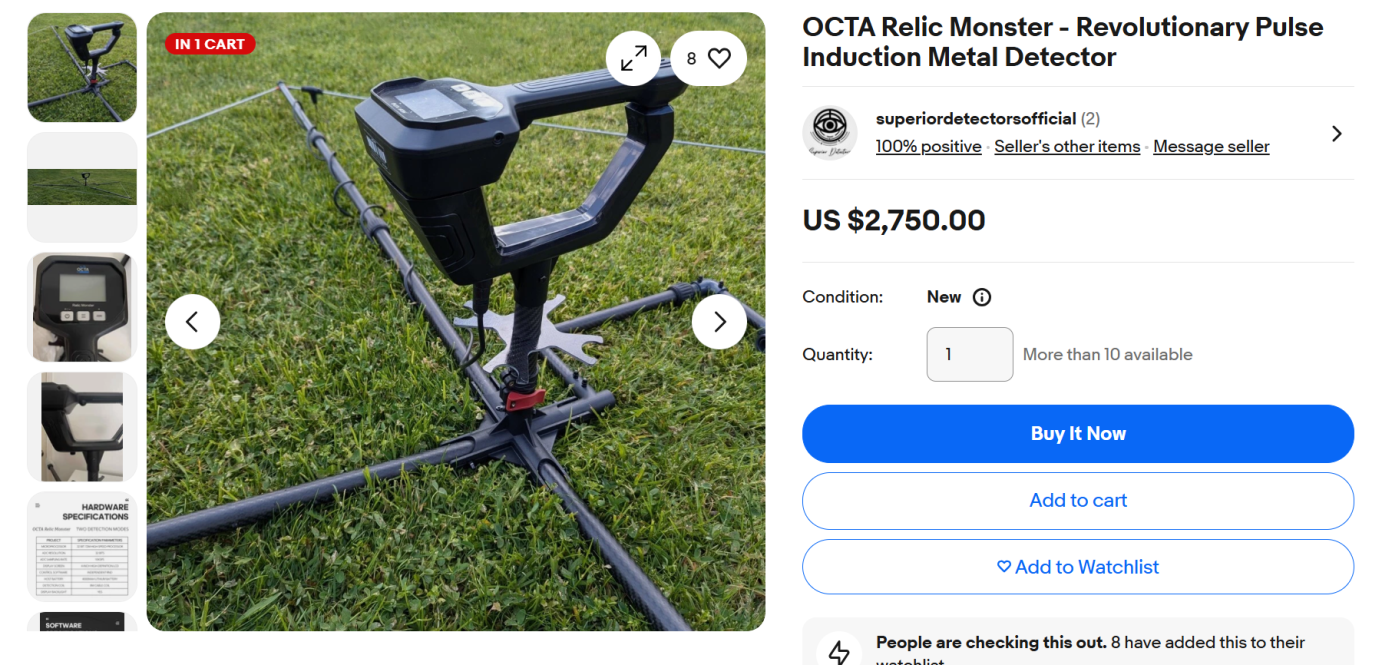

                What is with this one? Some treasure hunters in Thailand use it. They say it can detect a car at 7 meter distance. The screenshot left is from eBay US today.
                Click image for larger version  Name:	OCTA Relic Monster.png Views:	3 Size:	1.05 MB ID:	447489 ​ Click image for larger version  Name:	OCTA Relic Monster(2).webp Views:	0 Size:	19.2 KB ID:	447491
                  This is the Heisong 6000 (also known internationally as the OCTA Relic Monster / HS-6000 AI), a pulse induction metal detector manufactured in China.

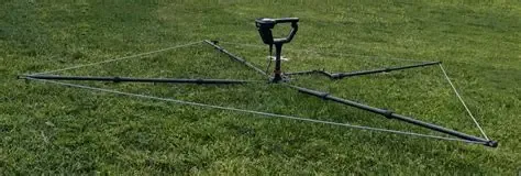

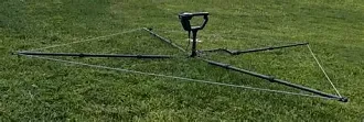

                    Hi, this is my DIY pulse induction metal detector.
                    It can steadily and accurately locate car and small car-sized metal objects within 7 meters.
                    It is more stable and offers deeper detection than the Heisong HS-6000 pulse metal detector.
                    This machine has some obvious drawbacks.
                    Its biggest weakness is poor stability.
                    It gives frequent false alarms in cold winter weather, on damp wet ground, and on rough, uneven terrain.
                    It is highly sensitive to iron and large metal objects,
                    but not very sensitive to gold, silver and copper targets.
                    I will post photos below. Video uploads are not allowed on this forum, so I cannot share real demonstration videos.​
                      This requires very low frequencies, the TR locator operates at 2 kHz - the lowest frequency I have ever seen.
