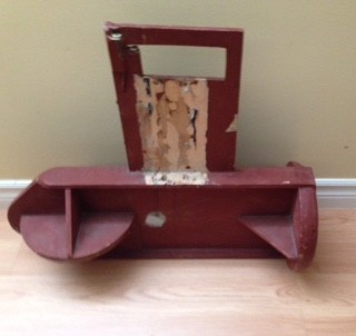

                          This is my first detector, built a loooong time ago. It could detect a nail from 60 cm away, so placing a conveyor belt between the coils will solve the problem.
