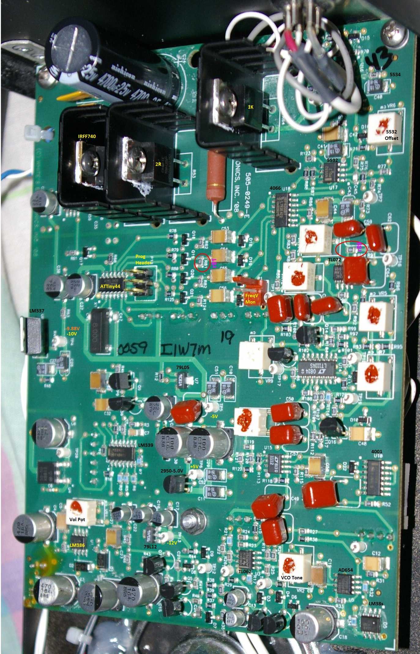

    I got a hold of a broken TDI and it did not come with a battery. When I run it from a powersupply at 12V only the red light comes on. I need 15V to get all 3 Led's on.
    The wavy threshold is more stable at 15V also. I was going to use 3 3.7V lithium batteries to power it as I thought 16V was max. The big cap for pulsing is 25V.
    Am I OK with 4 Lithium batterys (16.8V Max)?
    Hmm It looks like from the manual 14.4V / 4 = 3.6V and it talks about charging Lithiums. I thought the Pro had the higher voltage...
Name:	Pulse Scan TDI Test Points.jpg

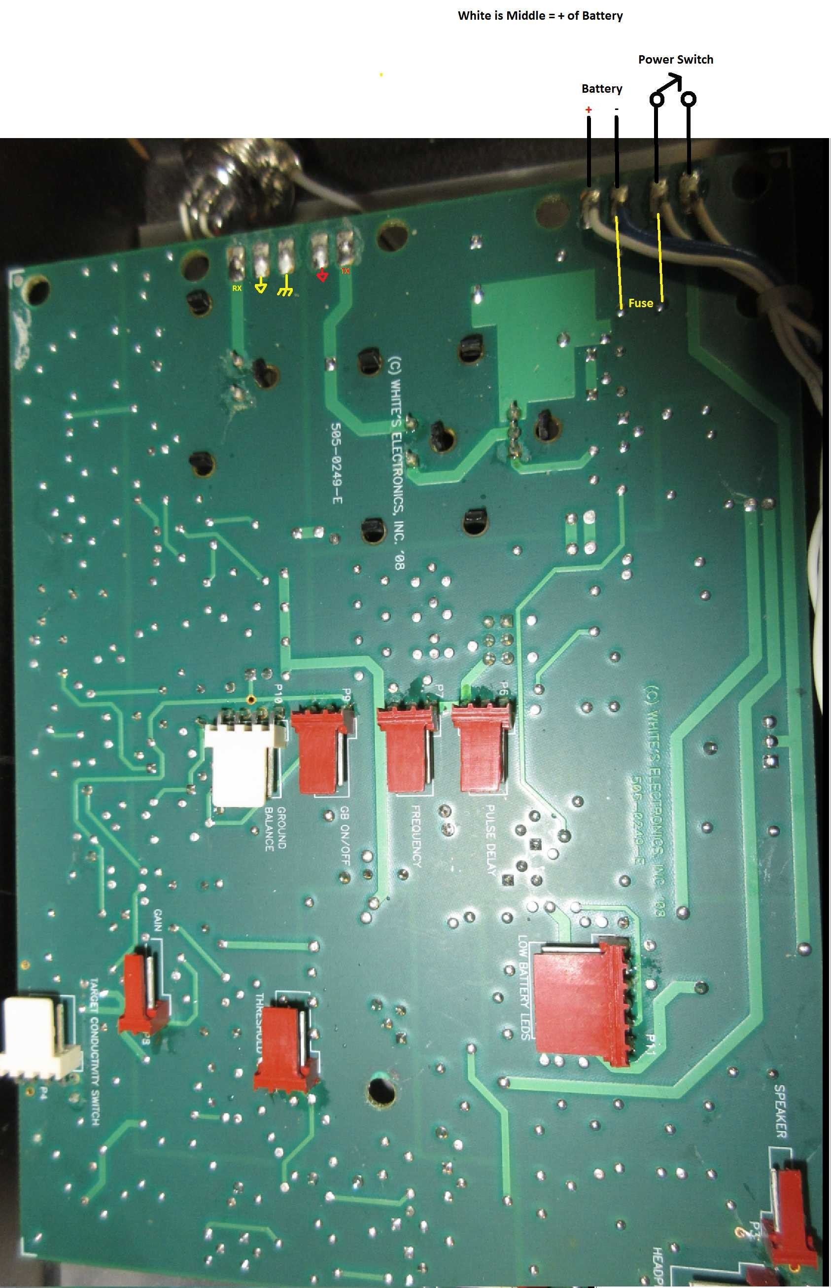

ID:	451167 Here's a couple of Pics I used to troubleshoot this unit; Click image for larger version  Name:	Pulse Scan TDI Coil and PowerIn.jpg Views:	0 Size:	481.8 KB ID:	451164
        It runs on a nominal 14.4V lithium pack, which usually charge up to 16.8V. I think somewhere there is an18V max component but don't recall which one.
          Ya, Thanks Carl. I had a 3 cell pack for it but luckily I bought an extra one so I'm modding it to 4.

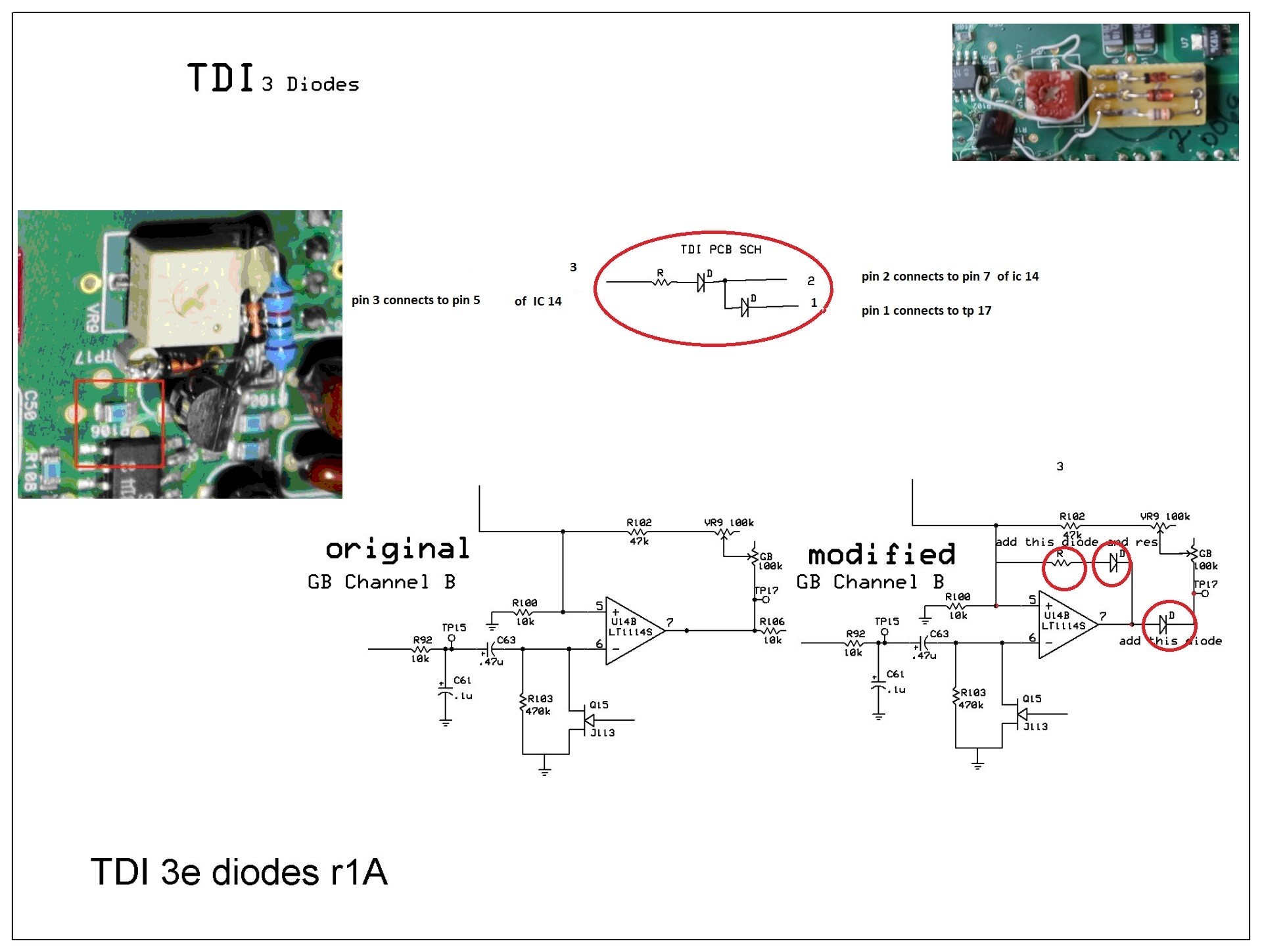

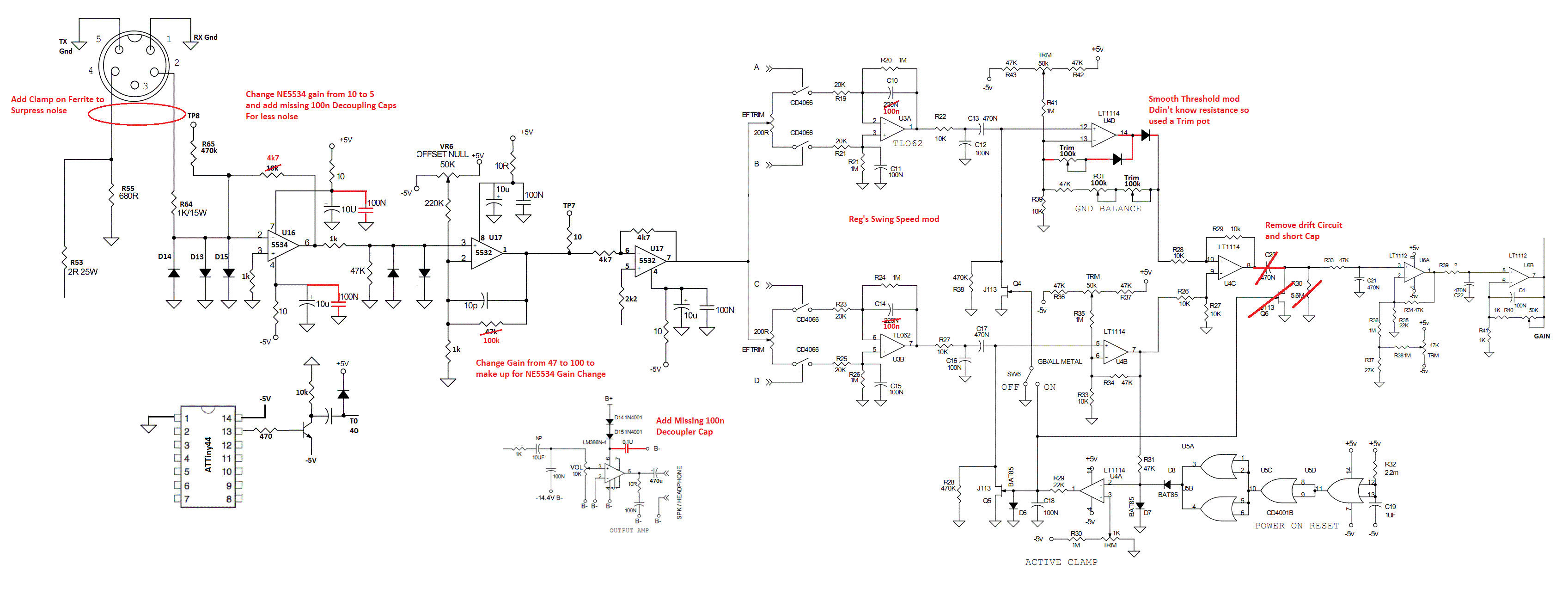

            Anyone know the resistor value for this mod? It looks like 2.7K or 27K but the other picture looks like 75K.
            It smooths out the GB channel by reducing the gain for certain size signals I think.
            Reg got this added to both channels on the SL then removed it from the signal channel later. Click image for larger version

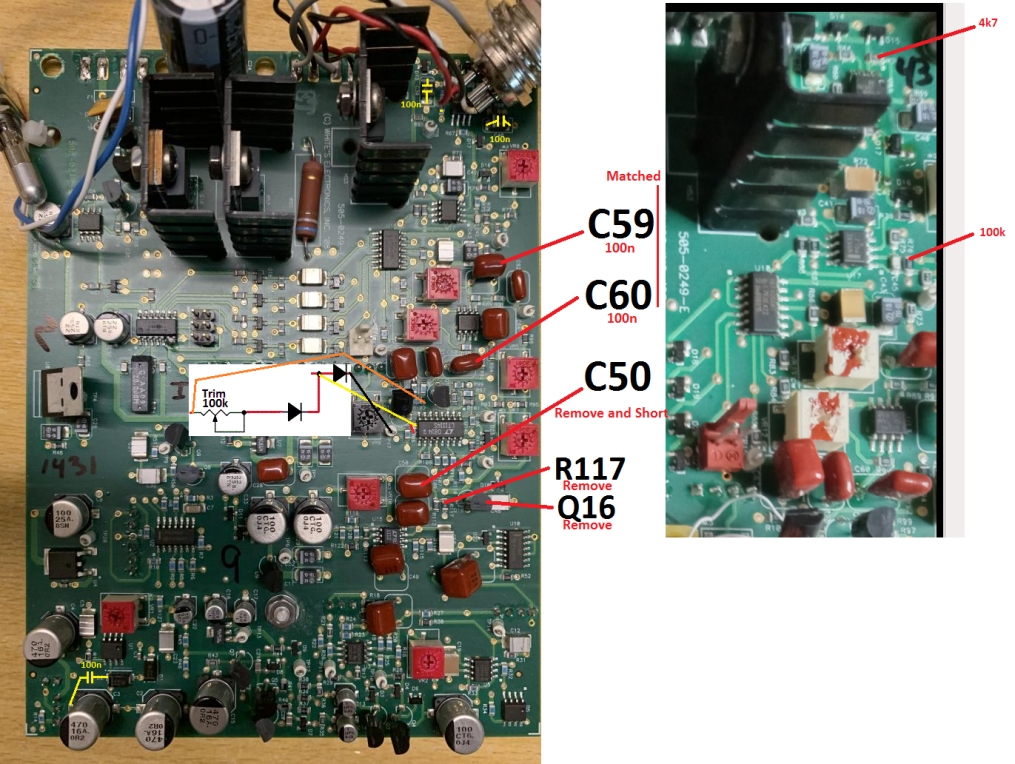

              Here's docs for all the mods I did; Click image for larger version
Name:	My Pre And Demod Mods.gif
ID:	451206 Click image for larger version
Name:	My Mods PulseScan.png

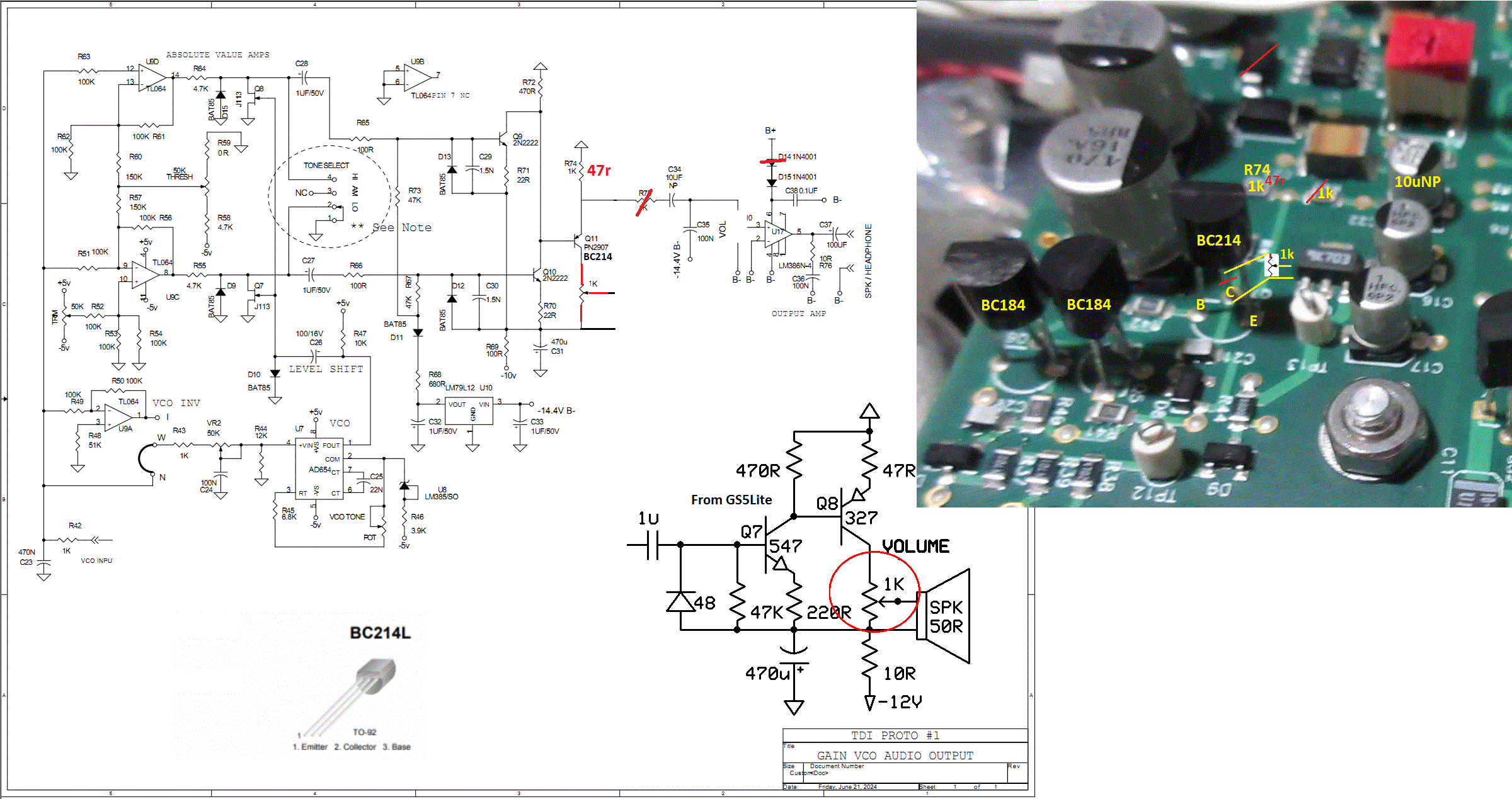

                Some people have said the LM386 adds to the warble tone and using a two transistor amp makes it work much better with a smooth threshold. In looking at the proto scheme and the board the 2 transistor circuit is already on board. So we can just disable the LM386 and take our audio from the last transistor. Click image for larger version

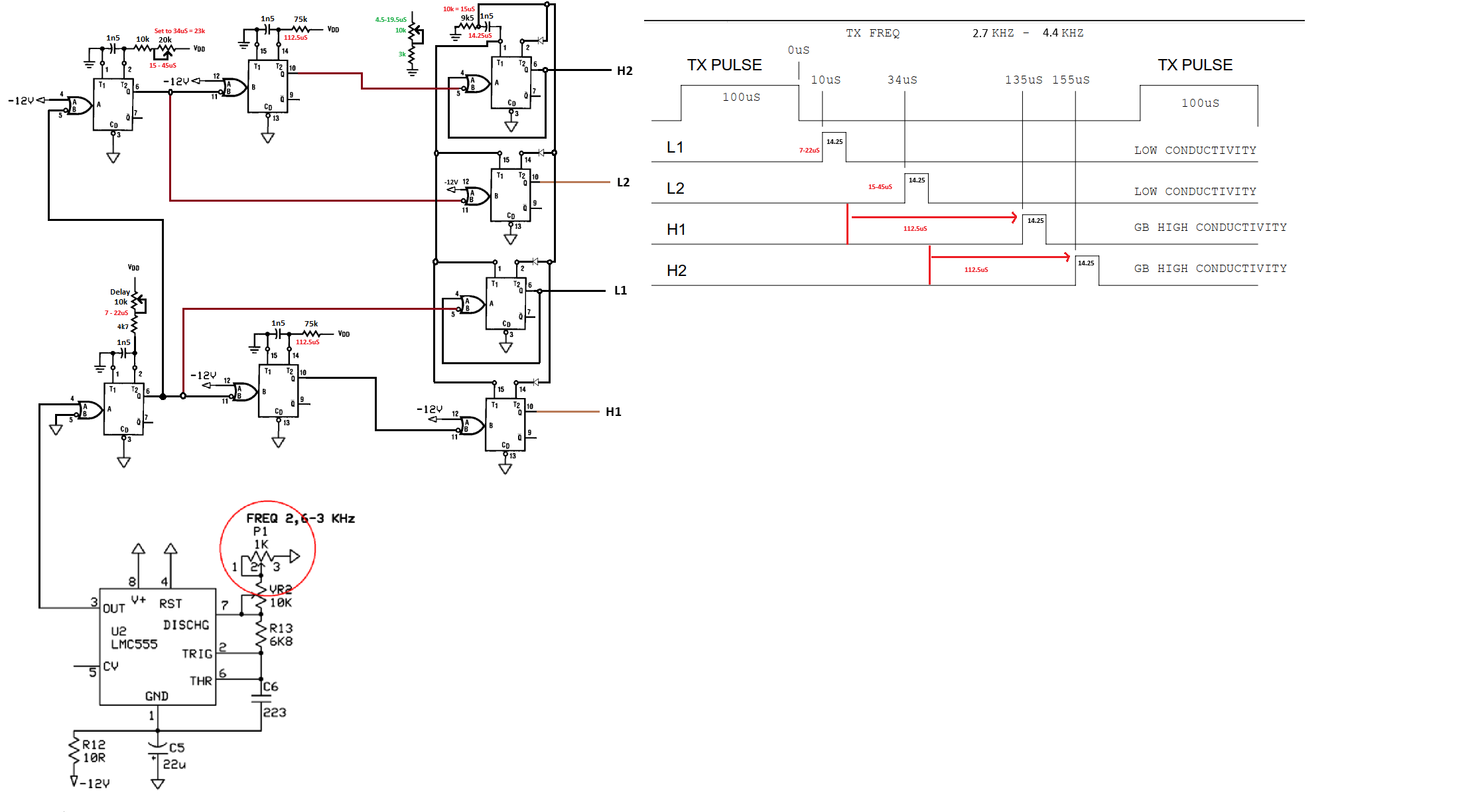

                  Here's what the clock looks like;

                    Thank you Silver Dollar.. we could mod blind squirrel pulse too and change each width individually
                      Hi Silver Dollar
                      The changes you made are interesting.
                      Did you test it in practice?​
                        I have not tested yet. I just got my batteries in and have to build a pack for it.

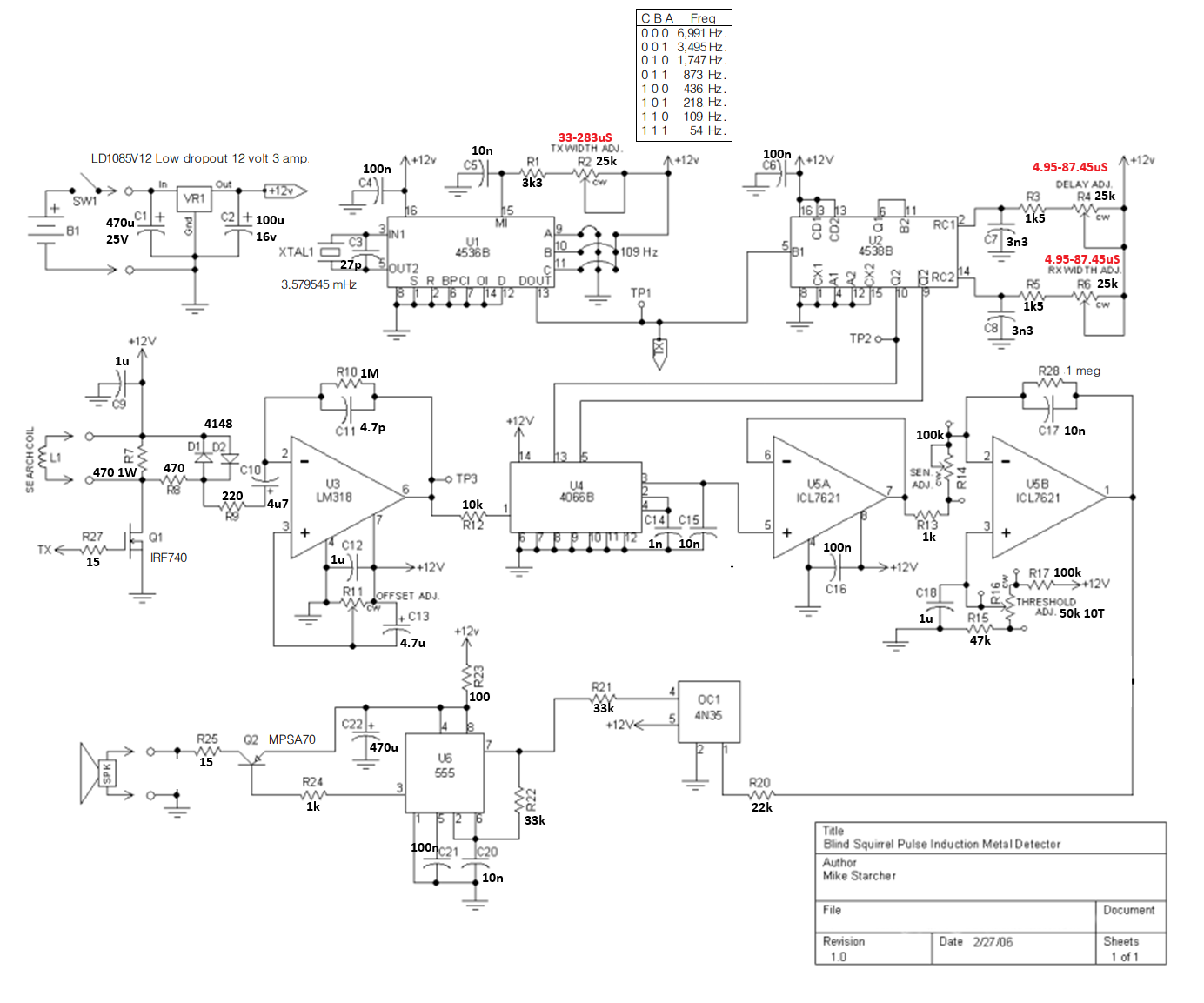

                          On Blind Squirrel it already has adjustable Tx, Delay and RX Pulse width; Click image for larger version
Name:	Blind Squirrel Scheme.png
                            possible, but need some adaptation for dual supply etc
