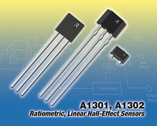

          A1301 - Continuous-Time Ratiometric Linear Hall Effect Sensor ICs
          I will get one this Monday from Digikey and I want to put it into my SurfPI coil as pinpointer or probably may be use it as substitute of RX coil for discrimination.
          With proper orientation this small IC probably can be nulled for magnetic field from transmit coil just like two box metal detector balanced on 90 degrees between TX and RX.
          It has PREAMPLIFIER inside. Also it sensing changes in magnetic fields up to 20 KHZ frequency. Looks perfect for the solution.
          http://www.allegromicro.com/~/media/Files/Datasheets/A1301-2-Datasheet.ashx
          The A1301 and A1302 are continuous-time, ratiometric, linear
          Hall-effect sensor ICs. They are optimized to accurately provide
          a voltage output that is proportional to an applied magnetic
          field. These devices have a quiescent output voltage that is
          50% of the supply voltage. Two output sensitivity options
          are provided: 2.5 mV/G typical for the A1301, and 1.3 mV/G
          typical for the A1302.
          The Hall-effect integrated circuit included in each device
          includes a Hall circuit, a linear amplifier, and a CMOS Class A
          output structure. Integrating the Hall circuit and the amplifier
          on a single chip minimizes many of the problems normally
          associated with low voltage level analog signals.
          High precision in output levels is obtained by internal gain
          and offset trim adjustments made at end-of-line during the
          manufacturing process.

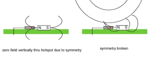

              Such sensors, like magnetometers can measure very small changes in magnetic field with "symmetry broken" method:

                  Sensor shows S and N magnetic field strength and polarity. Results depend on orientation. If you bring magnet to the edge of sensor it will show nothing. Branded side and back side of sensor gives maximum value and opposite outcomes. If you set magnet near edge and put sensor precisely into symmetry (as on picture) you can "balance" it to symmetry to not let it to see the magnet at all. Then if iron chunk goes to the area it will change symmetry of magnetic field and sensor will show few millivolts or microvolts shift you need to amplify.
                  With sinusoidal or rectangular signal from the coil there are more ways to get target detected even for color metal.

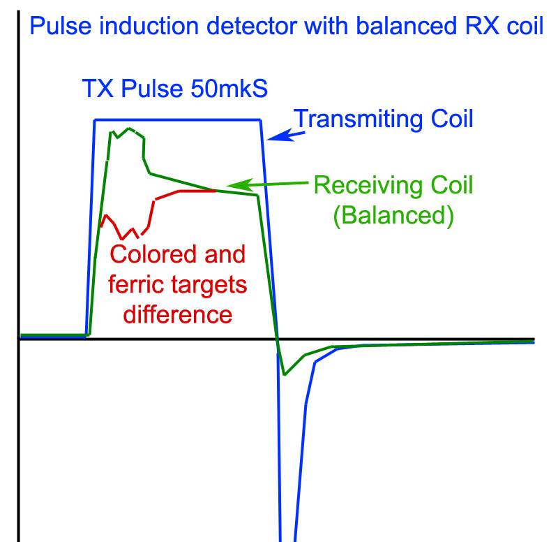

                      If you build PI detector with balanced RX coil (like all VLF detectors using) you will see on the oscilloscope how ferric / color metal targets changing reaction in RX coil in the beginning of TX pulse. I have tried it on the bench and hearing difference between US 25 cents and beer bottle cap from 6-8 inches.

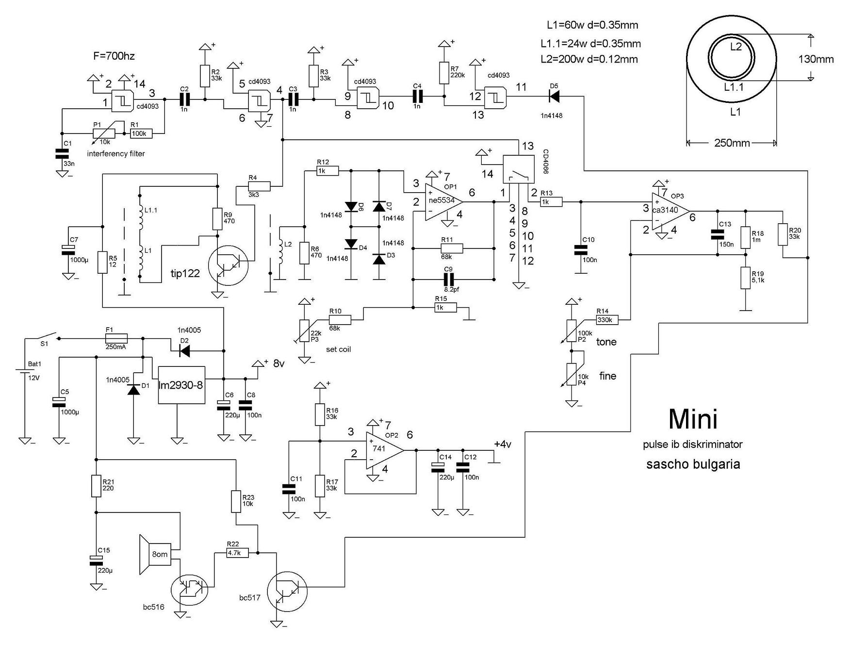

                      I got the idea from Sascho Bulgaria "PULSE IB DISCRIMINATOR".
Name:	PULSE IB DISCRIMINATOR.jpg

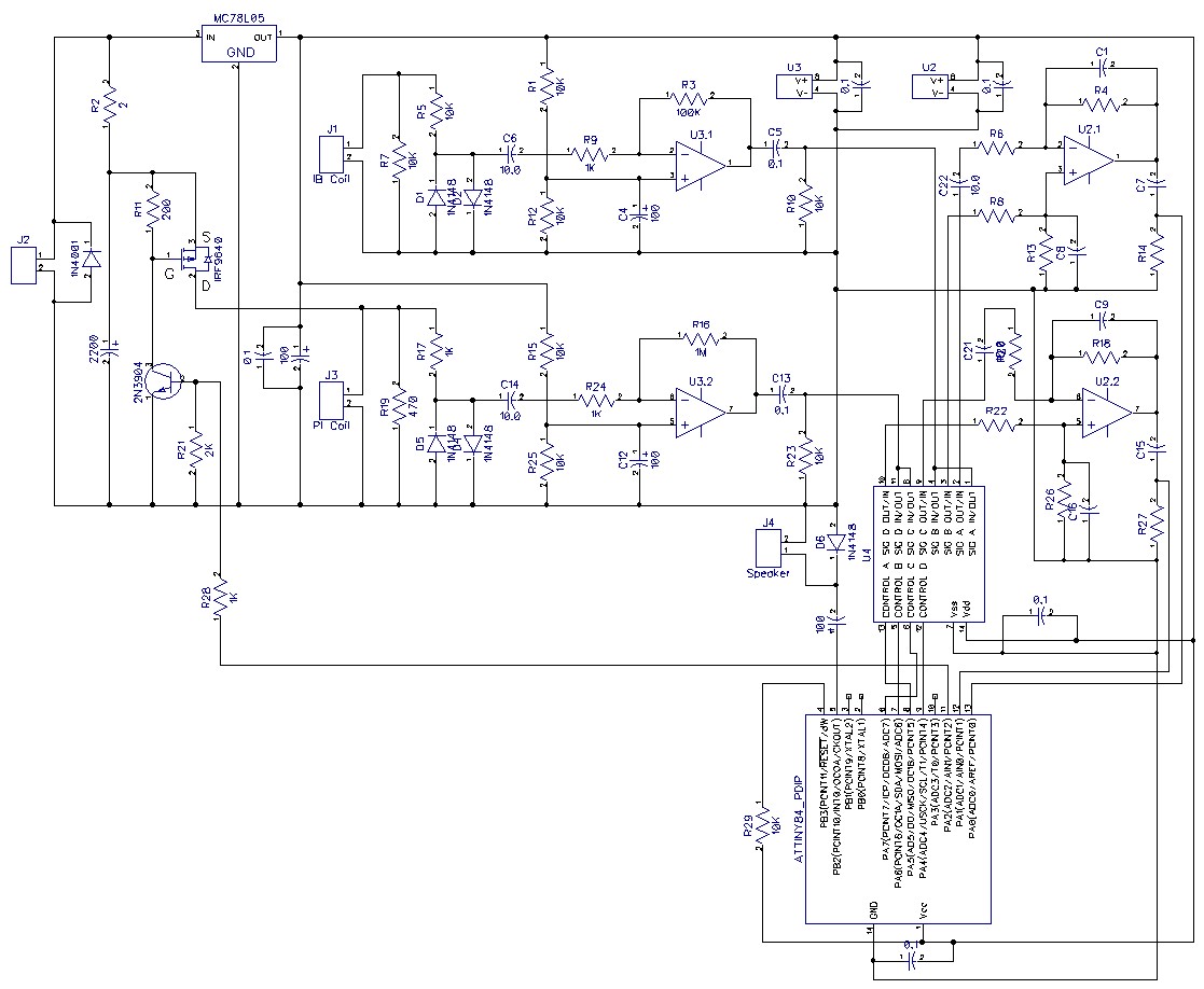

                      And PI detector that will discriminate ferric targets with using RX balanced coil should looks probably this way:
                      But if Hall sensor will work it may be cheaper. We will see.
                        very interesting...i noticed the diagram shows concentric coil instead of 2D....does that make a difference ???? it would be so good to get some sort of ferrous discrimination as im getting too old for digging deep holes !!!! at present im nearly at the end of making the surf pi detector...im just doing the coil but worried about using the resin as i feel it may warp the plastic coil housing also im not sure about how much hardner to put into the resin...im afraid to ruin the coil that ive made so well.
                          "i noticed the diagram shows concentric coil instead of 2D....does that make a difference ????" - No. Any way to build balanced coil will work for practically any IB detector.
                          You can make it DD, OO, Concentric, "8" shape, e.t.c. Any construction require that RX coil does not receive signal from TX coil if there is no target.
                          But some IB detectors required not a complete nulling but proper phase shift so adjustment may take some hard work.

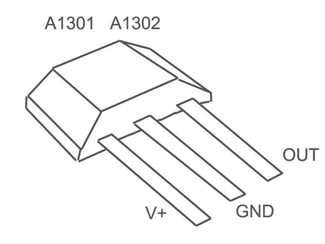

                            Oops... I have fried both my sensors accidentally thinking that pinout is similar to transistors (branded side flat - but it is wrong).
                            So they did not survived inverted power and now giving only 0.6V instead of 2.5V output and having low reaction on the magnet.
                            I have to wait for next supply of it to make my experiments.
                            To prevent loosing of your sensors please check the picture below for correct pinout.

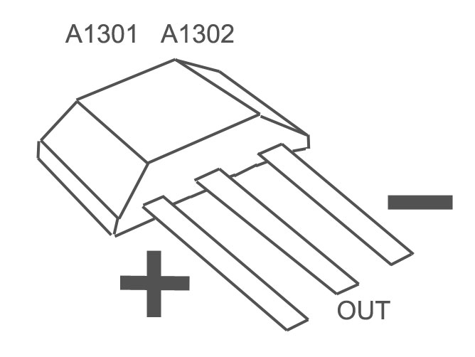

                              Shame on me. I have messed up with pinout again.
                              CORRECTED

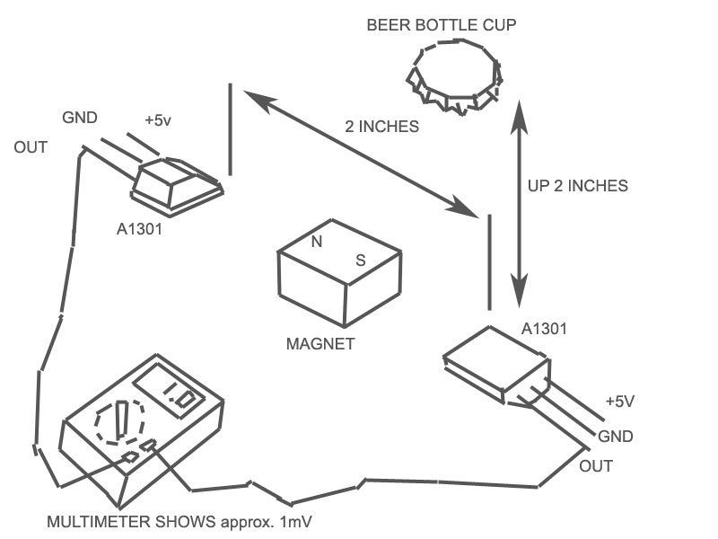

                              Also sensors are working and I have make first quick experiment.
                              Two sensors placed opposite and on two inches distance.
                              One sensor inverted on 180 degrees to compensate Earth magnetic field.
                              Magnet is placed on the center between sensors.
                              Each sensor have to provide 2.5 volts if there is no magnetic field.
                              I have connected voltmeter between sensors then nulled signal by moving magnet to precise position
                              when it shows close to 0 volts.
                              Then if I move beer bottle cap up to two inches high over sensors I can see 1 mV or more readings on voltmeter.
                              So it looks promising. There should be some ways to increase range of detecting like increase distance between sensors,
                              use stronger magnet, use amplifier, e.t.c.
                              I will look into it more.
