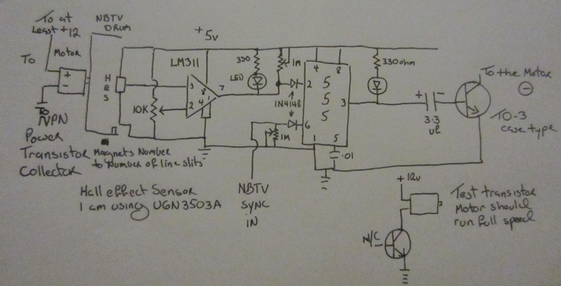

                i have played around with the hall effect ic great idea ...how about hooking it up to a Lm311Click image for larger version
                I used this circuit for motor control the out put of the lm311 is a digital signal///you can view the out put on a scope or use an led ....it would be a square wave ,perhaps hooking your 2 hall effect ic's circuit up to one side of a bistable circuit the other to 555 audio oscillator out put of that to a amp every time the hall effect detected metal iron steel it would trigger the bistable and you would hear the signal ..bit easier than looking at a multi meter.

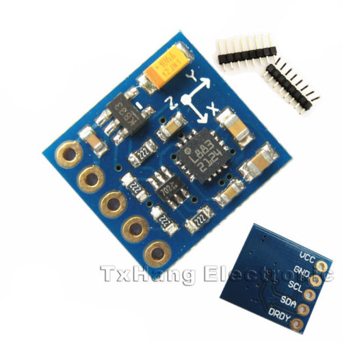

                    Unfortunately I did not get any decent range from A1301 sensors.
                    But this idea about digital compass looks promising.
                    For only $2-3 you can buy on eBay "HMC5883L 3 Axis Electronic Compass Magnetometer Sensor Module 3V-5V For Arduino"
Name:	HMC5883L 3 Axis Compass Magnetometer for Arduino .JPG

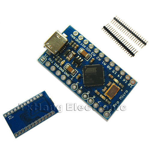

                    and for $7 small Arduino board "Mini USB Nano V3.0 ATmega328" or "Leonardo Pro Micro ATmega32U4"
Name:	Leonardo Pro Micro ATmega32U4.JPG
                    to build compact, smart and sensitive magnetic field sensing device.
