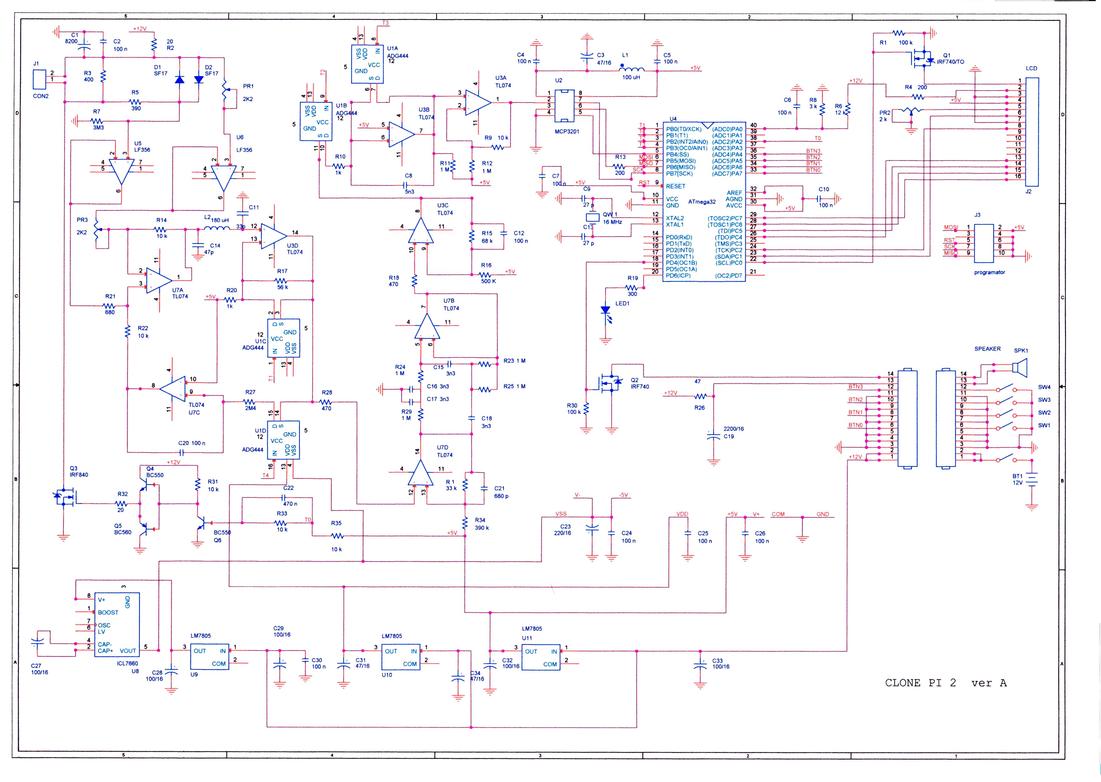

                      ClonePI - 2
                      Hi All,
                      I want to build a PI metal detector.
                      I have already made Hammerhead II PI version of the PIC 12F683 microcontroller.
                      My attention detectors / Радиолюбительские конструкции Фёдоров Андрей http://fandy.vov.ru/index.html/ Andy Fedreova series Clone: Clone PI, ClonePI-2, ClonePI- W, ClonePI - AVR, Chance.
                      My choice is ClonePI - 2 / MOD.2 v1.41/. Reading the forums and opinions, and different versions of the detector have a question:
                      1. Power operational amplifiers /chips/ symmetrical +5 V,-5V, using LM 7660, LM7805,
                      LM 7905, as in the Hammerhead II and similarly Chance - or as it is in the "old versions" unbalanced power of weight?
                      2. What task TL431 in the Chance?
                      Please, your opinions and suggestions that will help me in achieving my goals.
                      I have to draw the whole circuit diagram and to the mounting plate /PCB/.
                      Sorry for my language.
                      Yours
                      Gustaw Gomos
                      [email protected]

                          GOMOS, may be you will very shocked... but there is more fresh Chance to be... on two chips. this factor has to cock you up.

                              Clone2 PI
                              Hi
                              This is my version of "Clone 2 PI MOD.2 v1.41 by looking at the diagram http://i1102.hizliresim.com/2011/2/2/380.gif and about my reflections
                              on a symmetrical power supply + / - 5V and LF 356 at the entrance, continue TL074.
                              If you find a mistake - let us know and you could have your suggestions and what else you changed to improve performance?
                              Gomos / Gustaw-Gomos /
