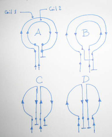

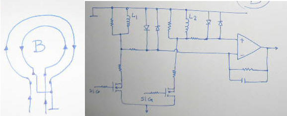

IF YOU HAVE MAKE , TRY THIS .
  • Thank Carl ,
    what this coils is better ?
    • Originally posted by sisco View Post
      Thank Carl ,
      depends of what you're trying to do. Seems you want 2TX/RX config.
      I assume you wanna use same dimensions for 2 coils.
      I assume you wanna use "different" timings for TX1 and TX2 pulses (not overlapping).
      Problem of A is that you could just increase magnetization of soil, if some magnetic crystals are there. So, for me, A doesn't improve your S/N.
      B will improve S/N cause you'll eliminate net magnetization of soil if use two opposite magnetic pulses, also magnetic viscosity effects would be attenuated... so, ideally, signal would depend "more" of eddy currents in target.
      C,D are like in the twinloop old project but DD instead of round... and not overlapped ? could work but I dubt you'll improve S/N e.g. in C version.
      D seems better but mainly for pinpointing... easy instead of round coils... other considerations are similar to B in the central, more sensitive, area of coil but you'll lose in D the net magnetization null effect on the whole area of coil, cause coils don't share the same location on the plane.
      If you read the old Corbyn's article you'll see that 2 TX coils are used to achive this... but then a separate gradiometer RX config was used to get RX signal.
      2 opposite TX share same plane and location... to improve S/N. You can do the same using B config.
      So, for me, B is better than others cause you can gain a real S/N improvement.
      Kind regards,
      Max

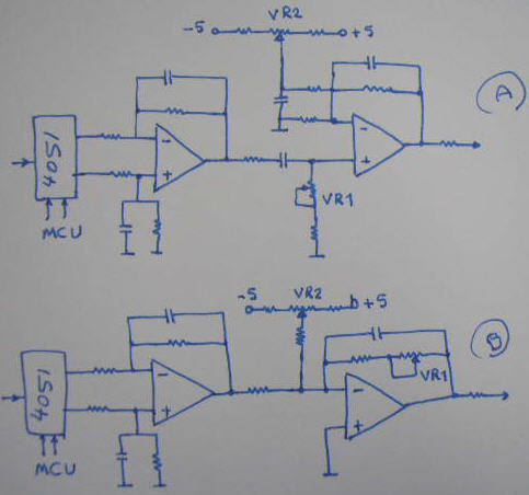

        • now ,time of amplifier .
          what is your suggest between plan A and plan B ?
          (I must complete my information before next project . my next project is
          digital PI with real DISC.)

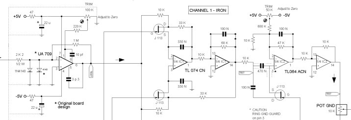

            I'll choose A... cause of the cap between...
            DC coupling in hi-gain stages is the first cause of "disaster" in metal detectors design.
            If you directly connect e.g. 10^6 gain amplifier chain to a dc source... you'll see the UFO.
            Any kind of drift on DC signal will make it sound like a jukebox
            So use the cap... mind the cap.
            Look at the GoldScan4 schematic part... you see the 470nF cap just after 3 op. amps first of the #4.
            It's not a case.
            Too huge amplification along the chain... to stay without them.
            Do not consider 100nF... cause there is a mistake in that older schematic (connection to GND absent) but look just at 470nF.
            Signal is preamplified, sampled/integrated then dc chain is broken... just ac passes to next stages.
            Kind regards,
            Max

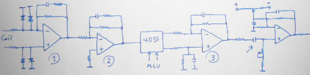

            • Hi Max
              see , this is a one part of my new project.
              infact this is a one channel of detector .(with timing can tell iron channel or
              gold channel).
              I want use two or three (maybe four) lines like this with difference timing for
              DISC .
              what you think ?

                I see. Nice idea having multi-channel : GS4 has 2 one for ground minerals and the main channel for useful signal (usually refered "gold" channel... but it's a bad definition... cause disc doesn't work detecting just gold).
                With 2 channels GS4 ignore almost totally ground minerals when their density is constant.
                If you use more channels you can integrate signal coming from coils at different times thus giving additional pieces to the mosaic.
                I don't know if a true disc could be made that way like is done in some VLFs but it's worth to try and see the results.
                Think most important thing is timing and elaboration of result signals by the MCU.
                Best regards,
                Max

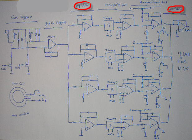

                        • in this PI for DISC don't need A/D or analys .
                          see schematic , for example :
                          adj CH1 timing for ALLMETALL
                          adj CH2 timing for GOLD
                          adj CH3 timing for bricks
                          if each these channels can detect his target you hear BEEEEP but can't
                          understand which channel detect what object so I use LED . for example
                          if hear BEEP and CH1 LED was ON and CH2 LED was OFF you can
                          understand your target(object) not gold .
                          you can with compare these LEDs understand about your object.
                          I think this is best idea for DISC .if you have better idea I listen.
                          about use microcontroller : for DISC you must use two microcontroller , if you professional programmer can use two micro but if
                          you amature programmer like me must use two micro + one A/D converter.
                          (I have new idea for this , must use ATmega8 + ATmega16 + 64 * 128 grafical LCD but my information not complete , must wait)
                          for getting analog signal I have a problem , I think best location for this , after third OP-AMP and before capacitor , what you
                          think?

                            Hi Sisco,
                            I still think that just channels and different integration timings aren't enough to give a good disc. Maybe it can work somehow on test bench but in real conditions I dubt you can disc that way.
                            Maybe I'm wrong.
                            My understanding of PI say me that different metals, with different shape, at different depth could give same effects on the signal curve.
                            My idea is different. You have always use the ADC/MCU for disc in my view of a possible and reliable disc.
                            Of course you can avoid at all last part of integrators...just use a preamp and feed directly e.g. an ADC with samples from the preamp.
                            The use of analog integrators is e.g. an idea if you want avoid doing all the computation by DSP, so numeric integrations. But one can do it.
                            If you look at Robert Holko project thread you'll see that thing made just by numeric methods inside the MCU.
                            The real problem is finding a suitable parameter or set of parameters to look at, e.g. conductivity of metal.
                            Best regards,
                            Max
