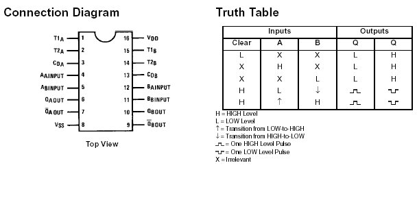

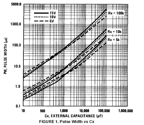

    Max ,can replace 4538 with 4528 or not ? and how must calculate timing ?
    why not ?
    They are too dual monostables... etc like 4538.
    Formula is like this:
    T(uS) = R*C
    so say 100Kohm and 1000pF gives you about 100uS
    Not exact of course, look at the picture below.
    Kind regards,
    Max

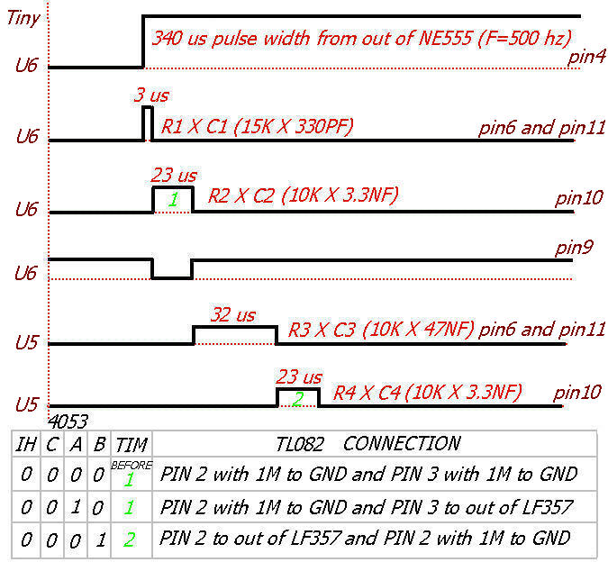

      Can draw wave form of out 1 and out 2 if:
      R1=15K
      C1=330PF
      R2=10K
      C2=3.3NF
      R3=10K
      C3=47NF
      R4=10K
      C4=3.3NF
      I try understand by PROTEUS software but can't.
      (I see in one site, for calculate time must = R * C * ln2)

        R*C*ln2 for 74121 or the like not for 4538/4528
        they are not the same thing
        check again...

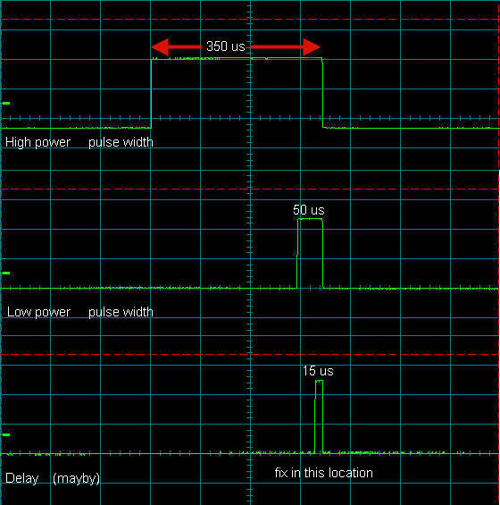

              this is minipuls wave form , wave 1 and 2 for pulse width from high power to
              low power turn on MOS-FET transistor and 15us before end , out1 (4528 is
              on (wave 3).
              how must calculate this 15us
              T1 = R1 x C1 =>15K x 330p = 3us
              T2 = R2 x C2 =>10K x 3.3n = 23us
              TOTAL time must T1 + T2 = 3 + 23 = 25 us (may be this time for
              resistors or capacitors tolerance)

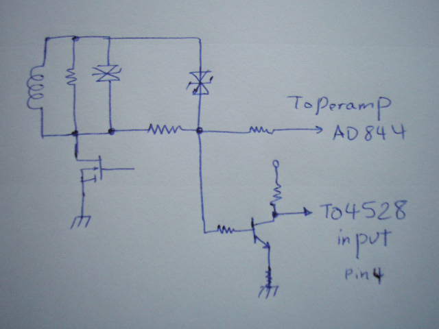

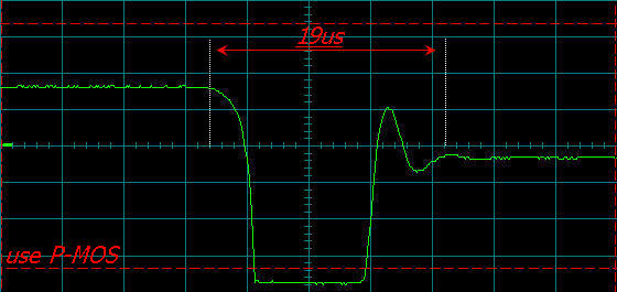

                this is out coil waveform (two head of diode D4 before peramp in minipuls-3)
                where of this wave (19us) must use delay for sampling.
                (for example gold 15us.this 15us must start of where?)
                if I understand good this maybe I can write simple program for ATmega8 for
                metal Discernment.

                  Hi Sisco,
                  first two waves are tx pulses for big and low power , as I understand.
                  Ok.
                  You need to trigger the monostable for first delay using the mosfet control voltage pulse (the tx wave you show as first 2 signals).
                  You have to trigger 4528 using the falling edge of tx signal at gate of mosfet, not from coil as you made drawing.
                  Wire clear high, A input low (gnd) and use B input as input for that signal.
                  The monostable will give you an about 15uS with R=15K and C=1nF
                  You could use a trimpot of 50K in series with a 10K resistor to gain absolutely right 15uS measured from scope, so avoiding tolerances jitter.
                  Best regards,
                  Max
                      metal Discernment.
                      in PI designs the first delay start from the falling edge of gate mosfet triggering signal (convention is at 10% of its magnitude).
                      If you have a fast monocoil you can sample even at 10uS or less (I reached 8uS)... you need the signal to stabilize fast after switchoff... so low capacitance mosfet , coil , cable etc.
                      But 15uS is not so difficault to obtain.
                      Download the bbsailor article and read it:
                      http://geotech.thunting.com/pages/me...s/FastCoil.pdf
                      Very good document.
                      Best regards,

                        see I true understand:
                        first delay start bout 8us after turn off MOS-FET (in tiny if I good understand,
                        start first delay after (R1 x C1) 3us).
                        delay pule width how ? (I think in tiny 15us)
                          after reading 4538 and 4053 datasheet I draw this waves .
                          true or faul ?
                          I think we need only these two 23us .
                          first delay start at 3us after pulse , with 23us witdth and second delay start
                          after 32us at end of firat delay , this is true?
                          what best timing (for gold detection)? (first delay pulse time , first delay pulse width , second
                          delay pulse time and second delay pulse width )
                          for this four timing what is best ?
