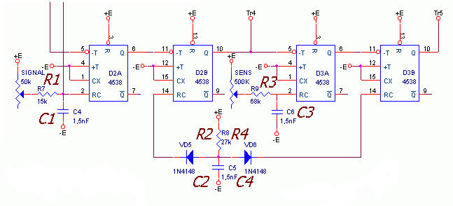

    Geo , can tell me find these clocking by calculate or osciloscope?
    my tiny clocking is calculated (not see in OSC).
    see this picture , if 4538 datasheet is true my calculated must true.
    1set Delay =>R1 X C1 => (SIGNAL pot + R7) x C1 =225us - 975us
    1 sample width =>R2 X C2 => 40us
    interdelay =>R3 X C3 => (SENS pot + R9) x C3 = 1ms - 8.5ms
    I test my minipuls with digital OSC and saw , yes Max your answer is true :
    minipulse 1set delay was 7us (infact 6.9us).
      Max , interdelay must 200us distance with ending of 1sample delay ,true ?

        Hi Sisco .
        I measured the times with Oscilloscope.
        I have one original DP and other 2 made by me. All have the same clocking.
        But if i remember OK potentiometer SENS is 220K at my Detector.
          Hi Geo , I true understand ?
            Hi Sisco .
            220k not problem, bicause in minimun time (only R9) interdelay must 1ms not
            120us??
            are you sure don't change R9 , C6 , R7 , C4 ?
            because in delay width my calculated like you (40us ~ 45us) ?
              Hi Sisco .
              Of course i am sure. I have not changed anything.

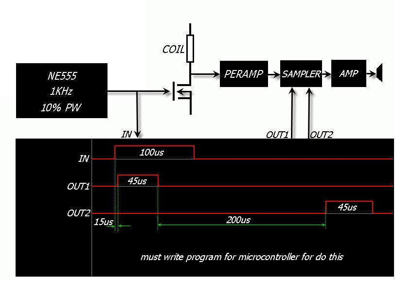

              But at your schematic out1 must be 15us after the "IN pulse" fall
              I attach the clocking of my DP
                Ok Geo ,
                I write this program , start first delay after "IN pulse" fall.
                see and tell me this is true?
                  I have a better idea , why must use NE555 for make pulse , can use micro
                  for do this .
                  Max, see this schematic and if this is true tell me , I have make it and test
                  your idea about timing.
                  If don't work.....
                    for do this .
                    If don't work.....
                    It seems OK
                    Good Luck

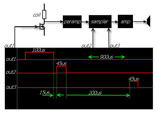

                            Max , your idea about timing , I want first make new device for test your
                            idea but think and decide first test this timing on my minipuls.
                            so erase minipuls ATMEGA8 and programmed by new program (1KHz ,100us
                            PW ,15us , 45us first delay , 200us interdelay and 45us second delay) and
                            test , what you think ?
                            YES this work and I can detect GOLD with this timing.
                            this is my programm writed on ATMEAG8.

                            FOR 1000HZ:ON Pulse is 100us so OFF pulse must 900us calculate = (15us+45us+198.75us+45us)-900us =~595us
