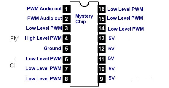

            You need to look at the suppy rails from is local supply, find the supply bypass cap and then meter out VDD and VSS and you will find that pin 5 is Negative and pin 12 is Positive in respect to the supply. Other pins have a multitude of various voltages and I cannot for the life of me find out what this chip is. It was around before 1995 and I have looked in my old National books and it aint in there. Could be a TDA chip? I wonder if Bruce would tell us?

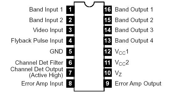

                Could be something like this ?

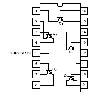

                  Maybe it's a transistor array. At least that would explain the power pins being in a odd location.
                    Max, you may be onto something, I will scope the chip and see if I can make any sense of it. I cannot find many IC with pin 5 and Gnd.
                      This is what I found bt using the cro on the chip, the 5V pins are 5 5.5 5.8 not that it would make much difference

                              yes, could be like you said a transistor array...
                              He could test for junctions like in the picture... to see if the thing make sense or not.

                                Pins 4, 14 and 15 are connected together, pins 9 and 13 are connected together.
                                Measuring for transistor junctions is difficult while the device is still soldered into the circuit board, I will unsolder him and test the device, maybe he is a transistor array.
