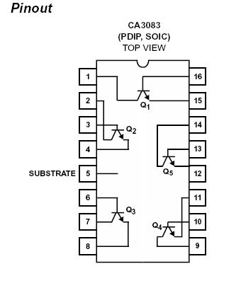

      No luck on it being printed underneath but after measuring it seems to be a 7 PNP transistor array Pin 1,2,4,6,10,13,15 are base connections Pin 5 is common to Q's on 1,2,4 Now to try and find the beast.
        Are they Darlington's ?
          No, they are standard PNP.
            another guess... could be this ?
            not easy to find a 7pnp array in dip16 ! but this seems interesting even if there are npn ones... look at integrated diodes... could give you a false reading when try to measure junctions.
            Kind regards,
            Max
              I must of had one to many Reds when I measured that chip.. I remeasured it and it has a mix of NPN and PNP transistors and one diode.
              1st PNP 1,16,5
              2nd PNP 2,3,5
              3rd NPN 2,3,4
              4th NPN 6,7,8
              5th NPN 9,10,11
              6th NPN 12.13,14
              Diode 15,16
              The 3rd NPN could be a couple of diodes as I only tested junctions.
              Base connections are 1 ,2 ,3, 6, 10 ,13
              I still cannot find a Transistor array that fits the profile.

                very strange configuration...
                are you sure of it ? You must consider that some transistors may have difference from the others... I think maybe is something simple like the all-NPN array I've found... take a look.
                Here Q1 and Q2 are matched pair for low offset...
                Kind regards,
                Max
                  Max wins the competition, When I tested to your picture it measured spot on, what had me confused was the substate connections on pin 5 going to various points on the chip. If I ignore all the other readings and just measure the same transistor connections on your picture then it fits right in.

                    and have come up with the CA3083M chip ... looks a little like it .. or search for something similar.
                    cheers for now
                    gef vk8bm

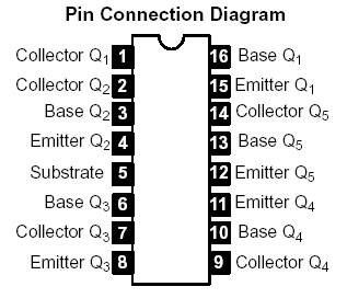

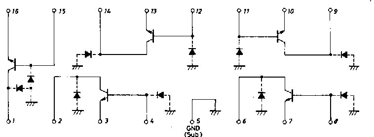

                            Hi Woody,
                            the one in my last picture is not CA3083 but a different one, it's the
                            NTE929
                            by NTE electronics , NJ
                            I'm posting the datasheet for it.
                            Kind regards,
                            Max
                            • #44
                              The CA3083 and NTE chip are copies of each other, I installed a CA3083 into the SD2000 and it works perfectly.
