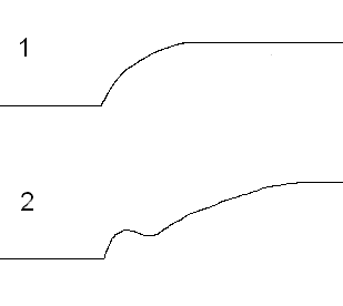

          Hi Reg,
          Sometimes I get a decent curve like pic_1, but when I bring a metal close to the coil the curve becomes like the pic_2.
          Does it mean that the damper value is high?
          Thanks for your helps

              Hi 1843,
              You have mentioned one other thing that can greatly influence the decay curve and that is the IC used for the preamp. You may get a great curve with one IC and get oscillations with another. So, the preamp can complicate trying to understand what is the best.
              Ideally, you want your signal out of the preamp to start low and rise as quickly as possible to a flat line at 0 volts, like your top drawing. If you increase the damping resistor a little at a time, the time it takes to rise will shorten but the signal should still stop once it gets to 0V if it is not underdamped. If you underdampen, the signal will rise very quickly but overshoot and come back down to 0V.
              Your lower drawing shows a target type signal. The hump that occurs before it ramps up is something else and is, most likely caused by the opamp. So, don't worry about that hump.
              Now, you don't have to worry about any signal before you sample, so it can do what it wants as long as it stabilizes at 0V at the time of the sampling. Obviously, the signal will not be at 0V if you are trying to detect something, so make sure the coil is not near any metal at all when checking the signal out of the preamp as to what is happening at the time you sample.
              Reg
