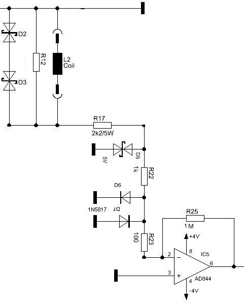

    Here is the AD844 configuration in my PI.

      The AD844* has some nice specs, but my experience with opamps is, you just can't tell until you try them out. The preamp gets badly abused, and it's the large-signal behavior that matters. That is, full-power BW, slew rate, and overvoltage recovery. The last is rarely spec'd.
      On the funky little hump, I've sometimes seen that, and never quite figured out what it is. I suspect opamp output stage nonlinear recovery.
      What are your diodes (eg D5)? Bidirectional schottkys?
      - Carl
      *I know the designer of the AD844, smart fellow... that part is pushing 20 years old, and it's still a competitor.
        D2 and D3 are 1.5KE400CA. They limit (800V) the flyback peak to protect the pulse switch (IGBT 1200v).
        D5 is SA5.0CA.
        Thanks for the reply
          Carl,
          Do you think that the coil is underdamped?
          What modification do you suggest for the preamp's feedback?
          I am not an electronic expert; so I don't know what to do. I'm waiting for your reply.
          Best regards
            The coil is not underdamped, if it were you would see an overshoot (start of ringing). Try Reg's suggestion, reduce the feedback R to 470k or even 330k. Most high-speed opamps are datasheet-tested with a much lower feedback R, so performance can be quite different for a high R.
            - Carl
              - Carl
              Ok, I will do that. But how about adding a capacitor in parallel with the 1meg resistor?
                Hi 1843,
                I am not sure just why you are so concerned about the damping resistor and the hump. If you are sampling very late, then what happens before the time you sample is not important and will not affect your sensitivity.
                Now, if you reduce the damper resistance just to try to get a nice perfect curve, then you may be able to do that, but you will also reduce the sensitivity of the detector.
                You will want the damping resistor to be as large as possible for maximum depth capability. So, if you are trying to figure out the best damping resistor value so you get the greatest depth capability, then you will try for use the largest possible that can be used and have the signal stable when you sample. The reason is simple, the signal from the coil is dissipated two places. This coil energy is shared by the preamp and the damping resistor. So, the more energy that goes into the damping resistor, the less there is for the preamp. If you want more signal o go to the preamp, then you have to have less go to the damping resistor. To do this, you will want a larger resistor.
                If you are trying to obtain maximum depth capability and you are sampling very late like you mentioned earlier, then I would use the largest damping resistance I could and still have things stable when I sampled. I wouldn't care what happened before then. In other words, if it oscillated before I sampled but was stable when I did sample, then I wouldn't worry and use it.
                The last thing I would be worried about would be humps or other distortions that occur well before I sampled.
                Try different values and see for yourself just how it can affect the depth.
                Reg
                              - Carl
