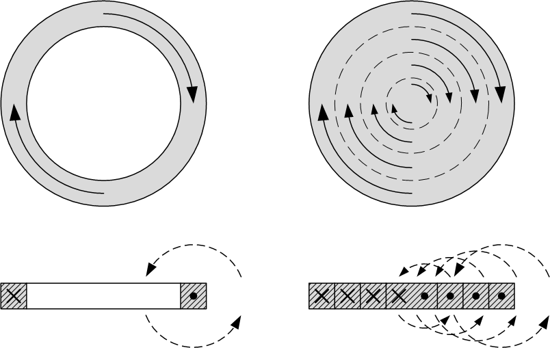

      I don't think your sketch is correct either. The eddy currents will all be in the same direction, but portions of these circulating currents cancel due to the principle of superposition, and the result is a stronger current density at the surface of the target, which diminishes towards the center. Mike-BG's sketch shows the current density of a cross-section of the target (minus the arrows, of course) not the actual eddy currents.
      Another reason, a drilled-out coin (or ring) gives an enhanced response to an ordinary coin, is because the current density around the inner surface is much stronger. In other words, for a thin coin the current density is strong around the periphery and diminishes towards the center, whereas a drilled-out coin is strong at both the outer and inner peripheries.

                • When I drew that picture of the solid coin with the multiple eddy paths, I knew even then that it wasn't technically correct, but I decided to use it because it was an easy way to get across that ring objects create stronger eddy responses than solid objects. Yes, you would use superposition such that directly opposing currents cancel -- there's nothing wrong with drawing currents this way -- and the result would be overall like Mike drew.
                  In reality, eddy currents in a solid coin don't quite behave even like the multiple small circles, they just flow around as Mike drew. So why does a solid coin have a weaker overall eddy response? Imagine the solid coin made up of concentric conductive rings of wire, each ring insulated from its neighbor (as with magnet wire, ferinstance). The incident magnetic field induces a current in each ring of wire, but each ring of wire also creates a counter-magnetic field. The counter-magnetic field of each wire ring then interacts with neighboring wire rings to reduce their eddy currents. In essence, neighboring wire rings create an eddy "drag" on each other, from the outer ring all the way to the center.
                  If all you have is the outer ring, then there is no induced eddy drag because the counter-magnetic field sees only air. But does one ring of wire give the strongest eddy response? Or two rings? Probably there is an optimal ring thickness; any thinner and the reduction in primary eddy response dominates; any thicker and additional primary eddy response is overwhelmed by the eddy "drag".

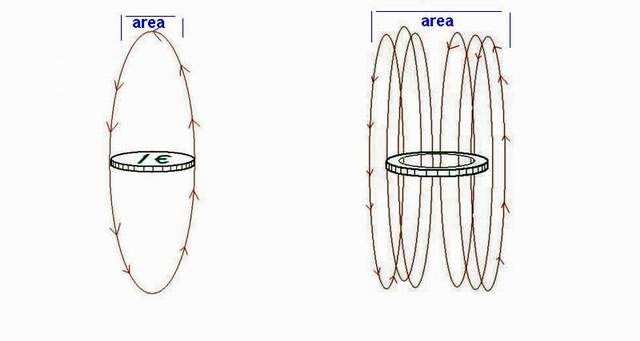

                      • That is simple relation between areas covered by minute alternative fields generated in detected item. My draw is simplified but hopefully enough good to explain the idea.
                        • When the coin is not in "typical position", the coin seems is an only width wire. In discriminative mode detector tend to show the item as trash.

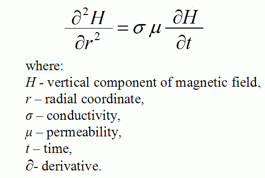

                            • Step down response of a coin
                              Differential equation for analysis.
                              This differential equation is solved by the method of Fourier by splitting the variables r and t.
