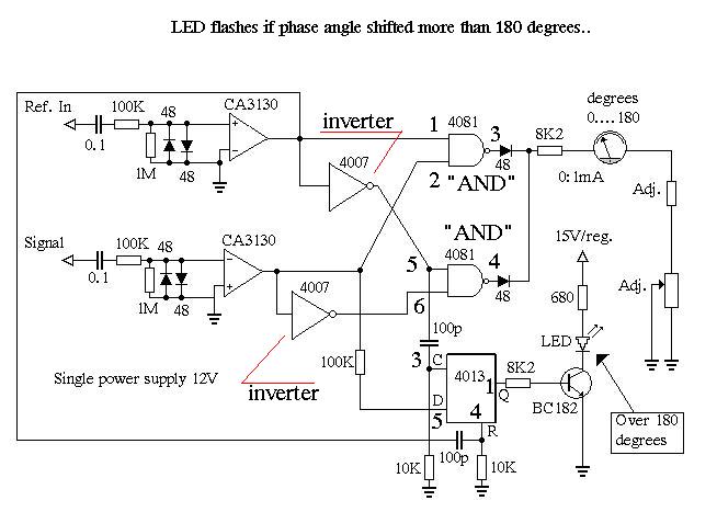

    Take a deep breath; i finally founded schematic of device with which we can simply measure,scope or follow phase angle shifts...Sort of diy, easy to make, suit,cute...yeah!
    This could be done as standalone measuring instrument and also could be included in md design as extended discrimination stage...Yeah again!
    This was taken from old "Wireless World" magazine from august,1979.
    Issues (for me) here is that ic pins are missing. I am not pretty familliar with 4007 and 4081....so this logic draw is confusing me a bit....
    That's why am i posting it here...
    Any suggestions?

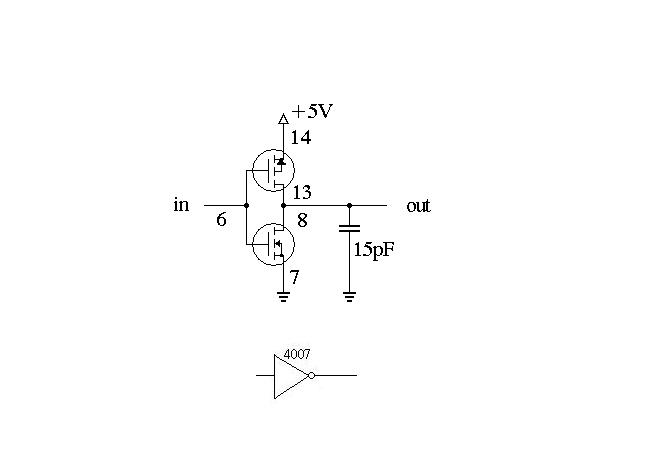

    Only thing not clear to me yet is that inverter. Here 4007 is used. I am not sure about 4007 setup here yet. Active or passive load? What to do with unused pins? In this setup two of cd4007 must be used. Since power supply is strictly 12v (due used components values) than 5V regulator must be included to supply 4007 separately..or not?
    4007 acting as inverter is sure best thing here. But could it be replaced with other kind of inverter circuit?
    To many questions. First thing is to distinguish proper 4007 pin assgnments here...

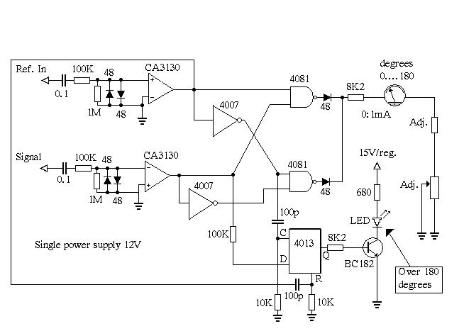

      I tried to "decipher" this more. Not sure i this is correct?
        It will be easy to calibrate VU to zero phase angle.Simply to load ref.in and signal inputs with same signal, adjust zero with trimmer and that is all.
        Later ref.in will be reference taken from TX stage and signal input will be fed with RX signal. Any angle shift would be easilly indicated on VU scale...cute!

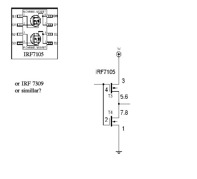

          Or...going further i am thinking how to make this more portable;
          could 4007 part here been replaced with IRF7107,IRF7309 or simillar?
          I am really novice in this things,need help here...
          Must be that someone here know this better than me?
            This reminds me of a classic phase detector in a PLL. The outputs of the NANDs are just pulses that vary in duty cycle due to the phase difference, and the duty cycle is seen as an RMS value by the meter. No reason why you can't run the whole thing from +5V. No reason why you can't put the whole thang in a PIC, within certain limitations.
            - Carl
              Thanks Carl! This can really be used as standalone instrument - huge help during coil balancing. First idea was to make it for that.
              I was wandering about 5v supply. Now when you saying it will work - even better. Also to make this even more portable i was thinking to use CA3240 instead 2 CA3130. Logically no reason why it shouldnt work?
              PIC...yes, small 16F84 can handle this task easilly. Instead VU scale, LCD could be used also....
                Both the CD4007 and the CD4081 are CMOS devices that have a recommended operating voltage of between 3V and 15V. So there's no need to use a stabilized 5V supply.
                A CA3120 should be a good replacement for the CA3130.
                I was also thinking this looks like a classic phase detector from a PLL.
                Your main problem will be calibrating the meter. Let us know how well it works.

                  cd4007 are dual complementary inverters, then 4081 are NAND gates and 4013 are very common D-type flip-flops...
                  Seems easy... but what about precision ? I'm not sure this is the best way to know about phase shifts...
                  As Carl said... maybe you can do better with a PIC.
                  A PIC can use e.g. a 20MHz clock signal to have really accurate timing and internal timer to count for time intervals: if you make it autorange and lock to
                  signal frequency you can easy find phase shifts making some calculations and measure will be really accurate, probably some 1/10 degree on low frequency signals like 10-15Khz.
                  The advantage of this simple circuit is that you don't need to program an MCU to get it work... but I always think the best way to know about phase shifts is using really accurate frequency locking or for fixed freqs using quartz reference signal to measure time intervals.
                  Anyway... I'm interested too in results... cause it's boring to wire each time scope to look at shifts... so please let me know of any progress with it.
                  Kind regards,
                  Max
                    dechypering it a bit more:
                    2 parts ca3130 are zero crossing detectors... they are open chain connected so acts like comparators, the 2 diodes are for input protection and will limit voltage transients to -0.7 ..+0.7V at each input used.
                    Capacitors of 0.1u used for decoupling Dc component; resistors there are voltage divider... and impedance stuff... not important.
                    The upper zero crossing detector will give positive saturation when signal (reference) will rise over zero volt ; the second the opposite, give positive saturation when signal to measure goes down zero volt, negative otherwise.
                    Upper NAND gate will get output at 0 just when both inputs are at 1, so at positive voltage: this happens when reference signal is more than zero volt and when "signal" at second input is lower than zero volt.
                    The second NAND gate gets opposite signals than the upper so its output is always 1 except when both signals out of comparators are 1, so its output is 0 when reference is under zero and signal is over zero.
                    This is a useful trick to double voltage provided to meter using reverse edges of transitions to count for phase shift.
                    The NANDs drive a rectifier diode each branch that will provide DC output for the meter--> the current flowing in meter depends directly on how much wide are positive pulses from nand gates... so on duty factor of these two signals.
                    These 2 signals depends linear way on pphase shift:
                    - when signals are in phase the duty factor is zero... cause when one comparators out are NEVER 0 same time but always 0-1 or 1-0
                    - when signals are out of phase the duty factor is >0 , depends linear way on shift value and maximum at 180° off phase cause comparators out are both 0 for the maximum time (1/2 period of signals)
                    The flip-flop will be periodically resetted by first comparator at each positive edge of reference... and used to detect more than 180° phase shift.
                    As said seems easy stuff... and it is... BUT I see problems having hi resolution using an analog meter there... too old approach and good maybe to detect 2-3degrees variations.
                    There's also non-linearity of diodes to keep in mind and maybe fast ones like some shottky will perform better there... and also I don't understand why there isn't any little cap to hold voltage a bit! This seems truly a mistake there! I will add a 2.2 uF there or 10uF.
                    Kind regards,
                    Max

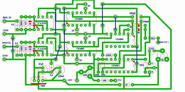

                        I did some fast pcb. Design is not some state of the art, but will do the job for fast testing. If this turns to work than i will draw better pcb...

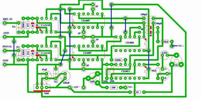

                          Damn! This pcb will never work, until correct supply pins on CA3130!!! Instead 7. pin i connected 8. pin!!! What a hurry!? Only that i spotted so far.....Damn!
                            This one is correct!
                            Huuh!
                              Huuh!
