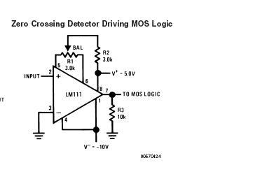

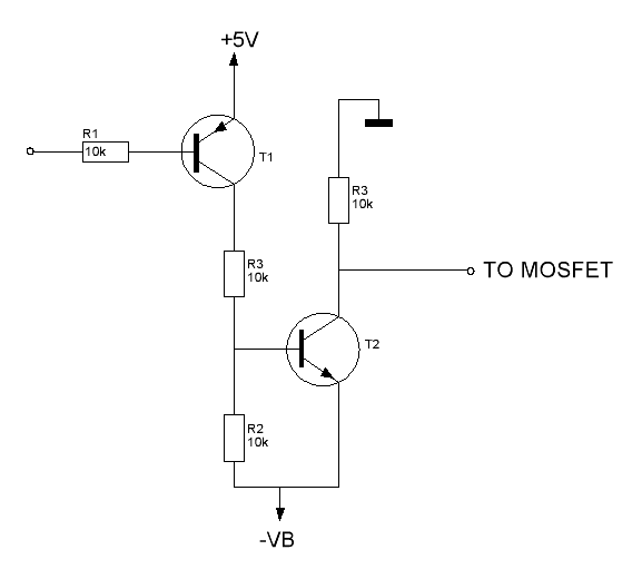

                            Hi Aziz,
                            One of the "problems" with micro controlling a PI is the micro sits between +5 and gnd and the mosfet/coil sit between ground and some minus voltage. As the micro can only swing outputs between +5 and gnd it's a small problem to level shift the signal. The attached pic shows an easy method that works very well. Add a 10k/10k resistor divider from +5 to gnd with the junction going to the + input and one of the micro's output pins to the minus input. Put a 1k resistor from the output to ground (as shown) and the output will very happily swing the mosfet gate between gnd and the minus voltage. An extremely elegant solution that works very well.
                            bugwhiskers
                              Why not just use a single level-shift transistor?
                                Carl is right!
                                I personally use this:
Name:	MOSFET DRIVER.GIF
