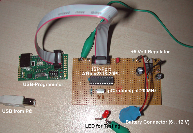

              Hi Friends,
              my first AVR µC test board is ready and working. I tested this with a simple flash LED light test through the port B bits (counting from 0 to 255 and again with some delay).
              See attached picture for the test board.
              Aziz
