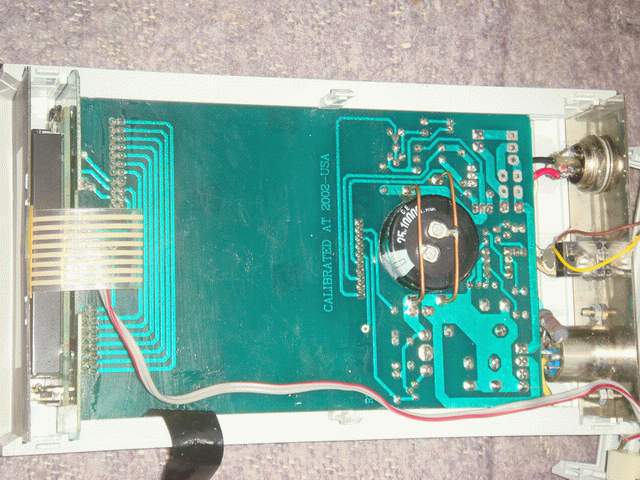

          and this one from other side. what a funny forum for such limitations in uploading, it doesn't get zip type more than 1Mb.
          • #95
            Way you pronounced this "device" from a start gave me a lot of doubts in it's real existence.
            Even now, looking this photo, i am not sure is it PI detector or something else - some scrap electronic.
            You must do much better Michael. You must take more photos, zoom to top layer and components.
            How come, that you are always very ready to argue and write novels but never really ready to give some more "material" material?
            Why are you not giving here photo of upper side? What is so "secret" to hide?
            Do i must to **** you up every time to provoke you to act convetnionally as any other member here?
            Esteban sepcially in your case i could be wrong. From very start you posted your stuff on all threads and subject. So i could exclude you from that list.
            My mistake.

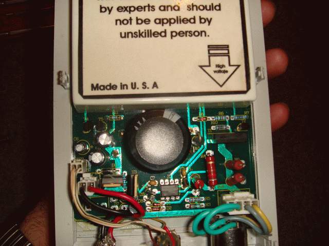

              Oh yes! The upper side is coming!

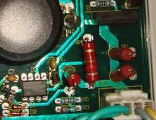

                    • Whats so wrong with banana republic term? I live in funny, little banana republic - Serbia, in the middle of Europe So what? Does this makes me "Banana Man" !? Yes of course!
                      Back to Michaels photos. Looking at upper side, yes it is PI detector. I see quite enough components to be sure it is PI detector. No doubts in that anymore.
                      Now, next thing is to proove it is working that good as Michael stated.
                      Small 8. pins IC is RX front end. See 2 reversed diodes at IC's input? Those are protective&limitting diodes to prevent huge saturation at IC inputs.
                      So, it is PI detector for sure. And IC looks like ordinary op-amp.
                      On right side of photo there are some large resistors. Most probably dampers.

                        • and this the last pic.
                          Robert, if you could find anything for god sake, for humanity or every thing you believe in, for first time be useful and tell about secrets.
                          I did what could do, rest is up to you. don't forget me please.
                          good luck and bye in this thread,

                              Esteban , Hello Again. You are 100% correct on your latest observations !!!! And did you notice the missing components on the bottom left of the circuit board ???????? Like it was originally a "A.C." Line POWERED DEVICE !!!!110/220 VAC. I think this detector was originally an "INDOOR" Device !!!! Look at the power plug ????Also the language of device calibrated at USA "PAST TENSE" - Meaning assembly was finished NOT AT USA . I am not an english scholar but they speak and write worse english than me !!!!! Pretty Bad I searched again last night for hours and I am getting closer, much closer. We will Succeed with this "Metal Detector" mystery !!!!!...........Eugene
                              • Amtech, i don´t follow you with the AC and the english problem...???
                                What is puzzling me is the scrapped ic reference.This means the device was to be showed to someone else and not copied.So not a prototype.
                                Michael, did you pass your fingernail or something all over the big white label to see if there is srews below it?
                                If it is repairable , there must be a way to open it!
