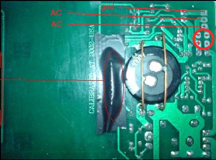

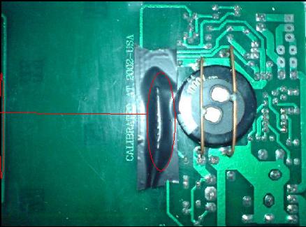

    Hi again , Fred . The writing on PCB is not proper english. This detector was used inside a "Factory" then modified to be used "outside" in the field. Electric tape might be covering a "FUSE". And do you see the 6 empty pcb slots/holes in top-right corner ?? I am finished with this unsolved-mystery for now , I gave it my best effort and many hours NO CHARGE ... Thanks Michael for the challenge . I have other projects and very little time now , Not enough data to Solve the "Big Mystery" at this time.........Eugene
    • It is sort of PI detector, no doubts any more. I needed to really push Michael to his limits to make him post complete photos here!
      Also seems some components are missing.Doesnt mean it was AC device.
      About English terminology, i can not judge,i am also "alien", not English language expert as you see.
      White box probably covers timing circuitry and LCD driver.
      Only one important question left uncleared - is it good? Only Michael do know the real answer. But he already said "bye" so bye Michael.

        • Michael, wich kind of battery uses the detector? Did you can trace schematic? In appareance, in the "HV section" is more electronics.
          Esteban
          • Originally posted by amtech2005 View Post
            Hi Eugene,
            Are you sure? searching at the exact phrase i can find a few results all related to research ...Could it be an expression used by scientifics?
            Interestingly, searching at the other written stuff (repair...) i find similar scientifical results...
            For the empty holes it could be some optional connectors, but not AC IMO.
            regards!,
            Fred.
            PS: Esteban, Michael told us it uses a 12V battery,and the schematic could be easily traced from the pictures, but i dont think it is worth it, it surely a PI with signal going and coming from the white box,the heart of the detector.

              • The wording on the white box is not good English - "This device is repairable by experts and should not be applied by unskilled person."
                Surely this should read - "This device is only repairable by experts and should not be opened by an unskilled person."
                It also says "Made in U.S.A" - note the missing dot after the A.
                This white box still looks like a DC/DC converter module, otherwise known as a DC/DC brick.
                Maybe you should try searching for the module, rather than the detector.

                  Here i respectfully, but completely disagree .The detector could not work if it was only a DC/DC converter.The LCD control, timing and signal processing are done there.
                  Small research teams sometimes have to develop their own device for a particular purpose, and use the material they can reach.they don´t need fancy enclosures etc., just a working device, and they usually have plenty of time but not alway the necessary knowledge, as their goal has nothing to do with the means involved to achieve them.

                    Fred, thanks. Is very difficult to open the white box? There is a kind of hard-glue in circuitry-PCB or what?
                    Esteban
                    • Originally posted by Esteban View Post
                      Esteban
                      Michael says there is no way to open or look inside the box.Maybe he could find some srews or fixing devices below the sticker.
                            you're right about the holes:
                            the 4-holes are for a silicon bridge , round kind , probably rated under 2A.
                            3 remaining holes are probably for cables that goes to a panel connector, used to supply device by an external powersupply/charger.
                            Consider that both AC power and DC could be made available for device, since the positive rail goes to connector leads too. This could mean device was intended for both indor usage (like an industrial e.g. conveyor detector) and supplied by a DC power source too... no matter if is a powersupply or e.g. an UPS with a big battery: some factories oriented devices MUST provide UPS connection and give uninterruptable service even in case of blackout.
                            Another possibility is that device was provided with e.g. a car adaptor, in wich case the bridge rectifier remains unused and the detector will be powered by car electric system/battery. This is , indeed, really probable considering that some depth PIs are actually employed that way... suspended coils e.g. carried at distance by a 4WD or pickup. I remember was an "australian desert" most wanted feature somewhere (for big nuggets)!
                            Kind regards,
                            Max

                              I think preamp with scraped label could be actually an NE5534 ic. Other preamps could be there... but NE5534 is very common in many PIs still today at preamp stage. I think too isn't nothing from mars...
                              The two diodes, like you said are sure a clamping network... probably device push hi current in the coil... and spike is very high... probably in the 400-500V range
                              Kind regards,
                              Max
