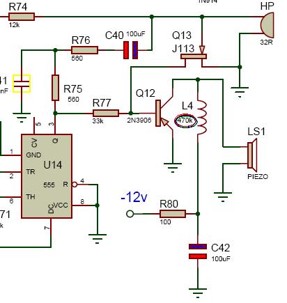

    Hi Max
    I have made GoldScan IV,Not finished.Do you know what is the "L4" "470K" mean?

      HI kt315
      Do you know the value of "L4"? 470uH?
        Originally posted by zzy View Post
        Hi Max
        [ATTACH]5837[/ATTACH]
        I uses a 100uH replace it ,I think this causes a lot of noise.
        in original schematic by Alexis it's 473K, I've used 47mH there (47000uH) and works good.
        It's not so important unless you put there something that will create too much interferences like a little speaker could do.

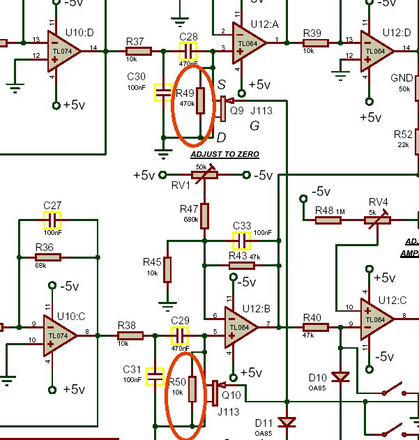

                    Good explanation.Strangely,My test shows GS4 is a motion machine,the detection is poor.I don't konw where is the problems.
                    no... you probably have something in schematic that's different from what I have. Maybe the SAT mod I talk to you... look for resistance 470K or something near the 470nF caps at middle. I remember Reg put a switch to enable that feature or not... probably you haven't any switch there... let me look at Vladimir stuff again... I remember just the Alexis' one... then I will answer better about this.
                    Now about performance... it's a great MD! Very impressive performance on air, well balanced also, can detect coins at very deep simply using 8'' coils. Much more depth with larger coils on big stuff... meters!
                    Problems then is not performance on air... but on soil: real soil contains often magnetic stuff... crystals... and not a problem when they are random oriented in the space (the magnetic moment I mean)... but fired stuff... like fired bricks or ceramics has them all aligned and it's kind of detecting a magnet: bricks and pottery make GS4 crazy very easy and from far distances...give same audio response of e.g. coins or anything else.
                    Kind regards,
                    Max
                      Ok... I found it:
                      look at there... this is Vladimir's mod, in original Reg's SAT mod both resistance were 470K and there was a double-switch to enable or disable them from signal path.
                      Look... if you remove resistors you'll get non-motion, like original design in Alexis' schematic; if you leave them there you get a fast SAT behaviour... so motion kind.
                      Kind regards,
                      Max
                        Hi Max,
                        Just like you said,i remove the two resistors. GS4 becomes a non-motion machine.Very thankful!
