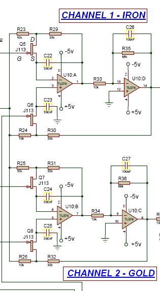

        Hi Max,
        This is my measure of the delay time.Sorry my bad camera.
        I measure the Q5 to Q8

        Q5 about 75uS delay
        Q6 about 60uS delay
        Q7 about 200uS delay
        Q8 about 15uS delay
        I change the 1n5818 to 1n4148. no effect.

          the 15uS there are good. In the pictures I see ringing in last part of signal evenlope... you'll better avoid that, selecting appropriate value for the damping resistor.
          The fact you get low sens could be related to some other mistake in pcb maybe... cause about timing it seems good.
          I will try to follow signal path and see if I'll get good response e.g. at integrator outputs when nearing metallic stuff.
          This could help insulate the fault.
          PS: what about the jfets ? did you use j113 or different ?

            Hi Max,
            I use 2SK435, the pin is differ to j113. Does the jfet's "D" and "S" pin can interchange? Some people said the the jfet's "D" and "S" pin are same.
              Originally posted by zzy View Post
              Hi Max,
              your fets are good replacement; you can swap D and S cause it's bidirectional device...
              Probably problem is elsewhere.

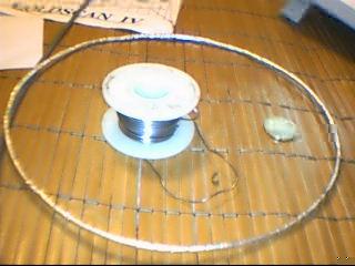

                      Hi
                      The shield connect to where? GND or -12V?
                        Hi
                        put at GND.

                          Hi
                          I use aluminium foil. This is my coil:
                          Now the problem is the signal became wider than unshield coil.you can see in the picture.The black is the unshield coil single.
                          the red is the shield coil.GS4 can't work well use this shield coil. I think the shield add too many capacitance in the coil.

                            you're right. It's not good. But you don't require heavy shield on it.
                            Sometimes AL-foil is not good for your purpose... then you can choose different stuff... e.g. mylar (plastic+aluminium , very thin --> low conductive layer), graphite, copper mesh tape, copper tape, lead tape, nickel varnish etc...
                            Most of these things are sold for shielding RF purposes...
                            Depends on what you have there available, and what can find/buy. The graphite is easy... you can find varnish both in spray cans or even made yourself (you MUST have chemical skills to do it... but it's possible with right stuff).
                            Sure, if don't solve that problem you'll get less or no sens to lowest conductive metals, e.g. small gold things.

                              It's hard to tell in your picture, but did you leave a gap in your shielding?
                                Hi
                                I didn't leave a gap.what is the gap use?
