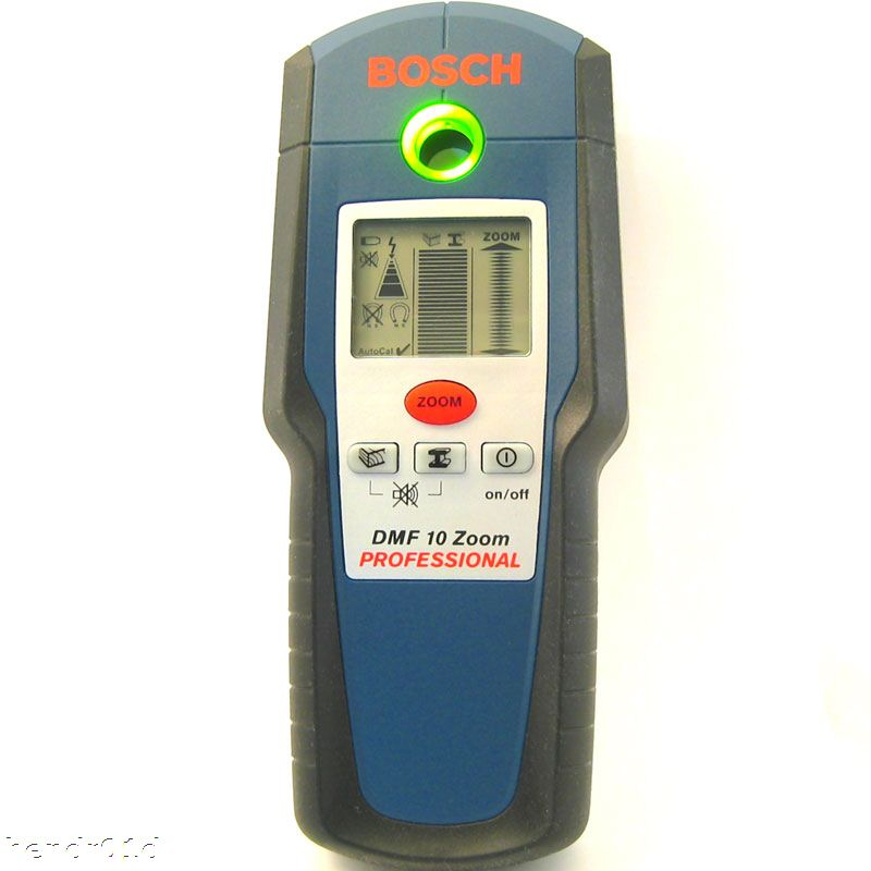

          Also... today I found there's another Bosh made stud detector that's maybe better than the "skill" one... do you know it ?
          It's rated 10cm on ferrous and 8cm on copper buried stuff, coin sized... not bad for such small coil there.
          For Ivconic: do you know that model from bosh , DMF10 ???

            Yes DMF10, in local shops price is 125e. I tested it and compared with Skill.
            Not better than Skill. Skill is noticeable better and costs only 75e...
            However..i have hunch those are based on same machine inside; same controls,same processor... What is difference? Most probably some adjustments and coil!? Not sure. And of course brands; Bosch is always more expensive than Skill !!!
            Look F2,F4 and F75...and compare with some Fisher models... same old story continues again and again...

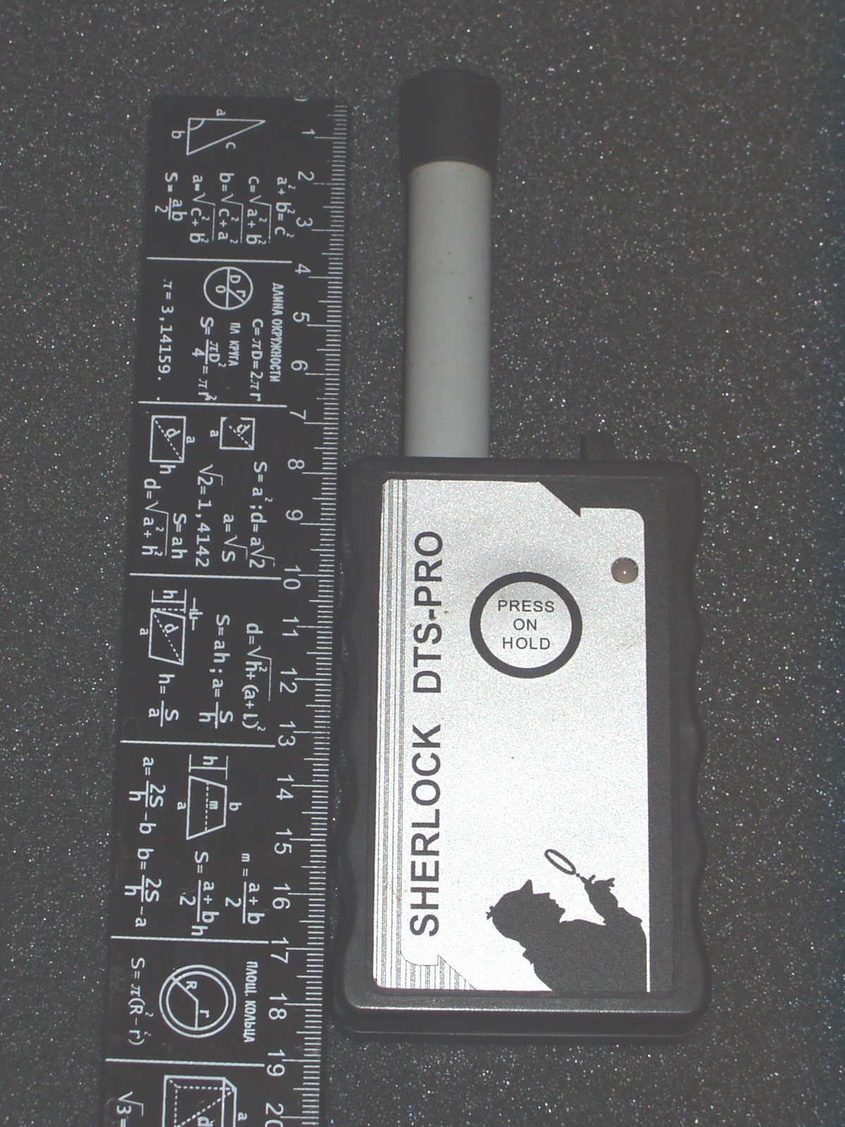

                files on DTS p/p

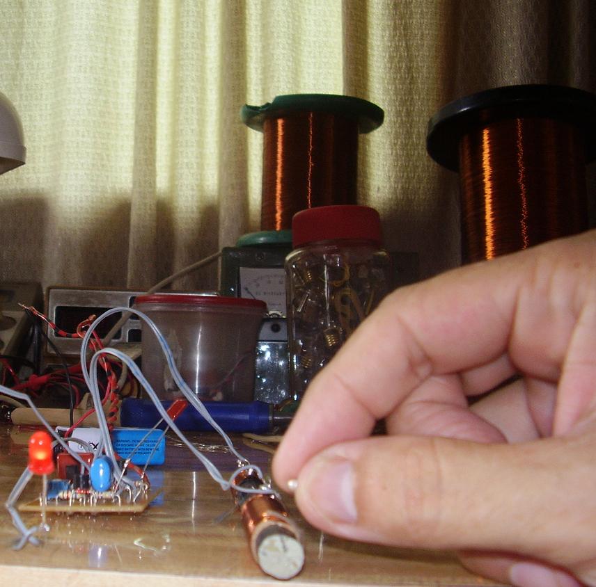

                  here it is...
                  the crappy pinpointer !
                  All made of junk...
                  Kind regards,
                  Max
                  Wow! I missed that?
                  Your "crappy" pinpointer looks much better than you presented it!
                  You are modest Max. That is a very nice handmade! Congratulations!
                  Pretty handy and pretty nice.
                  Cheers!
                    I'm thinking seriously use it for to find in small streams this category of nuggets (in the pic small Peruvian silver nugget).

                      Hi Esteban,
                      I think it's good for these small things: I have a small gold nugget of about 3mm diameter and it detects that at 5-6mm if good tuned.
                      I think it will be very nice for nugget hunting where a big coil is sure unuseful on that small , elusive targets... expecially if the coil is DD: the pinpointing is difficault and the wide area coverage doesn't help locating the small nugget in the e.g. sand.
                      I think the circuit could be optimized and power increased a bit but maybe one will gain just few mm more on such small targets.
                      Anyway, for the scope it's intended, though so simple, I think is very good.

                        thanks... I made using just trash... things recovered from old projects... old stuff apart a new 9V battery inside, all is made of old junk from here and there.
                        Then I painted it all-black... just to remind me it's something useful... not something to trash from bench!
                        I'm really interested in farther pinpointing too... must find some good schematic.
                        A friend that uses DP asked me to search for a good one... cause, you know, sometimes you dig large holes (say "wells") cause of that deep detection and recovering / pinpointing the target is not easy... often is on well's borders/walls and must dig laterally... waste of time... expecially when cannot pinpoint with a common md.
                        This happens sometimes also with normal MDs and single small items: on the walls... and often an easy pinpointer like this I made is not enough...
                        There a good pinpointer like the Skil will be really useful... but also some good schematic could be enough I think.
                        I will look for it... but if someone has some good idea... please post here.
