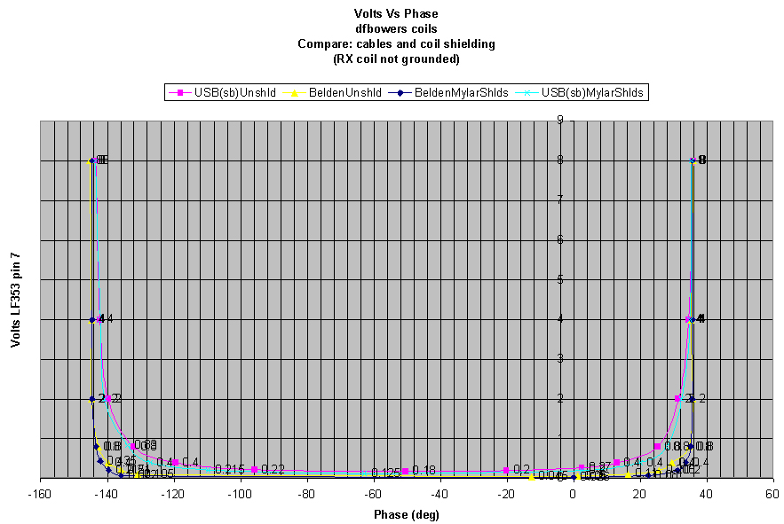

              • nulling comparison - mylar shields and cables
                Here is another graph of the "Rx null signal", comparing cable/coil shield combinations:
                1. USB cable, no coil shields.
                2. Belden cable, no coil shields.
                3. USB cable, mylar-aluminum coil shields.
                4. Belden cable, mylar-aluminum coil shields.
                As usual, the graph plots the Rx voltage vs phase while shifting the coil overlap from one side of null to other.
                Conclusions:
                A) The Belden cable plus mylar shielded coil combo looks the most "ideal", with the deepest, squarest curve.
                B) The choice of cable is more influential than the mylar shield/unshielded choice on the nulling graph.
                C) Mylar-aluminum shields seem to actually reduce what I call the "capacitive" (or non-magnetic) coupling effect between the RX and TX signals. I conclude this because the mylar shielded cases have a more "square" graph which is more like a pure transformer.
                Note: my mylar-aluminum shields are not perfect. I'm fairly sure some small sections were not grounded.
                Note also that this does not imply any combination is "better" for detecting targets -- that requires a field test.
                It will be interesting to see how aluminum foil shields compare.
                -SB
