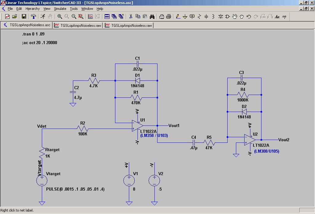

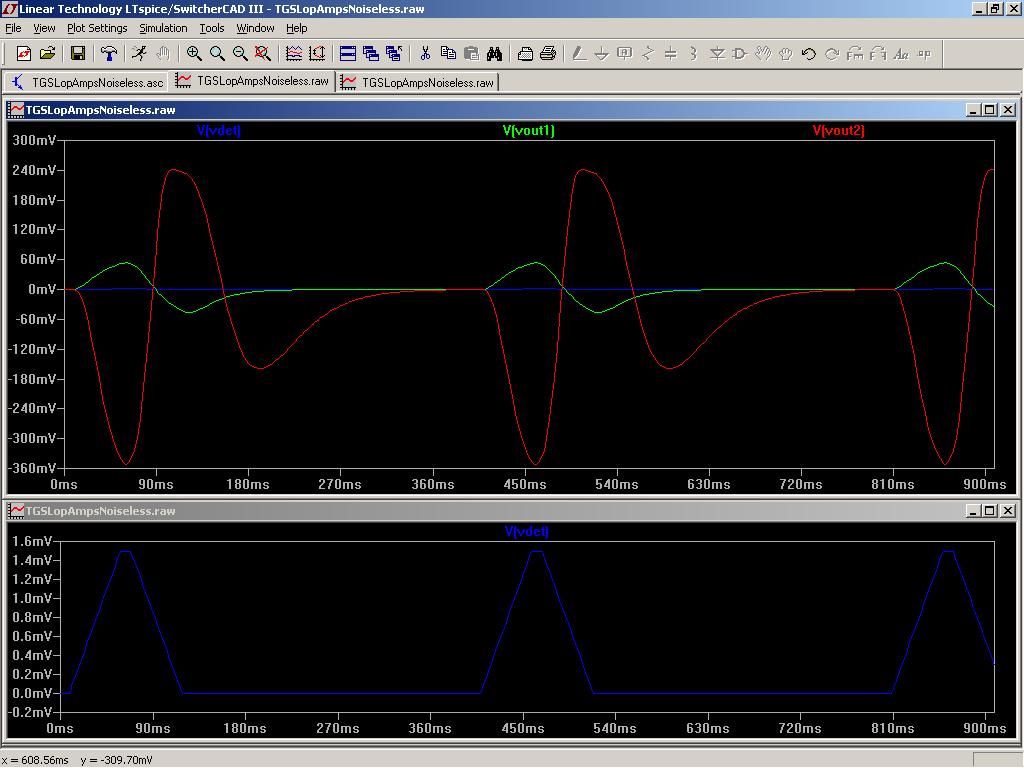

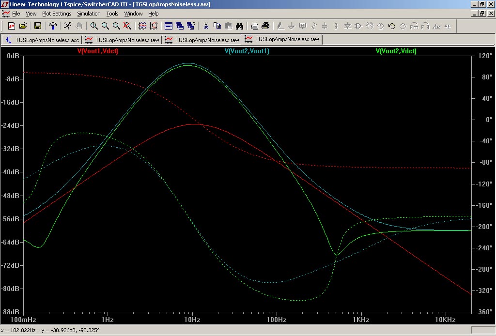

    Today I studied the op amp filter section, LM358 and LM308. Using LTSpice I did a transient analysis and frequency analysis. I used an input pulse similar to what I saw on scope. The outputs were similar to scope also, so seems a useful simulation. No noise on input in this simulation, although I did others with driver noise.
    Picture 1 is the circuit for reference.
    Picture 2 shows transients -- Output of LM308 (Vout2), LM358 (Vout1), and input (Vdet).
    Picture 3 shows frequency response of each amp separately and combination.
    Because input signal is so small, it is repeated in a separate window (bottom) of the picture.
    Interesting that input pulse makes output swing down-up-down. We detect the "up" swing. Notice that it is delayed from the input pulse. I guess designers did that because otherwise they would get two beeps instead of one if detected down swings. Notice also up swing slightly smaller than down swing -- you give up a bit of sensitivity.
    I'm not sure input pulse is accurate for deep coins. Hard to see on oscilloscope, but deeper coins may make bigger up swing than down swing. When near the coil, there is more variations due to coil edges, complicates a little I think.
    Keep in mind this is only one channel. The other channel must have similar pulse to trigger audio. Depends on ground balance, discrimination settings which I'm trying to study separately.
    Our audio is triggered by comparator output. From looking at oscilloscope, pulse for audio is not stretched by circuit, in fact it usually is narrowed because it it the "AND" of two pulses which are not identical, only get overlap. Also, sensitivity and threshold may only select top part which is thinner. So not surprising audio is "weak" sometimes. Maybe there are clues here for improving it.
    Frequency response shows band pass filter centered at about 10 Hz. Tesoro must have done lots of tests to choose that, swinging over coins, etc. But could try different filters to see effect.

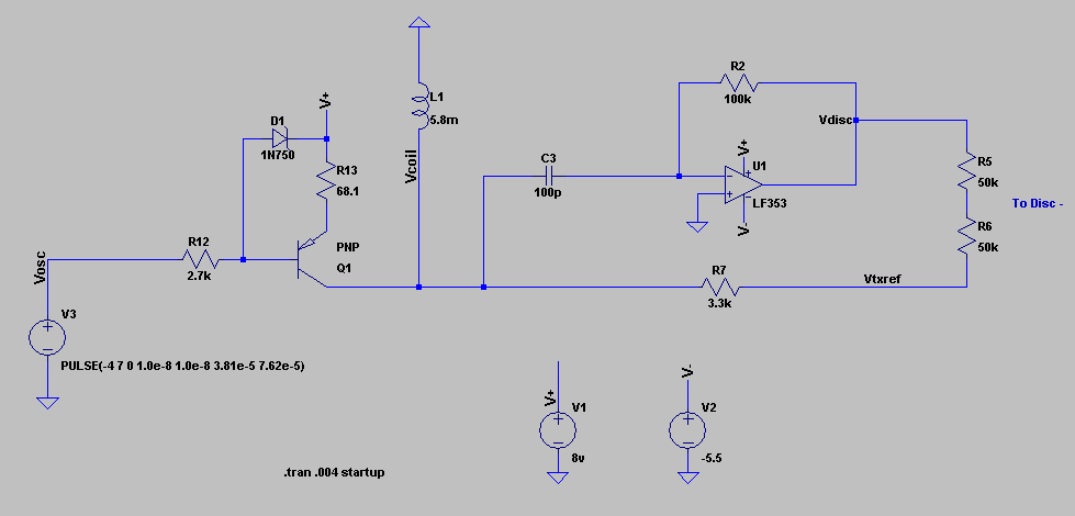

      LF353 disc circuit
      With the TGSL Final I built I'm having some problems so I am analyzing, troubleshooting.

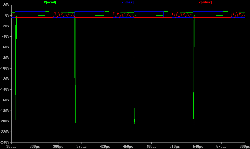

      I get small oscillations on my U101b (LF353 discrimination output pin 1).

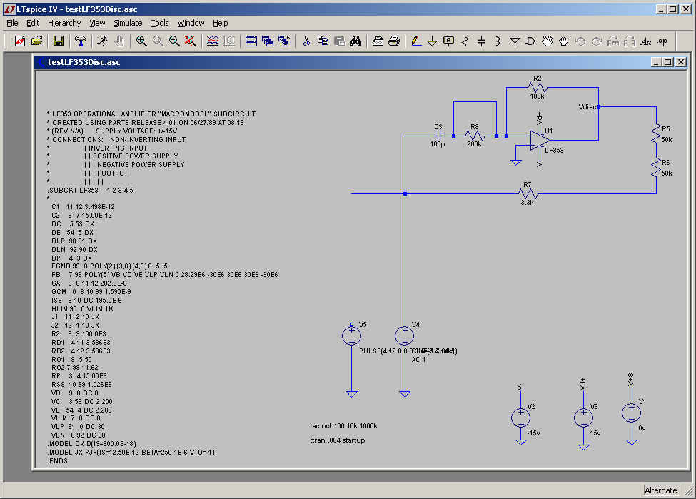

      I made an LTSpice sim of the oscillator and Discrimination preamp and also see the oscillations.
      In TGS thread, I showed simulation waveforms. http://www.geotech1.com/forums/showp...postcount=3627
      (This is not meant to be a criticism of any TGS design or Ivconic's great work, just analysis for better understanding and troubleshooting - I obviously botched that, sorry.)

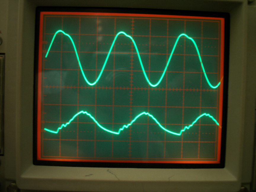

      I see similar, but less exaggerated signals from my actual circuit. See attached photo - top trace is TX oscillator at coil, bottom trace is LF353 output pin 1.
      I thought "jaggies" were due to input range of LF353 being exceeded by TX oscillator. But I experimented with LTSpice and found that the LF353 preamp circuit reacts the same to small square wave. So I suspected "ringing" was cause.

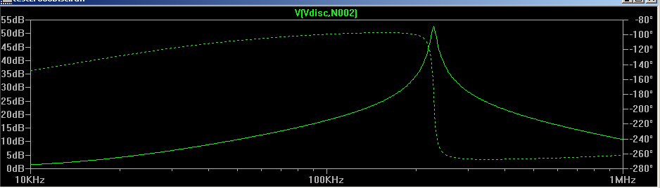

      I did AC analysis of LF353 circuit and see that it has a sharp resonance at 229 kHz. That is same as frequency of small oscillation "jaggies". See attached images.
      So I believe that the LF353 circuit is very sensitive to any non-linearity in the input and can ring very easily if input is not perfect sine. My TX oscillator is not perfect sine and I think that explains what I see.
      I am only testing my built circuit with temporary coil, so it may be causing some of the non-linearity, although the oscillator probably saturates the transistor and some non-linearity is expected.
      I am wondering if there are some other ways to make the LF353 circuit provide the same range of phase shift but have less tendency to ring. An area for experimentation.

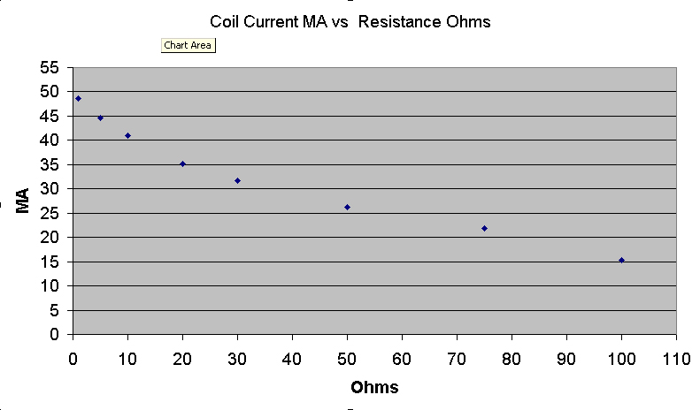

        While working on TGSL Final circuit, I wondered how the resistance of the TX coil affects the current going through it, and thus the magnetic field strength, in the oscillator circuit.
        I ran some LTSpice sims trying different resistances.
        Here is graph I made in Excel showing the current in the coil vs. the resistance of the coil. It may be helpful for choosing wire guage. My test coil, about 30 gauge wire, is about 30 ohms.
        Interesting to me is that lower resistance does not dramatically increase current, but it does give you some boost.

          It is hard to simulate digital components and signals, so I made approximations. See attached images and LTSpice circuit. I guessed that your TX frequency is approx 13125 kHz at CD4060 pin 5, square wave, +7 to -4 v p-p.
          1. It looks like you are driving the TX coil with a square wave? That is actually a design I'm interested in because I think you can get higher voltage and current in TX coil if you have a very high-Q (underdamped) coil and drive with separate oscillator. However, your circuit does not seem to have a capacitor in parallel with TX coil, so not resonant at TX freq I think.
          The TX voltage is still very high, big voltage spikes because of square wave, and overdrives the LF353 even more than original circuit, causing oscillations, so it does not solve the problem. My experiments indicate that it is best to put a lower voltage sine wave into C9 to get smoothest discrimination control with disc pot R18 (R5 and R6 in LTSpice circuit).
          I think your circuit could be good with some modifications.
          2. What was your reason for changing resistors on negative supply?
          I have played with resistors on negative supply also. Different ones will work, but I found you may heat transistors and waste power if not choose correctly so they will saturate very fast. Also resistors affect the amount of voltage spikes on the the "rails" (V+, gnd, V-), although not sure it matters.
          3. I am working on a 180 degree discrimination circuit that also seems capable of reducing the LF353 oscillations because it attenuates the TX signal. I will post some more about it in this thread.

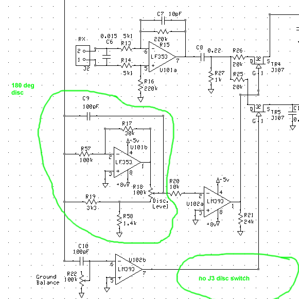

            180 deg Disc
            Attached image is idea for 180 deg discrimination control for Tesoro Golden Sabre. I have not built yet, will be experimenting. Advantage is less parts and wires.
            Also Tesoro new MDs use 180 deg disc instead of disc switch J3.
            However, I have not found easy way to mod TGSL pcb. Disc switch was a very nice jumper!
            -SB
            Spice sim suggests the reduced gain may also solve my problem with LF353 overdriven by TX and oscillations.

                No, I had problem. It seemed easy except one thing -- I can't find easy way to run trace from pin 1 of U102a (LM393) to Gate of TR4 (J107) without major rearrangement, because switch J3 no longer there.
                I can just run insulated jumper across bottom of board, but not pretty!
                If you can find good layout that would be great. I am trying but getting tangled.
                -SB

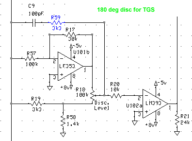

                        TGS 180 deg disc
                        I added resistor R59 (3.3k) to 180 deg disc circuit as precaution so TX coil is never connected directly to LF353 output through C9 - mainly to not drain current from TX oscillator.
                        May be totally unnecessary... other ways to do it also (put between LF353 output and disc pot R18?).
                        Note: All resistors in 180 disc circuit are subject to mods for improvement.
                        -SB
                          -SB
                          I wanted to point on that subject earlier...
                          You noticed, in one of previous posts, an "notch" that occurs at signal when scoped. So i noticed too on few handmades. Later discovered C9 as very critical there. Must be hi quality p.p. capacitor or some very,very good ceramic. Usually i test dozen of those to find most suitable one. This turned to be very benefitial before nulling new coil on that machine (of course there is always some previously finished coil to test machine and check capacitors for C9).I do beleive that was discussed in the past. Must look at first 50-70 pages of TGS thread. Although setup at those versions is a bit different, yet i do beleive C9 is main cause of problem there.
