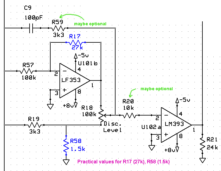

      I added resistor R59 (3.3k) to 180 deg disc circuit as precaution so TX coil is never connected directly to LF353 output through C9 - mainly to not drain current from TX oscillator.
      May be totally unnecessary... other ways to do it also (put between LF353 output and disc pot R18?).
      Note: All resistors in 180 disc circuit are subject to mods for improvement.
      -SB
      I tried the 180 deg disc circuit in my prototype TGSL without the extra 3.3k resistor (R59). It seems to work as expected, disc signal shifts smoothly. I didn't see any effect on TX voltage when pot all way to LF353 output. So maybe R59 not needed.
      If we want smaller shift range, we can add resistors around R18 disc pot.
      -SB
        180 deg disc practical resistors
        180 deg disc practical resistor values, tested OK.
        27k, 1.5k instead of 30k, 1.4k.
        -SB
          Need phase offset to 180 disc circuit
          I think the above 180 deg disc circuit needs an additional phase offset (90 deg?) to make it work like Tesoro models as pot turned -- All Metal first, then iron, then nickel, gold, copper, silver, etc.
          To be continued.
          -SB

                Attached image is idea for 180 deg discrimination control for Tesoro Golden Sabre.
                However, I have not found easy way to mod TGSL pcb. Disc switch was a very nice jumper!
                Good job, thanks.
                Maybe separate pcb can be solution over 4 wire connected to main pcb.
                  Good job, thanks.
                  Don't build yet!
                  I believe the circuit needs an additional +90 deg phase shift for compatibility with TGSL. I am studying a few different ways to do it, trying to keep minimum components and least noisy design. So circuit not quite ready yet! (It actually might work, but strangely).
                  As for layout - separate pcb of course will work, but it looks so far that most of the changes fit nicely on the PCB except for one long connection.
                  I am working on a PCB layout that makes the long connection with several jumpers. Maybe someone can find a better layout.
                  But wait for final circuit first! I need to test more.
                  -SB
                  (BTW: I have another idea that might save components -- instead of adding 90 deg to the above circuit, maybe we could subtract 90 deg from RX signal. This might be possible by changing RX coil resonant frequency to other side of TX frequency -- just a wild idea I'll check into.)

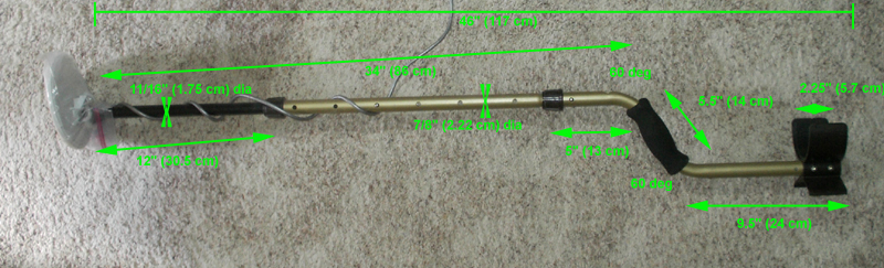

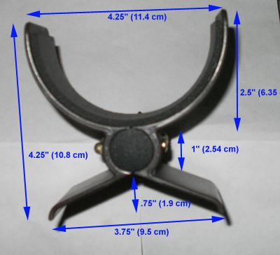

                    Tesoro MD shaft
                    For reference, building your own -- dimensions of Tesoro MD shaft. It is adjustable, these measurements set for my size (over 6').
                    -SB

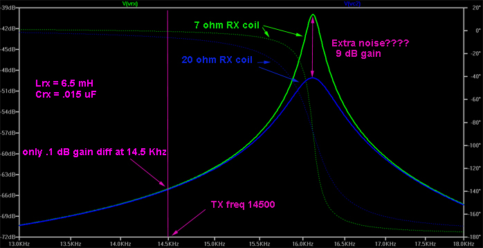

                      TGS Tuning : Rx coil resistance
                      My general goal is to learn as many tuning tricks for TGS designs to make it easier to build a really good TGS with less trial & error and luck needed.
                      One question is Rx Coil resistance (Tx coil is a separate question). We can choose resistance by wire thickness/gauge. But what is best and why?
                      My first thought was to use as low resistance as possible to increase Q of resonant circuit with .015 uF capacitor. I figured this would increase gain. I also thought maybe better signal-to-noise ratio because narrower filter.
                      But now I see maybe this is wrong for basic TGS design. I forgot that Rx resonance is typically set higher than TX oscillator frequency, so target signal is quite a bit lower than resonant freq. Purpose of that I think is it makes received signal phase much more stable, because errors in Rx coil inductance or capacitor will not affect phase much. Of course you lose a lot of gain at the same time.
                      I thought lowering resistance of Rx coil would boost gain. But look at attached graph for a typical coil. If you lower resistance from 20 ohms to 7 ohms (by using 24 gauge wire), you do not increase gain much at the TX oscillator freq (maybe .1 dB). However, the gain at the resonant frequency is boosted a lot (9 dB). The problem is, maybe you are now increasing noise around the resonant frequency without similar gain of target signal; not what you want.
                      Another related problem could occur if you not only lower Rx resistance but also increase capacitor to shift Rx resonant frequency closer to Tx frequency in hopes of increasing signal gain. The problem is you may get too much front end gain which makes the background noise exceed the max sensitivity threshold and gives constant chatters. This may be easily fixed I think though by lowering gain of LF358 stage (reducing feedback resistor?).
                      So lowering Rx resistance does not seem like good idea after all! However, this conclusion depends on where noise comes from. If noise from Rx coil is dominant, this conclusion seems valid. However, if dominant noise is from circuit components, maybe Rx resistance not so important. My own observations are that significant noise comes from Rx coil, therefore, pay attention to Rx resistance, don't make it too low (based on this analysis)!
                      An additional question is: is there an optimal Rx resistance to strive for? It's easy to add resistance.
                      Final thought: I'm interested in exploring a different MD design where the RX resonant frequency is same as TX oscillator freq. This would be difficult to stabilize, but would get maximum target signal gain, and raising Q of RX resonant circuit should reduce off-resonant noise. I hope to experiment with that idea.
                      -SB
