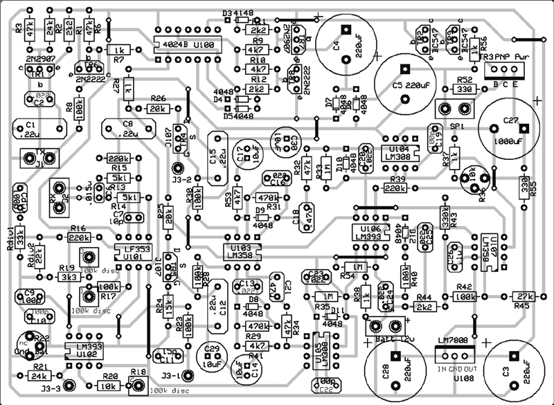

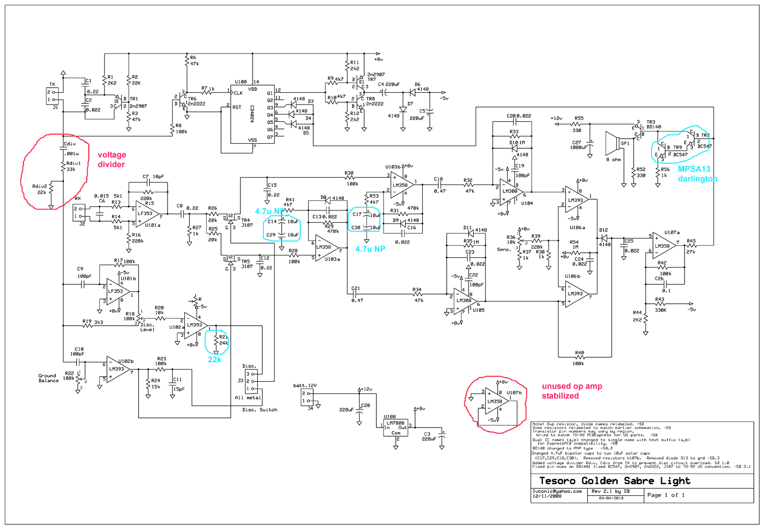

              Hi Don:
              I basically took TGSL Final layout and re-drew it using PCBExpress to fit the .1" perfboard. I will definitely post the files, I'm waiting a little in case I made a mistake which would come out in testing. But so far seems to be a working circuit.
              1. I did add the little voltage divider circuit I mentioned.
              2. removed a couple of resistors off the unused U107 op amp (stabilizing instead with single wire neg feedback according to recommendation I saw somewhere).
              3. used single MPSA13 darlington instead of dual NPN transistors for speaker.
              4. Used 22k instead of 24k resistors.
              Attached schematic shows circuit. Red circled areas shows changes I made to TGSL Final schematic. Green circled areas show parts substitution I made during construction - board accepts either parts.

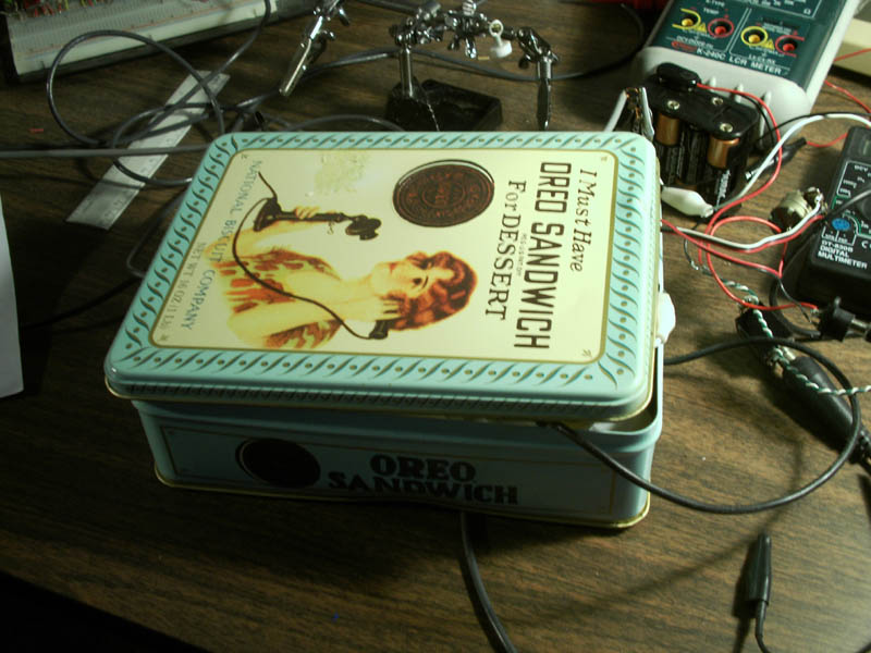

                  Try putting the PCB in a metal enclosure with the case connected to 0V.
                  Not perfect, but I made a crude shield with cookie tin. I did not see enough change to feel it was the main problem.

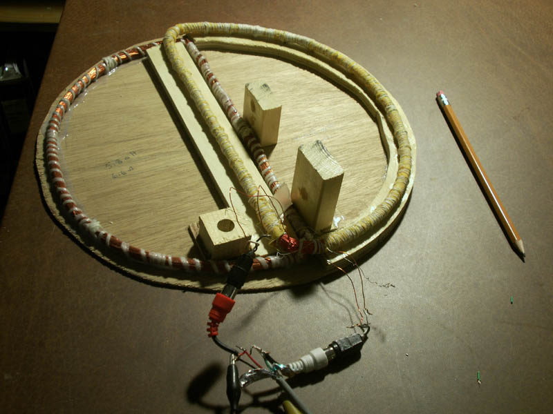

                  So I switched my "adjustable" coil for a glued coil that I made a year or two ago.
                  Here's where I start going nuts. It seemed there was still a low freq oscillation of some kind (at output of LM308s), but a little higher freq than before, and much less sensitive to vibration (like thumping the floor).
                  So I went to bed to continue next day. Today, the signal looks more random, I'm not seeing the clear oscillation, and not getting regular beeps, just more random ones.
                  Could there be different electrical interference (EMI) today? Maybe different temperature?
                  I will re-hookup other coil (adjustable) and see if the beeping comes back.
                  Then I'll continue testing with coils.

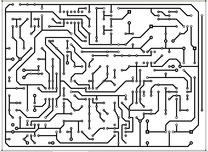

                          • schematic, pcb files
                            Someone was interested in the ExpressPCB schematic and PCB files I used, so I will post them now. Hopefully there are not errors.
                            Screenshots for reference only, not clear enough for making boards.
                            Free schematic and PCB software can be obtained here: http://www.expresspcb.com/

                              • vibrations
                                I reconnected my adjustable coil to check again the beeping problem.
                                I am fairly convinced that it is mechanical vibration, because I can make very large oscillations which almost die out if I wait. It is possible the building has small constant vibrations that never completely go away.
                                So I have nice seismometer which will tell me a few seconds before building falls down.
                                I guess my adjustable coil is not useful unless I find a solid platform for testing. I had better luck before I changed my workshop location to different room.
                                It is time to make another coil I think. My last glued coil is very unusual. I used thick wire so each coil is only about 6 ohms. Probably OK for TX coil (maybe very good), but it makes RX coil high Q and maybe picks up more noise at resonant frequency, and alters phase a little at the oscillator freq.
                                I also used Elmers glue, a common water soluable all-purpose white glue. When I first glued the coil, I noticed the coil really "sucked" after gluing -- it was dramatically worse in depth and response. I was very surprised. I never understood why. Was it moisture in the glue? I just don't feel that would be so important. You can put a chunk of metal on you coil and it will work pretty well, try it. Why would glue matter so much? Did the null change? My measurements didn't indicate significant change. Or was it coincidence, and I messed up the PCB with other tests?
                                However, it has had a year or two to dry, and now it may have gotten better. It works OK with my latest PCB, although still not great.
                                Anyway, more coils you have, the better for testing. Next RX coil I'll make with thinner wire to be more standard.
