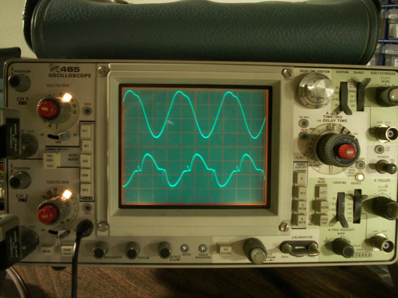

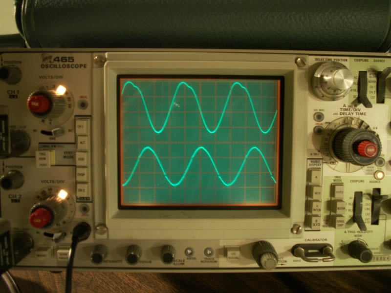

                    • Bad Parts
                      Upper trace is TX oscillator.
                      Lower trace is output (pin 7) of LF353.
                      I could not understand what was wrong with circuit to make such bad looking Vpin7 in top photo. Thought maybe due to bump in TX sine wave.
                      Finally, I replaced the LF353 chip. See lower trace in bottom photo. Looks much better.
                      -SB

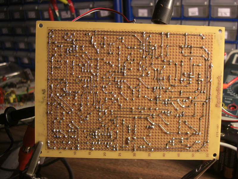

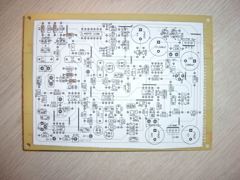

                        I'm continuing basic TGSL experiments using my latest PCB.
                        This PCB is a modified version of Ivconic's TGSL Final.
                        Physical

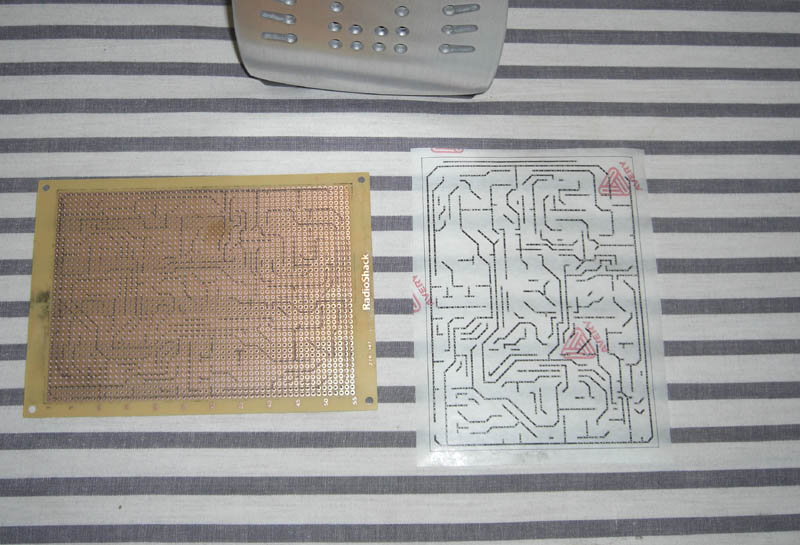

                        I created a layout for a pre-drilled Radio Shack perfboard, .1 inch spaced holes. Board is approx 5.5 x 4 inches.
                        The concept was to build a PCB with no chemical etching. I used a perfboard with copper holes and I soldered all connections manually. Yes it was a lot of work to make the connections, but the copper holes helped provide anchor points.
                        I tried to leave ample space between components for easier testing and construction.
                        Electrical
                        I added one small modification which I like but continue to test to convince myself whether it is good or not. I put a voltage divider from TX oscillator to disc and GB circuits to prevent overloading and oscillations in disc circuit. A small capacitor was added to try to minimize any phase shift. It reduces voltage to approx 1/3 of TX oscillator and makes a small 5 degree phase shift (which could be reduced further by trimming).
                        I also eliminated a couple of resistors at the unused LM358 U107 op amp and used simpler stabilization.
                        I did not have room for the small bypass capacitors that Ivconic added to the TGSFinal PCB, and so left them out.
                        Parts
                        The board accepts back-to-back 10 uf caps if you want for the non-polar 4.7 uf caps on LM358 U103. However, I used single 4.7 uf non-polars. I often wonder if back-to-back electrolytics may not always work as expected, something to think about when comparing our results.
                        The board also accepts the two BC547 transistors in the speaker circuit. I actually used a single Darlington MPSA13 there myself.
                        I also used 22K resistors instead of 24K resistors in a couple of places.
                        In the RX preamp, I used 5K1 resistors, as in the original schematic, not 4k7. 4k7 resistors should give slightly more gain though, something to think about when comparing our results.
                        I added a small socket for a trim capacitor in parallel with the RX coil. I think it would be useful to add one in the oscillator circuit also to adjust frequency.
                        Miniature speaker.
                        Software
                        PCB Layout and Schematic drawing was done with free PCB Express software. I will post files later.

                        I used an iron to transfer a faint outline of the circuit to the PCB to help with connections. See photos.

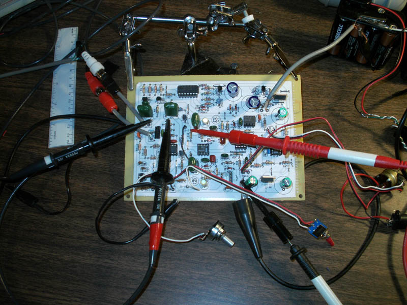

                        • Prelim Results
                          Using my unshielded test coil, adjustable null, I'm getting with new PCB similar to results of previous TGSL Final PCB:
                          Good detection of US quarter around 15 cm. Small beep to 20 cm. Sometimes get crack to 25 cm.
                          I tested to see how critical nulling is. I find nulling is not critical, I get similar depth results in wide range of nulling. This may be because the MD is not too sensitive to begin with. But I have always believed that nulling may not be so critical as we think, but chosen more for other reasons such as stable voltages.
                          I tested to see how critical nulling was to discrimination. I adjusted disc pot to just knock out a US nickel coin. When I moved null point through a range, it did not affect the discrimination noticeably.
                          I took MD outside to see if better environment, less noise. I did not see any improvement, which surprised me. But I will repeat that in another location some day.
                          I am just beginning to experiment with this PCB so have many adjustments and ideas to try. The most important goal is to get a depth of around 28 to 30 cm! I have not achieved that and so far it seems a difficult goal.
