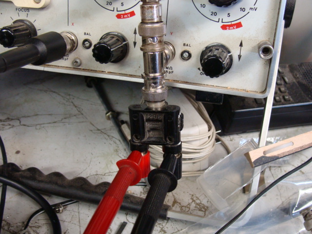

Hi Simon:
Here is the setup.

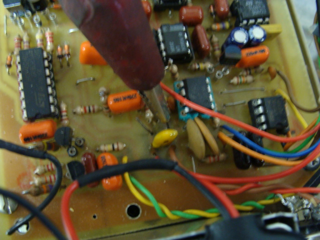

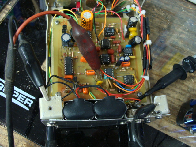

Pic #1 shows the scope probe connected to J2-2 and ground.
the other probe off to the right is for the tx signal and is connected right at the coil cable input connector.
Pic #2 is just a closer view

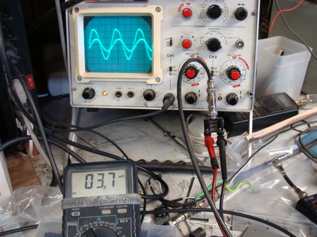

Pic #3 is of the scope and digital voltmeter setup.
Pic #4 is a closeup of the BNC adapter I am using.

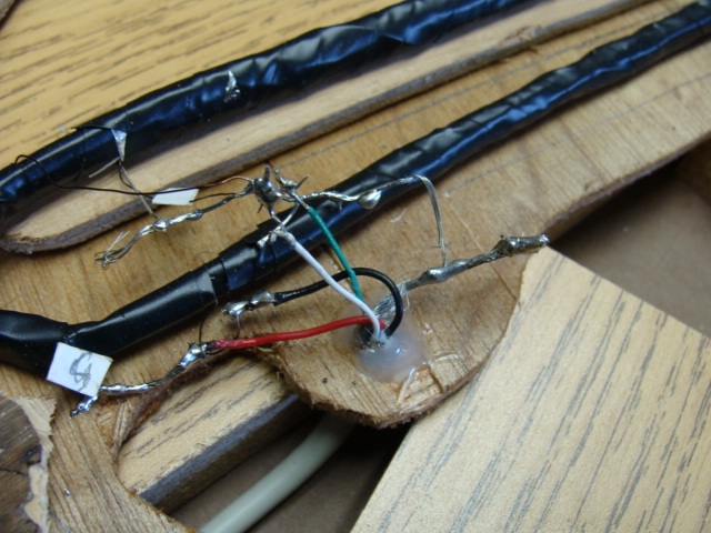

Pic #5 is a very poor camera angle showing the wiring at the coil. The White and green wire are not shorted and are the connected to the RX. The white wire is grounded to the coil shields. Tx is grounded at the PCB.
Note: This is not a good setup for doing air testing. Most anything you hook to the detector is like a little antenna. So I remove when doing a serious air test.
Hope this sheds some light on what I was trying to say.
Jerry
p.s. After taking these pictures, I did a quick air test and it was hitting solid at 30 cm on a two Euro coin with the null setting and voltage shown in the picture.
