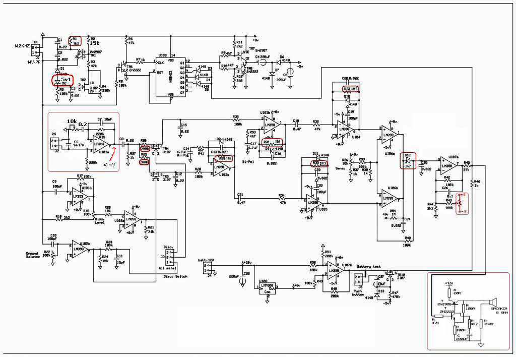

                      This is my modification TGSL, the sensitivity is 1 EUR coin about 34-36cm in air with 27DD coil, a small gold ring - 30cm, Turkish silver Aspres (5 mm diameter) - 25-27 cm. everything is measured by the DISC. mode (3.5-4).
                      The device has excellent discrimination and good GEB, on the ground shows the tendency of putting the occasional false signals (peak), but not so hard to work. I am pleased with this modification and the number of finds of Roman coins.

                          Thanks for showing these mods, I will study them and maybe try some out. Some I have seen before. The variable gain resistor on the LF353 preamp looks interesting for tuning coils with different gain.
                          Some of your mods appear to slow the response of the basic design, which may help for deep targets but make pinpointing more difficult; e.g. the 200K resistors for R25, R26 instead of 20K.
                          I have trouble reading some values for the audio amp because of the image resolution though.
                          Also please describe the details of the coils that work with those mods.
                          TGSL is a very good MD and also a good starting circuit for trying mods like these to suit different tastes.
                          -SB

                              The values for the coil are the same as the originals, I will try soon with other values, after that I will give my comments on this modification.
                              • Oops, I made a small mistake ..... this is a tone circuit that I used, I apologize.
