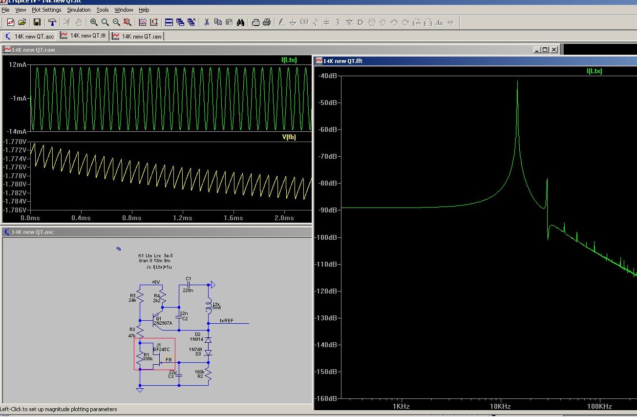

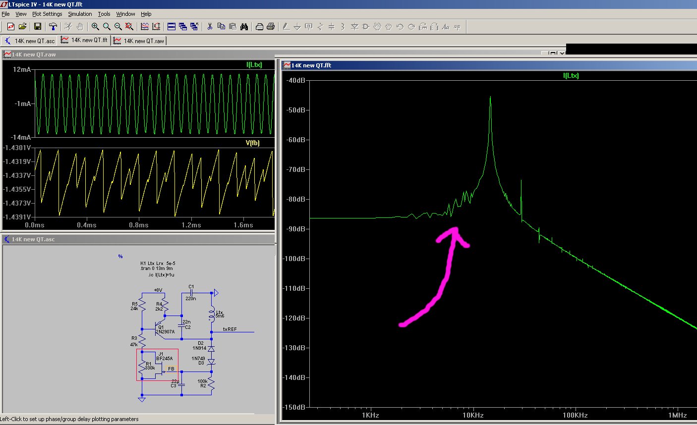

                  • If you are using a feedback FET, using an incorrect FET could cause trouble. The amplitude feedback network can easily become unstable.
                    The coil current amplitude variations are hard to see in my LTspice screnshots, but the FET gate voltage and the spectrum displays show
                    possible noise in grand fashion. The only differences are that one circuit uses BF245A and the other uses BF245C.
                    You would see a similar difference in comparing between 2N4393 and 2N43931.
                    Differences in coil "Q" and some other things will affect how likely you are to ever encounter this situation and I can't hope to cover every aspect.
                    I'm just trying to point out a possible pitfall for the builder.
                    edit: I pickled this post off before I was ready so I had to go back and edit the photos. And, my simulation "zero time" is not actually at turn on but
                    would occur after the circuit has been running for tens of milliseconds.

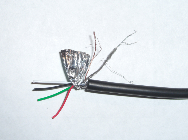

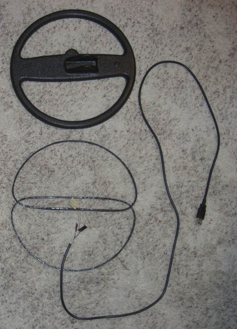

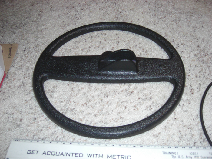

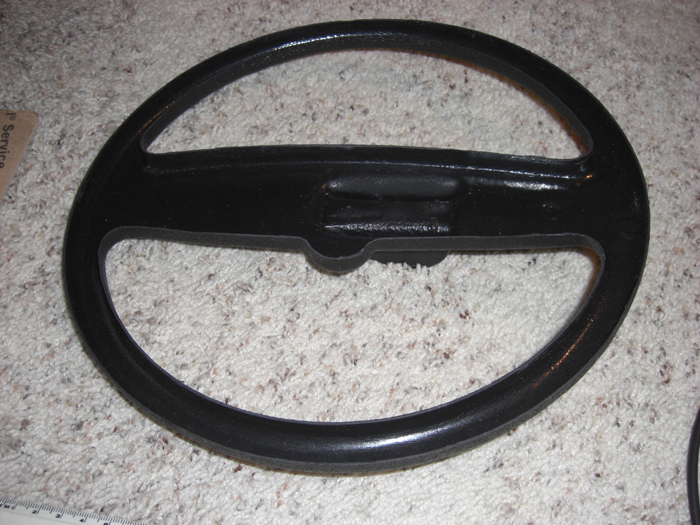

                            • It Arrived!
                              Coils from dfbowers arrived. Many thanks Don!!!!
                              One Euro coin is on it's way from Stefano - many thanks Stefano!!! Dennis the Menace also offered to send Euro - great thanks there too. Appreciate the community spirit very much - it's fun and it will help a lot.
                              dfbowers craftsmanship is very high - my workbench is in awe. Coils arrived beautifully packaged.
                              I was amazed how light the package was.
                              His technique for winding and gluing coils is quite unique as described elsewhere, resulting in square-shaped cross-section. The coils are very light and thin (not shielded), and nicely stiff and hold their shape well.
                              Coil diameter is about 26.5 cm.
                              From my measurements, wire thickness is 10/1000 inch (.25 mm, 30 AWG) with enamel insulation.
                              Along with the coils is the plastic coil shell he made, I presume using his home-built plastic vacuum forming machine. Very, very light and attractive, with a nice molded mounting bracket for the pole. Maybe he can describe how he fixes the coils in the shell.
                              It seems he has implemented the designs of Ivconic, Max, and others excellently and has found their designs to work as advertised. He says his tests indicate these coils give air depth around 29 cm with his TGSL PCB. I will now work to achieve that somehow with mine.
                              I did something dumb, and removed coils from the shell to photograph them, and forgot to clearly note the orientation he set up for me. However, I think I put them on the floor in same orientation, and hopefully I can restore that orientation from my photos and by nulling and testing.
                              It will take some time to see how the coils work with my PCB and to use them to troubleshoot and tune some of the issues I have. My main issues are:
                              1. depth
                              2. beeping (motorboating)
                              For now I am just taking some photos to put here and some preliminary measurements.

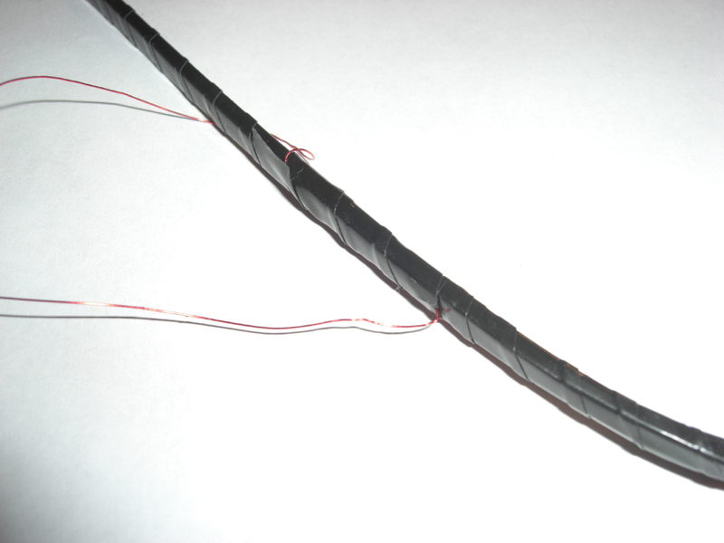

                              Dfbowers kindly attached a USB cable to the coil (as he normally uses). I cut the USB connector off the other end as he suggested and prepared the wires and took photos (see attached).
                              The USB cable has a really robust outer shield consisting of three parts: braided silver outer shield, copper ground wire, inner foil shield. The four signal conductors inside do not have separate shields.
                              (I had previously tried a cheap S-Video cable from China and was disappointed that there was no shield at all, only a ground wire and signal wires. So much for trying to save money.)
                              I took some preliminary measurements of the coil-cable combination. This is what my meter measured:
                              coil1: (black wire -to-shield) 25.7 ohms, 6.82 mH.
                              coil2: (white wire-to-shield) 24.5 ohms, 6.35 mH.
                              red, green, and shield wires are connected together at coil head.
                              So it seems coil2 is the TX coil and coil1 is the RX coil.
                              QUESTION
                              This is a question for coil experts: dfbowers grounds three wires together at the coil head - one of the TX coil, the cable shield, and one of the RX coil leads.
                              My question is: is it normal to ground the TX lead to the shield at the coil head, or only at the PCB, or should it matter? At least we know it works well for dfbowers!
                              I look forward to playing with these coils in the weeks ahead. Anything I learn I'll be sure to post here, maybe something will be useful for others.
                              Thanks again Don!
                              -SB
                              • TGSL airtest, 1e @ 30cm
                                Simon,
                                I uploaded a short video. I tested the coils that I sent you and performance is about the same as the posted video.
                                About the grounding.. I normally ground the shields to the point where the three wires are joined, just like Ivconic has documented in his TGSL coil making PDF.
                                Also, interesting inductance measurements you have taken. It tells me that maybe my method is a little off.. but I did measure the coils before I attached the cable, so maybe that is a variable. I will see if it makes a difference next pair that I make.
                                Don
