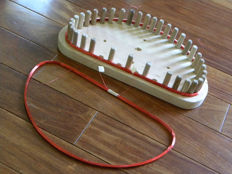

                • Originally posted by climb View Post
                  dfbowers, how to order your coil enclosure to EU ?
                  Hmm.. Haven't thought about selling any yet. Maybe if enough people want one I might make a few more.. I would have to know what the most popular inner dimensions of the vertical tabs are for mounting a pole and how deep to make the shells for the coils. I customized mine for one of the Tesoro rods and to fit the dimensions of my own coils. You would also have to find a suitable strain relief.
                  Plus, they don't come out perfect.. but good enough for coming out of the wifes oven!

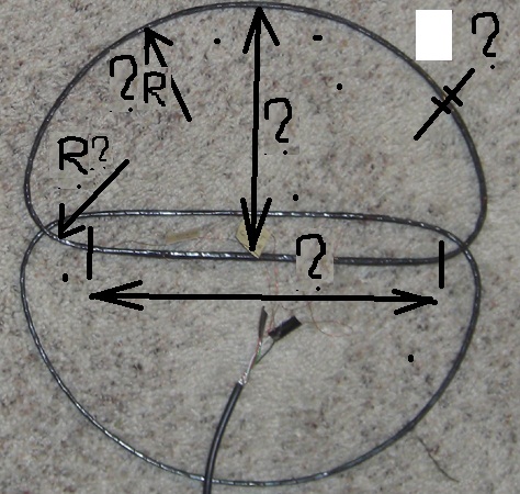

                        19mm is a common inner dimension for the stem fixing.

                                One thing I've notice is Ivconic and dfbowers and others have coil start and end in the middle of the straight section, whereas I always put it at the corner. However I don't see yet that this should matter much.
                                I pondered the differences too. Most commercially made coils have the cable exit somewhere away from the center. There must be a reason. Also, I don't know if it makes any difference on where the gaps in the shields go.. it just seemed to be a convenient place for the wires to exit.
                                Anyone have any ideas?
                                Don
