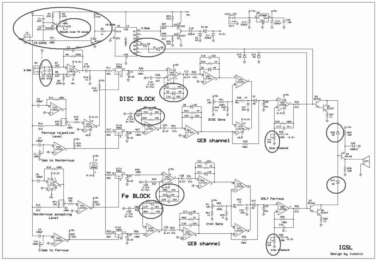

        • Hi you proberly all think I lost it again but I did ivonics mod on the TX circuit changing the two resistors and adding a 10k pot to get a nice waveform still using the 2n2222a and the 2n2907a and now it wont oscillate, I double checked my wiring, so easy yet not working, is there something ive overlooked noticed ivonic uses a bc547 now, but that shouldnt make any difference should it?
          By the way for a matter of interest whilst using a plastic unscreened housing dont advise anyone using the the metal type oscillator transistors get lots of falsing, with plastic very stable .
          So wheres my problem in this simple circuit?
          Remember im running at 14khz because im using Tesro coil specs ref 5.7/6.2 mh
          Thanks in advance

            Mod is valid only for Musketeer coils specs and newer Tesoro coils specs - but not for older Tesoro coils specs.
            Will not oscillate with 6mH coil and given tank values.

                    Can you post here schematic (only that part of it) of what mod you applied and with what coil, and what would you like to achieve?

                      Its the adjust nice TX sinus part of the circuit, I did the modifaction to my TGSL and the oscillator went dead, changed RI to 560ohms R2= 22k and substituted the other R with a 100k preset, What did I miss? the only difference I can see is you used BC547 instead of the 2N2222A which in my eyes shouldnt matter.

                        Have you checked the pinout?
                        The BC547 is in a TO-92 package, and the 2N2222A is in a TO-18. You might have it flipped over.
                        • Before switching ON your detector; adjust 100k preset to middle position, because if that values is to low - oscillator will not start at all.Than, later you can fine readjust it, by observing TX signal on scope.
                            thats exact what i did- when you turn trimmer to high there will be no more signal
                            if you find that point turn a little bit more down and you got a good summing sinus can haer it when speaker or headphone connected
                            when nulling coil with oszi you can turn this trimmer and see that effect at display
                            it seems that it can effect the null voltage
                            i think that was what ivconic meaned when he marked this point on shematic with the advice 'set to nice sinus'

                            • I tryed all that adjusting etc, must of knackered the TR when soldering, I did it in a rush in poor lighting in home, instead of workshop with all my tools.
                              Anyway intended to go back to the plastic type 2n2222A 2N2907A because I dont get the chirps with them.
