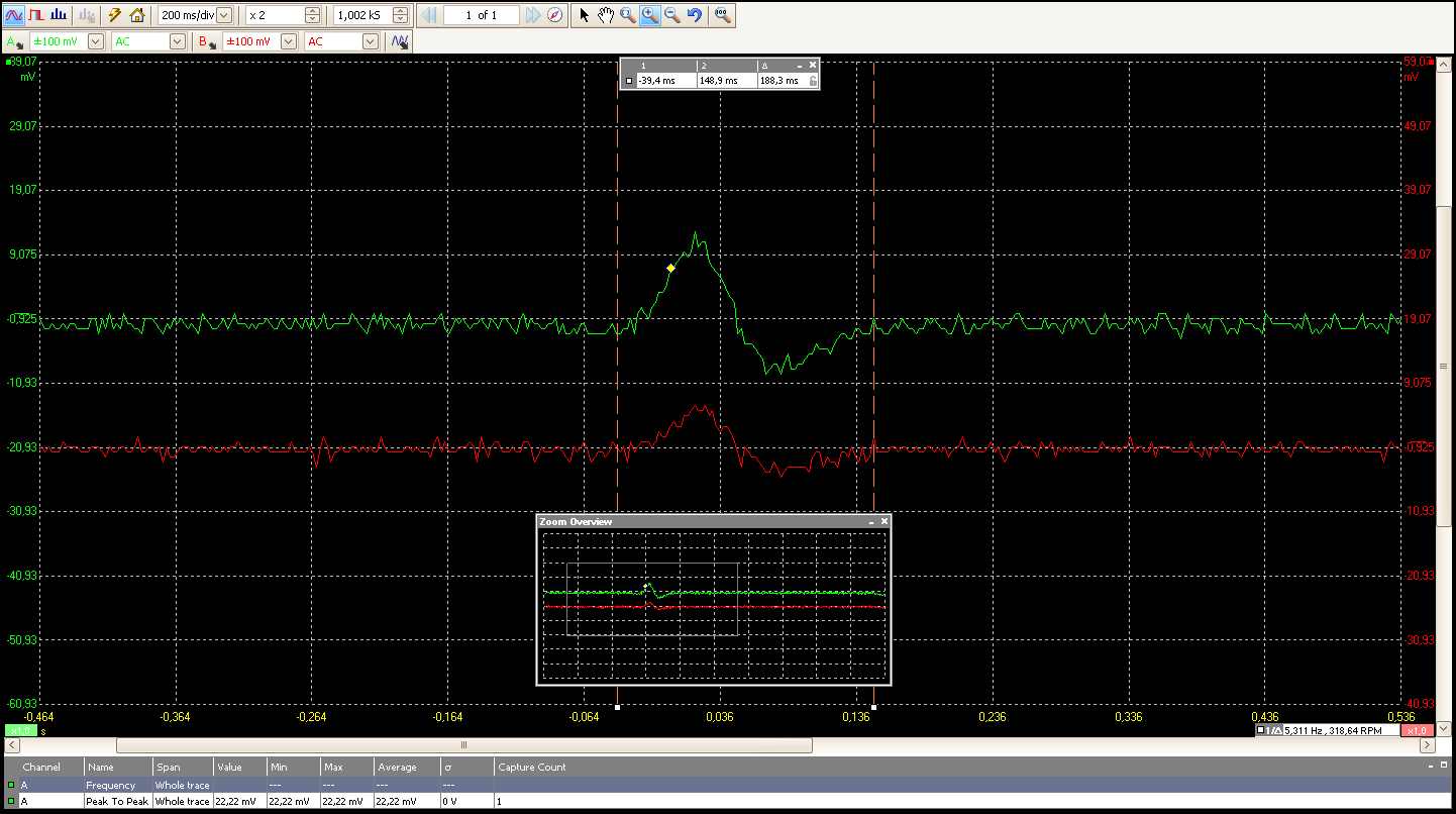

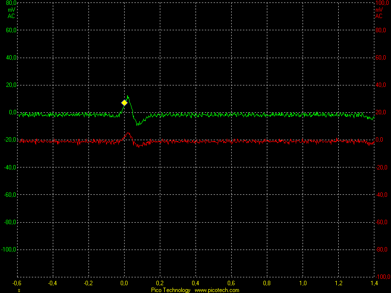

    Hi Simon ,
    I have the 'old' TGS pcb from Kurtie without any mods ( yet )
    Whenver I'm around a ElectronicShop I'll buy the components needed for the test

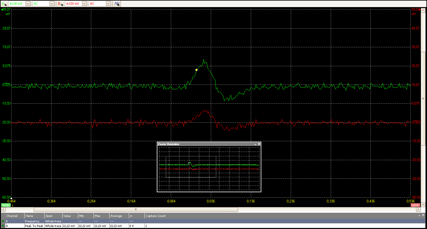

    See the next picture : this is the signal of both FET's with a 1 euro passing at about 3 cm ( Uc12 & Uc15 )

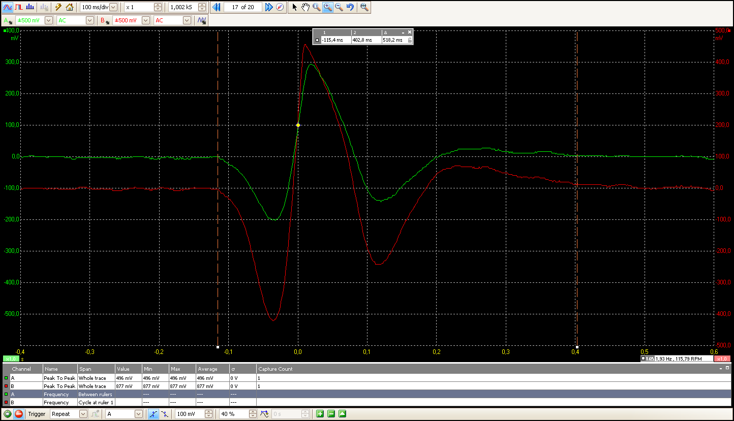

    You also asked for a more detailed graph of a target signal at the LM308 output :
Name:	LM308's -  10 cm.png
    Hope this one will do ?
    This a 1 Euro passing at about 10 cm .

      That is great, thanks!
      Very interesting to see how far negative the signals at the JFets go -- I wonder if it would be the same at greater depths. I guess it might.
      But it seems we will have a hard time knowing without some special filtering -- even with amplification, there will be too much noise to see unless we use your "cannon ball" approach.
      Is there a smoothing filter that would not introduce significant dynamics into the signal but would bring out weak signals from the noise? Maybe...
      -SB

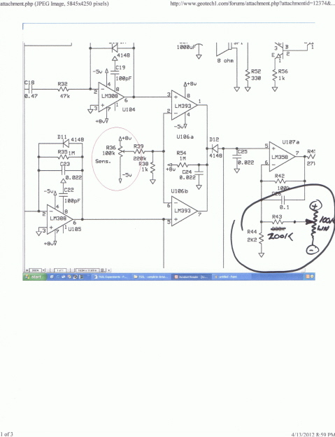

        I like having a background tone or noise of some kind when metal detecting. It lets me know that everything is working and it is possible to hear the tiniest of changes for potential targets. Ivconic touched on this several years ago when he added a threshold control to the TGSL but it never made it through to the final design. It appears again in the IGSL.
        A couple years ago, I did the dfbowers mod for sensitivity. (see below) This worked but I was only able to advance the Sens control to about 6 or 7 before the detector became unstable.
        The addition of the Threshold control in addition to dfbowers mod makes it possible to run the gain much high yet have a fairly stable detector.
        The addition of the 100K pot and 200K resistor are from the Tesoro Lobo schematic
        W.L. 6/90. Nothing really new here on my part, just copying ideas from others and seeing how they work.
        You can work the Sens and Thres controls in tandom advance one reduce the other, etc.
        I find that I gain several more inches of depth.
        Jerry

          Glad you got a chance to try it and report -- thanks! Something to put on my list of tinkering subjects...
          Cheers,
          -SB
