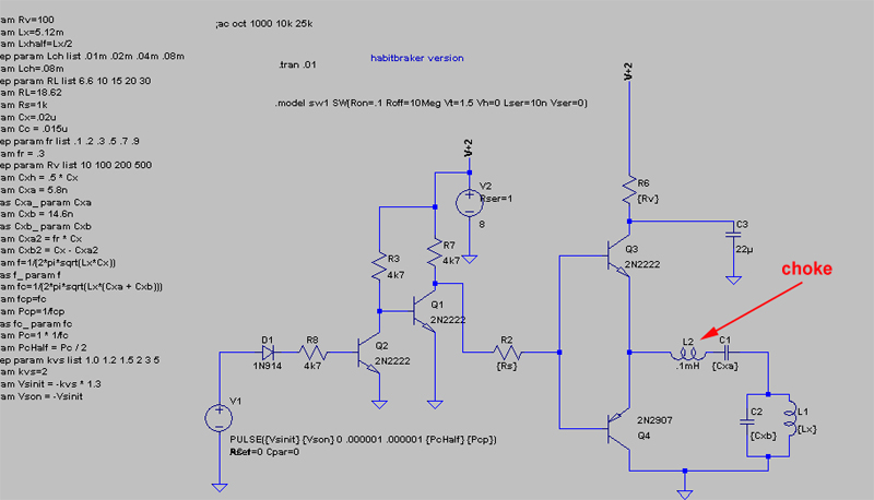

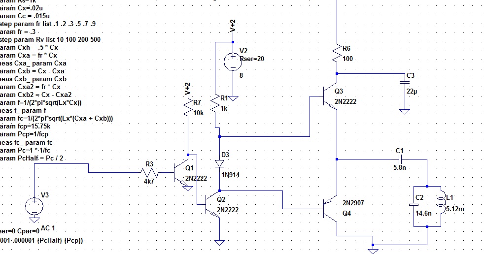

                        about that push-pull circuit - I plugged it on the breadboard and tested a little bit. One question -whayt circuit did you actually use? I made a little modifications to convert to bipolar (my gen output) to single. Also removed those emmiter resistors couse imho it doest make big difference (that I can see - just lower voltage). But maby im wrong there - needs testing.
                        This is my final circuit:
                        Resonant circuit is tha same. f0 now is little lower - from 15.9 to about 15.7khz.
                        L1 dc resistance the same - 18.62ohms
                        Power supply - +8V regulated. from 12V battery
                        It gave interesting results - when input is lower than about 2Vp2p then output suddenly drops to zero. same in spice. Its not suprise because of two input diodes in series...
                        But most interesting is that biggest output voltage is when input is about 2.3Vp2p (just about cutoff point) If I increase it further (i can increase it up to 5.5Vp2p) output voltage decreases. It lowers to about 35Vp2p. In spice I dont see such decrease with increased input..
                        This is simulated, vs real life(input 2.3Vp2p. f0=15.75KHz, sim output=53Vp2p, real output=about 49Vp2p. (10V/div)):
                        (I hope that I didnt ruin whole page because of this long picture)
                        Pretty close I think.
                        Maby output stage needs a little biasing - to get rid of that nonlinear step in sine wave?
                        I didnt test any more - maby you could give me beter circuit and instructions what to test so that it could be more useful for you and TGSL modifications. Im big fan of TGSL and your work - thats why im doing this. All setup stays on my breadboard - so any change will be 1min question - yust ask.
                          I'm currently driving my push-pull directly from my signal generator with a 0 - 3 V square wave, through the 1K resistor. I didn't use any other driver transistors as you did, though that seems good if you need to isolate your voltage source (which I might, as I plan to drive this from a microcontroller output port -- we'll see if necessary).
                          Is diode D1 useful? What is the purpose?
                          Because I want to be really cheap with battery power, I would like a driver that takes as little current as possible. But your arrangement looks pretty good (maybe only one transistor stage needed???), and takes the voltage pretty low (around .2 V probably?). I'd of course prefer going all the way down to the ground rail if possible.
                          There is an asymmetry in using the driver transistors however -- in the "high state", the push-pull is driven through 4.7K + 1K, and in the "low state", it basically is driven by just 1K (sink). So I'm not sure whether that is the preferred way to drive the push-pull.
                          I don't actually put those emitter resistors in the real circuit -- I just put them in the simulation so I could measure the current through the branch -- I didn't know how to pick off the transistor emitter current in LTSpice, but I think I can now, you just have to move the cursor carefully. So I'm same as you with real circuit.
                          Not sure why that happens either, because it seems your transistor drivers act like a switch that should make same pulse regardless of input voltage. If your signal generator changes frequency for some reason, that could cause it.
                          That is outstanding agreement, so I feel hopeful that this can be a useful circuit, I appreciate your confirming it (and making a superior practical circuit).
                          One little addition I'm studying, but I can't convince myself whether it is useful or not -- that is a small choke coil in the branch to the resonant circuit (see attachment). In the LTSpice simulation, it seems to cut down a current spike, but on my oscilloscope I never see that spike. And in the real circuit (and LTSpice), the choke makes some little oscillations that perhaps could cause some noise problems later on. So just an idea.
                          My other questions are what are the best component values, resistors and even the resonant capacitors. You can increase the current in the coil a little with some different values (depends on impedance of your power supply though), but the values I picked so far seem to be a good tradeoff between battery consumption and coil current.
                          Your tests have been very helpful for sure. I'm going to try soldering up a protoboard circuit and try to work it with a microcontroller -- will probably take a long time because I'm new with the microcontroller.
                          If you have any other thoughts or ideas, let them fly.

                          • Hello again SB!
                            Thanks for tha answer.
                            Now I undersatand what was your circuit. I used this, because my generator dont give single polarity square wave so transistor was needed. With single transistor there was lower output voltage (i think you are correct- it didnt rail up and down completely). Also correct about C resistor influance on driving current.
                            About diode- well, in spice it works without (and in real also might), but those small signal tr (I used BC547 instead of 2222) have B-E breakdown of about 6V so if driving with bipolar square - all negative (for npn) part drops on this b-e. So just protection...
                            I will try to find if those drivers output change when input is change. About frequency - I dont think that it changes when output level is changed. Something else.
                            About choke - Ill try something
                            What mcu are you using? I have some exp with PIC micros and also have way to program those. You are planing to drive push-pull with it? Just generate pulses? That could be easy to code - so i coild try it also. Also it could give better stability (using quartz) and nicer driving squares. Also single polarity, so eleminates those drivers.
                            Anyway - I will try
                            oh I forget - that test circuit current consumtion was about 9mA.

                              I have the Texas Instruments "LaunchPad" MSP430 platform ($4.30 mail order!) that comes with two processors (one with a 10 bit A/D converter), an optional crystal, and some headers for interfacing with a PCB/protoboard of your making. They got me because it was so cheap -- but lots to learn.
                              The processor operates on about 3 volts, so I plan to drive the push-pull coil circuit with an output pin (0 to 3 volt square wave). I may need to think about pull-up/pull-down resistors and/or current sourcing capability (I think those pins can source enough mA, but will need to check). So I may need extra transistors like yours.
                              I can optionally use a higher voltage for the coil, or the same voltage for the coil push-pull and microprocessor. I'd like to check out using the same voltage first.
                              To not be naive, I realize that the MSP430 is probably a hundred times too slow, the A/D needs 10 more bits resolution, the memory is a hundred (thousand) times too small, and a hardware multiplier would really help. It will be interesting to see what can be done, all tricks fair play.
                              There are upgrade paths to somewhat more powerful MSP processors, but still not really powerful. The nice thing about the MSP430G2231 (the chip I'm planning to use) is it costs about 25 cents! I like cheap.
                              I think it's pretty amazing to get that kind of coil voltage for 9mA. Tweaking component values can get other tradeoffs as mentioned before.
                              I'll be interested in anything you do with the circuit.
                              -SB
                              • Hello SB!
                                I played a little with my circuit today too.
                                I found reason why output voltege was lowering with input increasing - my sig gen fault. Its dutty cycle was changing when level was changed. Well it is DIY anyway Sine output is perfect at least.
                                I tried a small chokes in the output - didnt see improvements. Small oscillations appiered instead of sharp edges.Or Maby its better ?
                                I coded a fast pic code to generate 15.75Khz square and put it on the input. Output still 50Vp2p.
                                It connected other coil to the scope (10n parallel) and tried nulling and it looked very good. I could manage almoast zero null voltage. It was just fast and dirty test - didnt even remember actual numbers
                                One interesting thing. In ltspice this diode (see attachment) added 7V p2p (almoast 60Vp2p), but in real circuit it didnt make any difference. I dond know why. Even not shure what this diode does in sim?
                                I have one blank eduardo PCB. Maby it is worth trying solder one but instead of colpitts use this oscillator? But Im too lazy to solder right now . Its too early i think..
