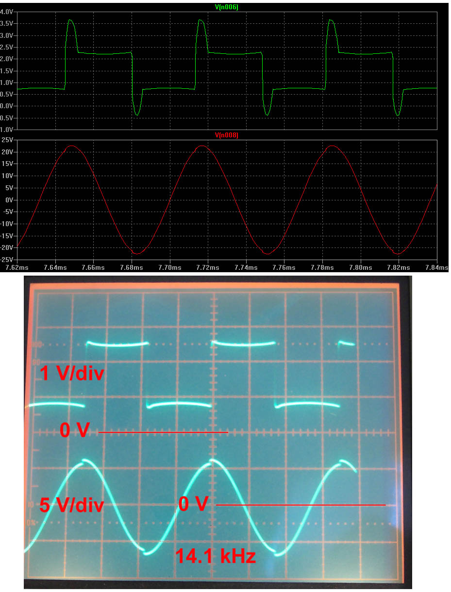

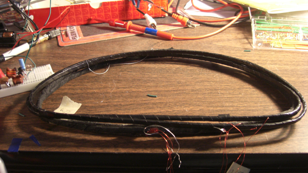

      • The Phase shift of Tx and Rx in relation to the thickness of the shield isolation ?
        Experiment with 4 scope image clips added:
        The Phase shift of Tx and Rx in relation to the thickness of the shield isolation :
        * DD Coil ( model Ivconic '09) parameters : Tx = 5.9 mH and Rx = 6.5 mH
        * Default values for capacitors .
        * Scope images are measured on output of the LF353 ( pin 7 U101a) .
        Why didn't I get the desired (aprox) 20 degrees phase shift between Tx and Rx during nulling with a reasonable residual voltage ?
        I've tried a capacitor bank for tuning both Rx and Tx : didn't get the 20 degrees , not even close .
        What the heck was going on .... The sheep curse ?
        Recently I've tried a thicker isolation between the coil and shield with a great result :
        I do get the 20 degrees ( aprox ) phase shift .
        For isolation before I've used only a small 3M black isolation tape between coil and shield and sometimes no tape at all but the shield direct on the coil.
        I've used a stripped RG59 coax cable , perhaps too thick but it was worth the experiment , anyway now I did get ( almost ) the 20 degrees with just the normal capacitor values for Tx and Rx.
        Calculation for usec for 20 degrees = ( 1/ 14000 ) * ( 1/20 ) = 3,57 usec
        In clip 1 both coils are unshielded : http://www.youtube.com/watch?v=3hY4s6_cKw4
        - Almost 'perfect' phase shift and I used these coils only for test purpose .
        Even when the residual voltage rises or lowers the phase shift remains almost the same.
        In clip 2 only the Tx coil is shielded : http://www.youtube.com/watch?v=zZTDKBd3Gn0
        - The lower the residual voltage the bigger the phase shift.
        In clip 3 both coils are shielded : http://www.youtube.com/watch?v=iJKx8JJ1A8M
        - With Aluminium kitchenfoil direct on the coils .
        Even more phase shift when the residual voltage becomes lower.
        In clip 4 both coils are shielded : http://www.youtube.com/watch?v=N7yrp8l_fSU
        - BUT between the coil and the shield I've placed some isolation :
        I've stripped a RG59 coax cable and used this as isolation between the coil and shield , perhaps way to thick ... ? Try for your self ...
        The first part of the clip are the images of the Rx coil direct vs the output the LF353 ,
        the second part as shown in the other clips Tx vs output LF353.
        Conclusion ( for this pcb and coils ?):
        When your unable to reach the 'desired' and stable phase shift and your pcb components have all the standard values : first try the coil isolation ....or keep it in mind at least.
        kind regards
        Dennis the Mennis

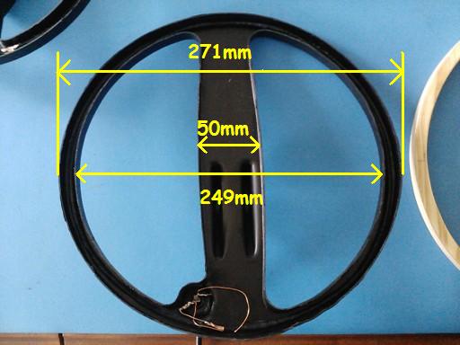

        • hi everyone
          i'm still trying to perfor my tgsl but still poor deapth. got few questions to ask.
          firstly mayby stiupid question...but is all pots in circuit (i mean sens geb and disc) are lineal or logarytmic:P? i'm asking because i have a strange behaviour when i turn them up or down...also they induct a lot of noise..maybe shealding connection will help
          another thing... is there a new nice way to check the coil without a scope? i have only good multimeter without scope function and i hear that voltage drop on rx should be as close to "0" as possibe (maybe i said something wrong but it's a lot of posts to reread:P)
          i would also ask for dimensions of coil plastic chasis if someone has the, because i would like to build my own:P
          sorry for mistakes..
          best regards to all
          • Originally posted by lunamay View Post
            hi everyone
            best regards to all
            I don't think that it matters if your pots are linear or log taper, the adjustment position will be different. I have used both successfully. Pots that are incorrectly adjusted can cause all sorts of strange things. Once I get mine setup right, things work great. Particularly, the GB pot will cause the TSGL to work incorrectly or not work at all.
            As far a voltage drop being close to "0" are you referring to nulling?
            I check my coils first with a scope. I hook them to a small signal generator and I can determine inductance that way. If you are interested, I can show you how to build a small signal generator from a 555 timer and a handful of components..Very useful for cheap!!
            Also, I think I have pretty much nailed the optimum coil shell size. This comes out to be 13 ounces at most. These dimensions are for the INSIDE so it's the size of my wooden former. The distance between ears is 19mm (fits Tesoro rods perfectly). The dimensions below are for Ivconics coils in the "TGSL coil making" .pdf . I also use the attached pattern with a perfect fit.
            If you cannot build one I may be able to provide you with one.
            Don

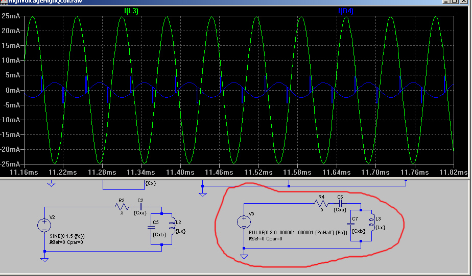

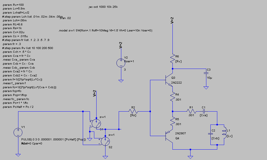

                    In my simulation with the square wave driven circuit, the current signal through the coil looks nice and sinusoidal, although the current through the resistor has a spike (which may not be bad). The current spike may be the pendulum "kick" that I was looking for - an efficient way to keep the pendulum going.
                    I'm thinking that maybe a square wave (with possible duty cycle tweaking) may end up being the most efficient way to drive a TX coil. Even though a sine wave may have a better "transfer" efficiency, creating a high power sine wave (which typically takes class A or AB amplification) may be quite inefficient and you lose much more than you gain. Square wave pulses basically can be created with class C or D amplification which is much more efficient. It may turn out that the higher frequency harmonics of the square wave do not represent power loss - they simply are attenuated by the RLC tank and contribute no current.
                    The impedance matching question is interesting. I often wondered about putting a transformer between the TX coil and the oscillator, but that might be the same as a tapped TX coil with the tap at a judicious location - also a design consideration. For square-waves, it might mean increasing the square-wave voltage until the law of diminishing returns sets in.
                    It would be useful to model a battery driven sine generator and pulse generator and then graph the power actually being taken from the battery for a given TX current. That might help put the design tradeoffs in perspective.
                    -SB

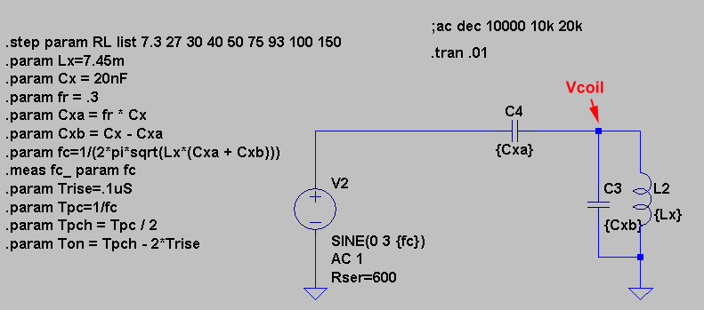

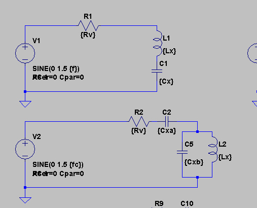

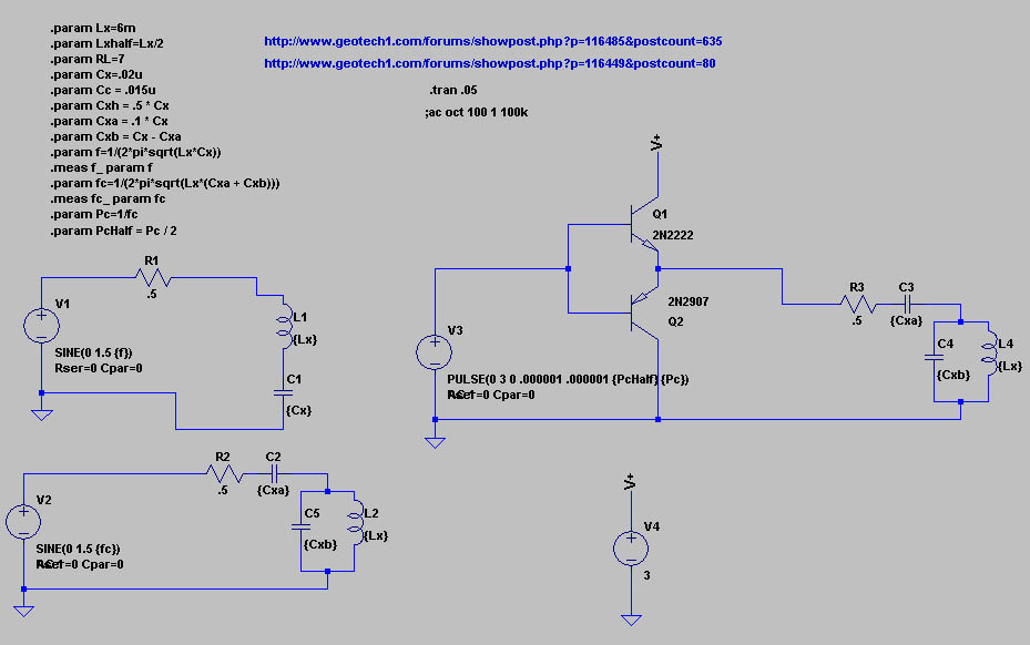

                      Following up on subject of coil-driving circuits, I did very informal comparison with LTSpice, and here are some impressions:
                      I compared simple series RLC circuit driven by sine wave with a series/parallel circuit driven by same wave.
                      Rv represents the impedance of the voltage source.
                      The coil resistance is 7 ohms, chosen because that is a practical value you can get with 24 gauge wire. Coil inductance is 6 mH.
                      Capacitor value Cx is .02uF. Cxa + Cxb = Cx.
                      The ratio Cxa/Cxb was varied from .1 to 1.0 to see what is best.
                      The voltage source impedance Rv was varied from .1 to 400 ohms to see the effect.
                      Conclusions:
                      The ratio Cxa / Cxb = .1 seems to give maximum current in the parallel tank coil. Not sure if other dependencies.
                      When Rv is less than 75 ohms, the series RLC circuit has higher coil current, but less Q in the frequency response.
                      When Rv is more than 75 ohms, the series/parallel circuit has higher coil current and greater Q in the response.
                      Overall conclusion - the series/parallel circuit probably excels for power efficiency, giving you best coil current and battery life trade-off.
                      If you have a low impedance voltage source, then the simple series circuit can produce a higher absolute coil current. However, maybe adding an impedance matching transformer could make the series/parallel circuit operate at a higher current point. More studies needed.
                      -SB

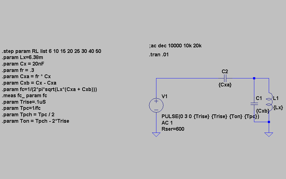

                      • Coil resistance at resonance
                        Conclusions:

                        Still studying this series/parallel circuit for use as coil driver. Some of my previous comments were over-simplified in terms of best ratio of Cxa to Cxb. It is a trade-off involving the battery current and the coil current, and depends a lot on the internal resistance of the power supply (battery).
                        Anyway, I said what the heck, I like the series/parallel circuit, so I thought I'd breadboard one and see how it compares to the spice simulation.
                        I'm driving it with my signal generator using a square wave from zero to 3 volts at the resonant frequency (I can tune for max coil voltage). My signal generator has internal resistance of 600 ohms.
                        For my "production circuit", I drive a "push-pull" transistor pair connected to a 3 volt battery supply and drive the resonant circuit with that. A LTSpice circuit is shown.
                        As an independent test, I drove the resonant circuit directly from my signal generator, to estimate the coil resistance at resonance. A second LTSpice circuit is shown representing that (no transistors).
                        Findings:
                        I found the real-world coil voltage is a lot less than the simulated voltage (see photo). I used a very low-resistance coil (24 awg wire), about 6 to 7 ohms, with 5.9 mH inductance.
                        Simulated: 45 V pp.
                        Real World: 13 V pp.
                        I'm wondering why the results were so different. So I speculated that maybe the coil resistance at resonant frequency is significantly more than the DC resistance. To test this, I ran separate simulations with a simpler circuit (no transistors), increasing the coil resistance in steps, then see when the coil voltage matches my real-world results (also without transistors).
                        With a 7.6 ohm coil, my simulation indicates the coil acts like it has about 27 ohms resistance at resonance.
                        With a 25 ohm coil, my simulation indicates it acts like it has about 42 ohms at resonance.
                        Basically this "sucks" because it means that you can't get as much coil current as you would like by using a low resistance coil and this driver circuit. The simulations looked exciting -- using the full driver (push-pull transistors), they implied you could get about 45 V pp from a 3 volt square wave, where I actually get about 13 V pp.
                        That doesn't mean it is a worthless circuit, but not as exciting as we'd like. Of course you can use the usual methods to increase current, such as a higher voltage source.
                        But I'll keep checking in case there is something I'm doing wrong with the breadboard circuits.
                        Does anyone know theory why the coil resistance at resonance is 400% more than the DC value?
                        -SB
                        PS. I did a lousy job labeling the signal graphs. The top trace, V(n006), is measured at the transistor collectors. The bottom trace, V(n008 ), is the coil voltage (non-grounded terminal). The simulation and the oscilloscope photo show the same signals.
                          As mentioned in previous post, my 7 ohm coil seems to act like a 27 ohm coil at resonance (about 13 Khz).
                          Where does the extra resistance come from? Is it radiative losses? Is it "skin effect"? Seems much more than I expected.
                          Does anyone have data on coil resistance at different frequencies?
                          -SB

                            I tried an experiment which may have been foolish, comments welcome.
                            I wanted to test if the "skin effect" is causing coils to exhibit higher resistance (lower Q) at resonant frequency than predicted by the DC resistance -- something that should be improved by using "Litz" wire, theoretically.
                            I don't have Litz wire, so my (quick & dirty) experiment was this:
                            I stacked 4 coils in parallel, as close as possible. Each coil had about 25 ohm resistance and about 6.5 mH inductance.
                            The combined stacked coils, connected in parallel as a single coil, measured approx 6.9 ohms resistance and 4.46 mH inductance.
                            I then put the stacked coils into a resonant circuit (about 16.7 kHz) and compared the actual coil voltage with an LTSpice simulation. (The simulation used 6.9 ohms for the coil resistance and 4.46 mH for the inductance.)
                            I expected the combined coils would act more like Litz wire, since each coil has thin wire and less skin effect.
                            I was wrong. The results were just the opposite.
                            The combined coils showed an even less-than-expected voltage that was consistent with an even higher-than-expected resistance of about 90 ohms instead of 6.9 ohms. That is 1300% higher resistance than the DC resistance.
                            This is a worse agreement than for the single 7.6 ohm coil using 24 AWG wire, which acted like about 27 ohms (355% higher than DC resistance).
                            Conclusion: my stacked coils did not achieve a "Litz wire" effect.
                            It is also possible that something else is causing the lower-than-expected Q at resonance than skin effect, such as radiation, vibrational modes, maybe even bad capacitors in the resonant circuit, etc.
                            Whatever is going on is having a huge effect on the predicted Q of the coils, causing much lower Q than expected.
                            I'd like to learn more about making the highest Q coil possible; how to do it, what are the limiting factors.
                            -SB

                              Would you please explain how your measure statement works? The LTspice 'Help' description is long and involved.
                              How exactly did you determine your coil resistance being high?
                              There are a few other things about your simulations that are not exactly obvious, but that will do for now.
                                Basically I just built the circuit (see below) and compared it with the simulation, using a 3.0 V pp sine wave voltage source with 600 ohm internal resistance.
                                The data depends on the coil I'm testing.
                                For example, with 7.3 ohm, 7.45 mH coil, with resonance about 13 kHz, the coil voltage is predicted by simulation to be: 18 V pp.
                                My actual circuit only has about 7.5 V pp.
                                I thought it would be interesting to see what coil resistance would make the same 7.5 volts in the simulation.
                                So, in the simulation, I vary the coil resistance until the coil voltage matches the actual circuit, 7.5 V pp. The resistance necessary was about 93 ohms.
                                So although the coil DC resistance is 7.3 ohms, at resonance, it acts as if the resistance is 93 ohms.
