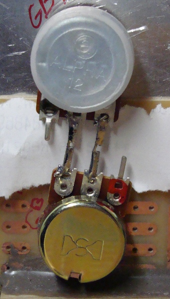

I changed out the single turn GEB for a combination ten turn front panel control in series with an internal trimmer which is a PCB style ten turn pot. I do not have a ten turn 100K pot so I used a 20K ten turn in series with a 100K ten turn trimmer pot. This probably gives more resolution for setting ground balance than is really needed but now I can really see the changes almost every time I null it too my piece of ferrite when I move to another location.
I calibrated this by setting the front panel at mid rotation which is five turns from either extreme and then adjusting the internal trimmer so there is 50K between U-102 pin 6 and ground. This gives +- 10K of adjustment with the front panel GEB control.

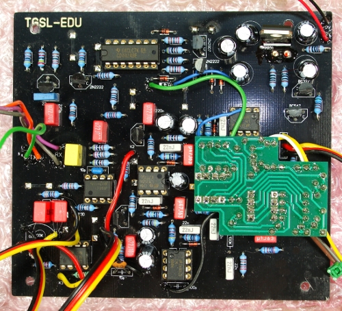

My Progress with the TGSL
Been awhile since I had some time to play with my TGSL-EDU detector build.........

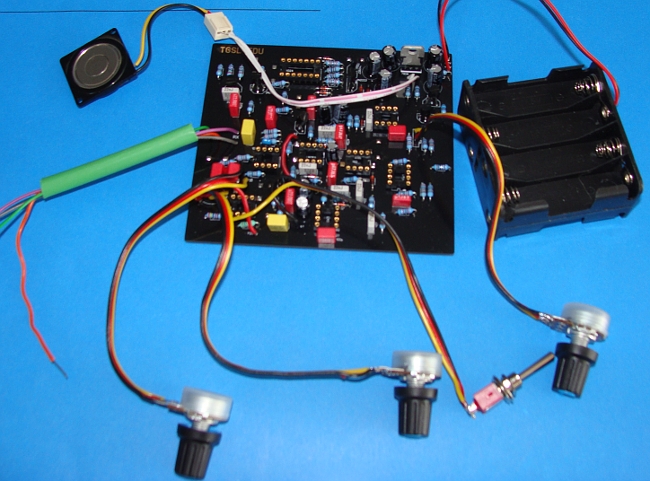

The 2 tone PCB mod came in several months back and I assembled most of it, as always there was one part I didn't have on hand. Only place I could find it was in the UK, so I ordered several. Over the past few weeks worked on this machine on and off after finally getting settled from a move.

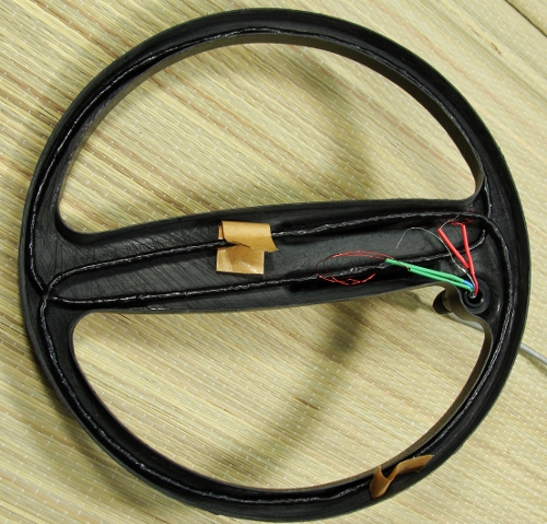

Pre-assembled the 9.5" DD search coil which is ready for tuning once I have the PCB with the mod up and running. The coil now set aside, concentrated on the control box.

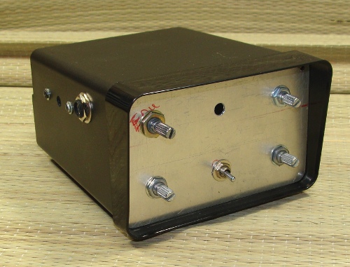

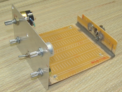

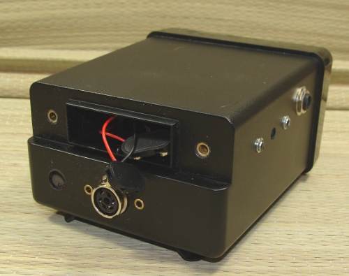

Decided to use one of the empty Fisher CZ6 boxes, built a slide in cassette that hold the faceplate, PCB and search coil jack. Slides right into the control box. Two screws thru the faceplate and two screws from the back of the box into the search coil plug upright hold it in place. Headphone jack placed on the side as well as a small piezo buzzer for a speaker that emits target sounds thru a 5/16" hole. Power will be two 9 volt batteries for the time being. As always, just waiting for a part, a toggle switch. Decided to add a two stage ground balance control, one pot for coarse-initial tune and a second pot for fine tune-----100K and a 10K pot.
Its looking smart well done'
If it was me and my first TGSL build , would have got it up and running before doing any mods because if you have a problem with it working its one less thing to have to consider when fault/finding.
Saying that, we all have are own ways of doing things.
All the best my friend
Hi,Originally posted by satdaveuk View PostIts looking smart well done'
It already was debugged, up and running before the mod, just never got around to completing, making a control box and coil for it. Got side tracked building my PI's.
I had 4 Fisher CZ6 boxes I made up the same way at the same time to use on four builds if needed.
Keeping my fingers crossed it powers up and works after the mod.....LOL
Will let you guys know.........
