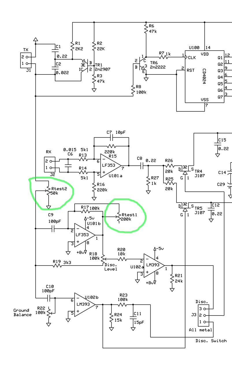

2. Also dual trace picture of LF353 pin 7 (RX signal) one trace with TX oscillator other trace?
3. Please describe oscilloscope grid scale for each trace, time and voltage.
4. What is your TX oscillator voltage (J1-pin1) peak-to-peak voltage?
5. What are voltages on .22uF caps C12 and C15?
6. Look at JFet driver pulses (output of LM393 U102, pins 1 and 7) for discrimination and ground channel while moving pots. Do the pulses stay square, or do they break up into smaller pulses?
7. What are RX and TX coil inductance and resistance?
8. What is TX oscillator frequency?
9. Is it unstable outdoors?
