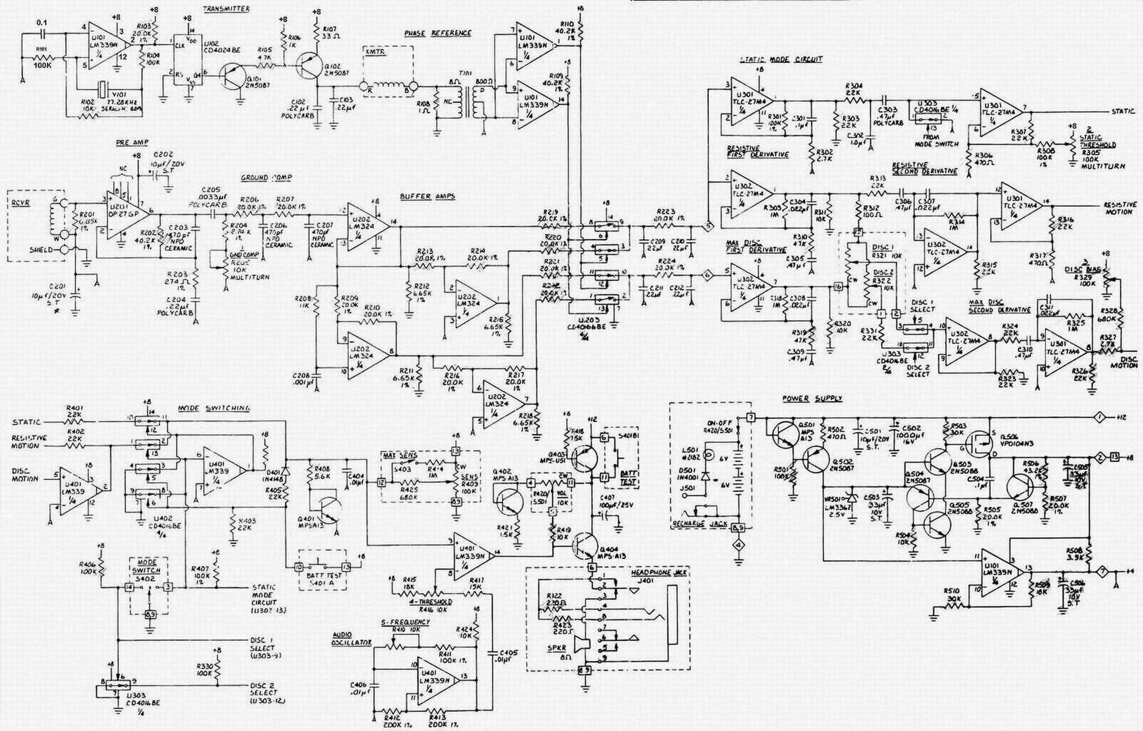

    1265
    Would you please post the 1265 shematic here?

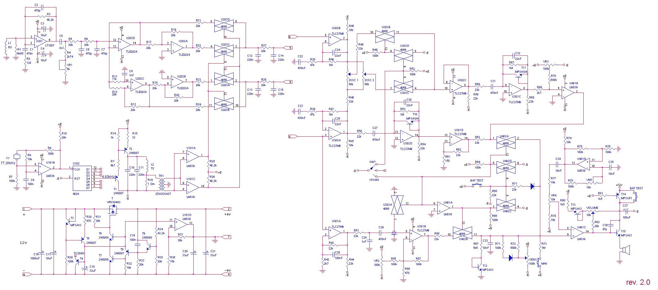

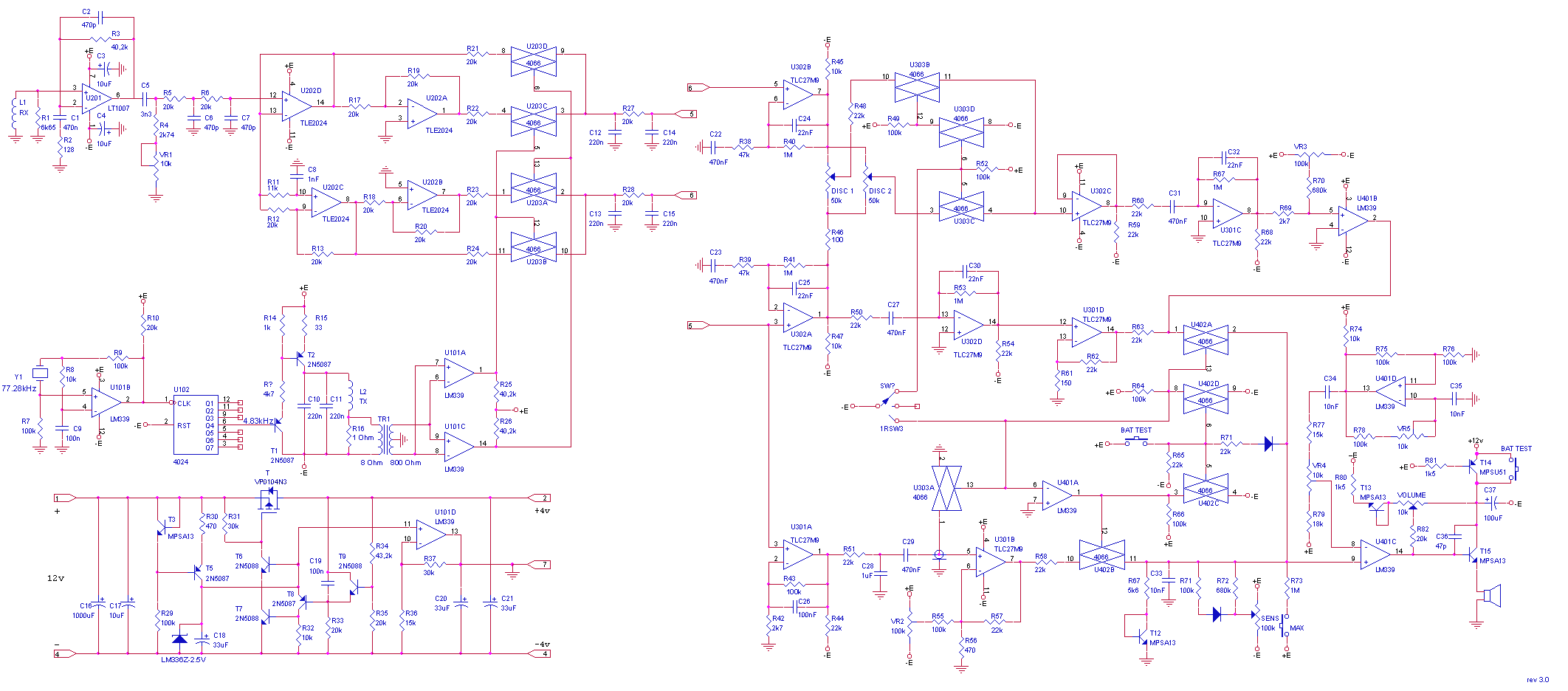

            1266
            fixed 'bulgarian' 1266 schematic. delete old revision one in your archives. i hope now it is correct. enjoy
            • #66
              oops! noted mistakes. revised again.
              • #67
                Can you tell me, please?
                What is the 4066 symbol represent and what does the device do(how does it act in the circuit)
                Thanks...
                • #68
                  Thanks...
                  The 4066 is a quad analog switch. In one part of the circuit it is used to sample the in-phase and quadrature portions of the received signal. Elsewhere it is simply used as a multiplexer.
                  • #69
                    as I understand it--
                    it samples in phase and 90 degrees out of phase received signals
                    and other places it combines different signals into one.?
                    One thing for sure, I clearly do not understand how this circuit works.
                    Is there any documentation which explains the circuit function or do you have the experience which enables you to understand the circuitry by examining it?
                    • #70
                      I do not know of any documentation that explains the operation of this circuit, but by examination of this design, I can determine that it uses a classic approach of sampling at the zero-crossing point of the received signal to achieve ground exclusion, and then 90 degrees later (adjustable by the two DISC pots) to perform target discrimination. Other analog switches are used to switch in or out certain sections of circuitry related to discrimination or battery check.
