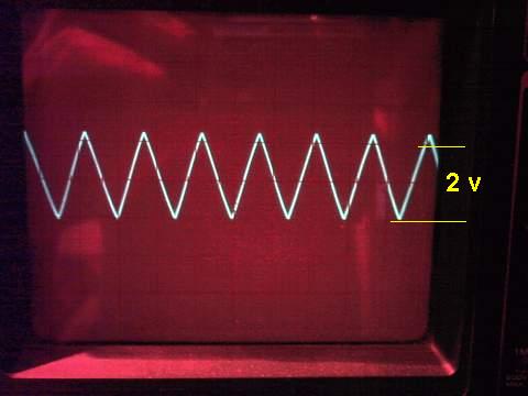

    What a coincidence!? Few days ago i got one 1265 on service. In working condition but "depth" is so low. Bairly detect 1e coin at 15cm. Disc works good, audio good, all the pots&switches are good...coil and cable in excellent shape so as jacks.
    So i opened it and tried to adjust trimmers inside.No results...
    Voltages are proper, TX is ok...at RX i get right signal and shape??
    What the heck is this?
    So i started to suspect some of capacitors. Damn, lot of job to check them all.... I dont have proper voltages and levels on paper to compare with this device....so i could easilly locate bad component.
    I can gain some more sense with thresh trimmer but than it starts to be much sensitive on hot rock and ferrite rod.
    What is different here than at TGS is quite different Disc stage. Very interesting to compare with TGS.
    In case you have some measurements (test points), voltages and oscillograms from accurate 1265 than please post those here, would help me much!

      What is the level of your TX at the collector of Q102? What coil are you using, the 8.5"? This thing seems pretty responsive (from the changes that I see on scope) but will not know for sure until I get the potentiometers in. It would be nice if someone had the alignment procedures for the static threshold, disc bias, and threshold.
            J. L. King
            Now when you mentioned it...; sheeesh!!! I didnt expected such low power there!!?!?! Bairly over 2vpp !?!?
            Is it normal?
            I am using approx. 20cm diamm. coil (closed enclosure) with it.
            I checked transistors and resistors there..seems to be ok. But wait!
            Somebody previously changed transistors...not 2N5087 anymore? Now those are BC307 !?!?
            Ha,ha,ha...you helped me with your question! I think i solved my problem...

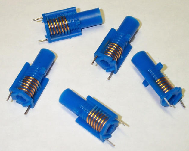

                BTW: Any suggestions where I might obtain a ferrite pot for testing?

                  I think you are in the right area of your problem. I went back and measured Q102 Collector voltage accuratly. I have 15.2 Vpp!
                  Attached is a zip containing pictures of TX signal:
                  I have included 2 pictures of Q102 Collector signal: 2V/div-50usec/div & 2V/div-100usec/div.
                  I have also included picture of Q102 Base signal: 0.2V/div-50usec/div
                    J. L. King
                    I use a ferrite tuning slug from a tuned coil, similar to one of these:
                    Just remove the core and throw the rest away.

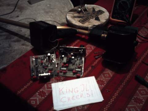

                        Disc1 & Disc2 potentiometer check
                        Ivconic,
                        Could I impose on you to check the Disc1 and Disk2 potentiometers. Mine have bad spots on them, but I want to verify their taper. Mine act like they are logritmic (audio) taper (at 12 o'clock position I measure ~1k pins 1 & 2, ~4K pins 2 & 3). Also mine measure 5K from end to end, not 10K as specified in schematic.
                        Thanks in advance.
                        J. L. King
                          Ivconic,
                          Thanks in advance.
                          J. L. King
                          Of course you can!
                          Give me half an hour to do that. Have to go to my workshop and do that.
                          Be here in ...let's say one hour..
                            So... Disc1 and Disc2 pots at this 1265x are the same; 8.9k linear...!?
                            I guess those were 10K and lost some of preferences during time and various objective working conditions like moisture etc...
                            But those are identical on measurements ; 8.9k ...??? Strange?
                            Oh yes; i had to unsolder wires cose when wired up those gave values 3.8K each... end to end.
                            Reffering my problem; i havent solved it yet. 2N5087 are put on places and still TX amp is bairly over 2vpp!? 1ohm resistor in serie with coil is ok. Everything else is ok..??? Could it be coil? I dont have right now another to check...damn!
                            What bugs me mostly is shape of signal - saw??? The heck!

                            Sorry i am late. Took me more...had some troubles..
                              Thanks. That clears up that little discrepancy. It is strange though, both my Disc1 and Disc2 measure 5K and both show logrithmic taper. I will replace with 10K linear.
                              Thanks again.
                              Cheers!
                              In some of my modeling I have encountered that saw shape. It could be coil. It is showing integration of square wave. What was the frequency of the saw waveform? I just went over to LTspice and fed a 1265 Tx circuit with 6.5KHz squarewave. Got a 2Vpp 6.5KHz saw waveform! 8KHz gives extremely sharp saw waveform of 1.5Vpp. I think your TX is wrong frequency or coil is for a 2KHz 12xx.
                              Dissconnect coil and check the feed to the 4025 (actually check LM339 U101 pin 2. It should be ~77KHz square wave. If it is not, check out U101 (and be sure that you are not getting feedthrough of another section of U101; I was getting feedthrough from pin2 to pin 1 and vise-versa). Also check that the output of U102 (4025) is divide by 16 (4.8KHz).
                              P.S.
                              I thought you did extremely well. Especially since you went out of your way to do this for me.
