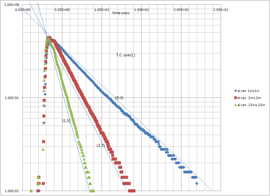

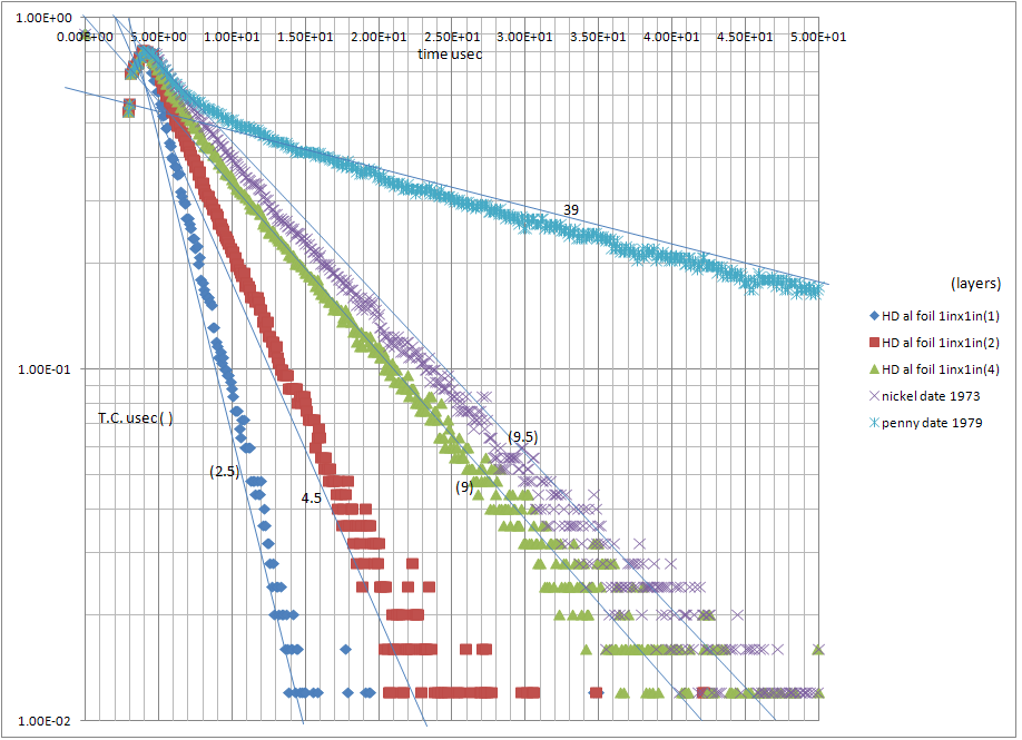

                      Aluminum can results. I've seen T.C. for coins different than what I get. Including a plot with a nickel, penny and another run with the HD aluminum foil. The aluminum foil T.C. are a little different do to the way I drew the slope before. I think these are more correct. Don't know why my coin T.C. are different than what I've seen in other posts. Maybe I need to change my test procedure.

                        Thanks Green, for your work here. This is very interesting to me. As expected the 1 x 1 can material is right at twice the T/C of the 1 x 1 foil I believe due to being twice as thick. It is also interesting how the shape difference of the .5 x .5 vs the 1 x .25 foil samples shows the long narrow one to be about 62% of the square shape T/C even though they are both 1/4 sq. in.
                        Looks like the 1 x 1 can material is a pretty good 5 us standard and the 1 x 1 HD foil is 2.5 us. Good work!
                        Thanks again
                        Dan

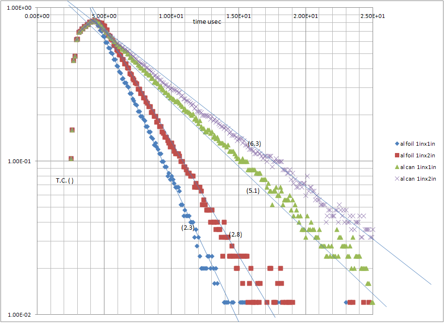

                          I just remembered when I plotted the HD foil the last time the 1inx1in plotted the same slope as the 1inx2in. I tried again to see if area made a difference with 1inx1in and 1inx2in. Don't know if I mixed recordings last time or if I'm doing something different. Should area make any T.C. difference?
                          • #43
                            According to Carl's post there is a slight effect from area, but mostly T/C is affected by thickness.
                            Dan

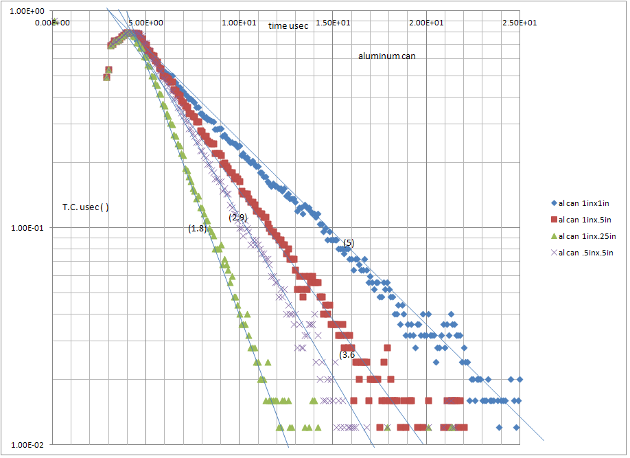

                              Apparently exaggerated/increased length does have a significant impact on on T/C as evidenced by the square VS rectangular 1/4 square inch samples. The 'shape effect' in this case results in the long skinny one having a T/C 38% less than the square one of equal thickness and area, if the test is repeatable. It looks like we should stick with the square shape and stated material thickness for our T/C standards.
                              Dan

                                I repeated the test. Cut some new targets. Different amplifier. Different coil (5 in round DD). Held target over one of the coils not in the center as before. About the same results as before.
